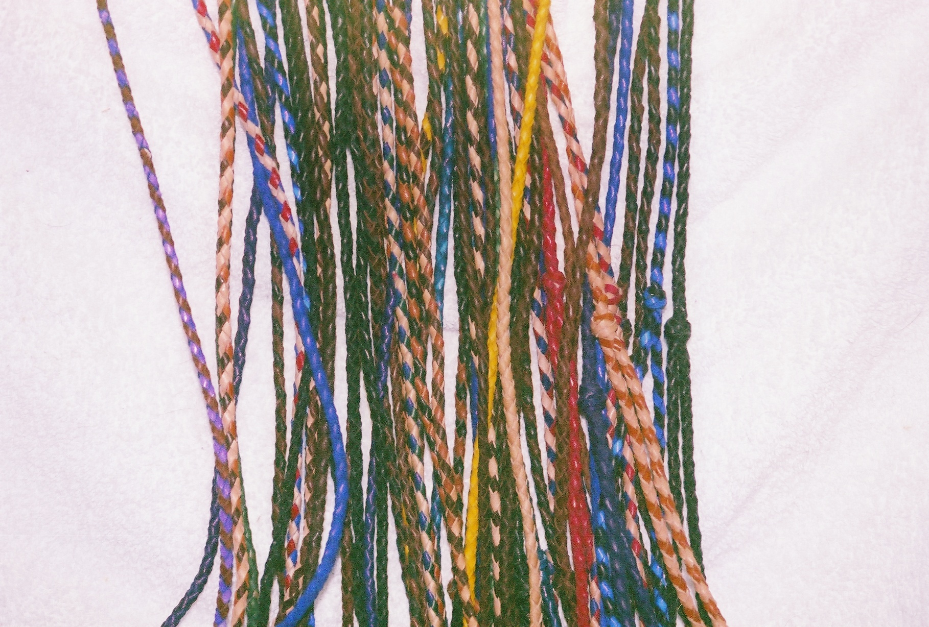

well the rein knots dont really end up all that large....if you look at the picture you can see a couple of rein knots on the right side...
