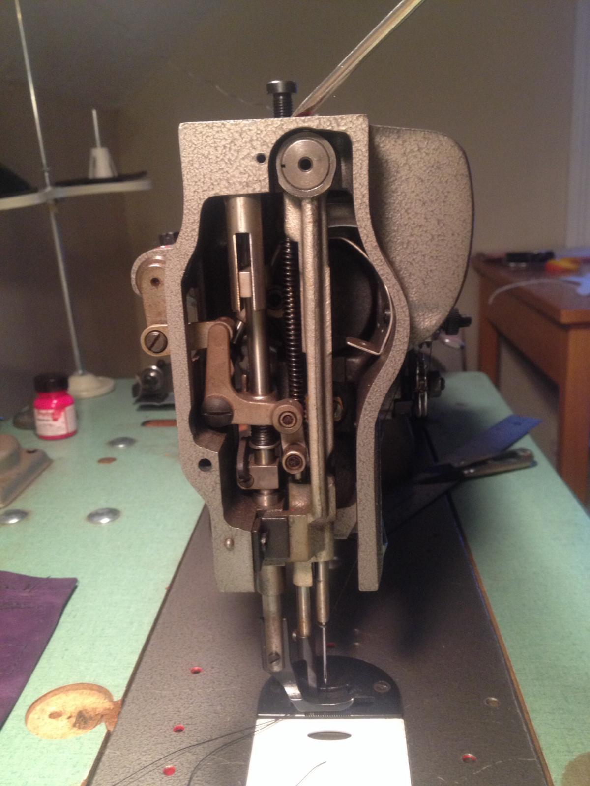

I'm pretty new to sewing. I have a consew 206RB in very good shape. The main purpose for me getting into the field is for shoe making. Before anybody goes there, I am aware that a post roller foot is the best machine for such work, but I didn't have post bed money. I bought a good machine that I could afford. I also plan to venture to other things which will require a flat bed. Anyways, the foot marks my leather. I have already read the manual and loosened the screw at the very top to relieve some pressure, which did help. But I was told that there is a screw to loosen for the outer foot and inner foot, and since I'm a rookie I really don't know which one I loosened. It's the inner or "walking foot" that leaves marks, they can easily be rubbed out of suede, but not leather. Anybody have some suggestions?? Even on tools that can rub marks out? Also, if you're interested in this machine shoot me a pm. If I can't figure out how to get this to stop marking my leather I MAY be looking to sell it to buy a machine that can. Located in Ohio. Thanks!!

Thank god I found this thread. I too have a Consew 206 rb and the foot leaves marks on my leather. I can rub it out of the suede, but I can't get it out of the leather. I know some flat beds (like the older singers) can have a roller foot installed, but I have since learned this isn't one of them. About a week ago I went through an online manual and called myself doing exactly as wiz said and attempting to remove some of the pressure on the foot. I'm only assuming that I did the right thing, as I noticed lifting my pressure foot did become a little easier than before, but alas, still making marks. I will be using a mix of garment leathers and leathers up to about 6oz... Right now I'm working on a project that is about a 1 oz veg tan... Can anybody post a photo of what screw I should be loosening so I know I'm doing it right? I'm currently at work, but I can post photos of what I did unscrew when I get home as well! Greg I actually called there like 20 mins ago and spoke to a nice lady, she said you guys had feet online so I went to look. I saw a foot listed as a flat presser foot 19412C, will that foot help alleviate the issues I'm having with my current foot?? Thanks!!
