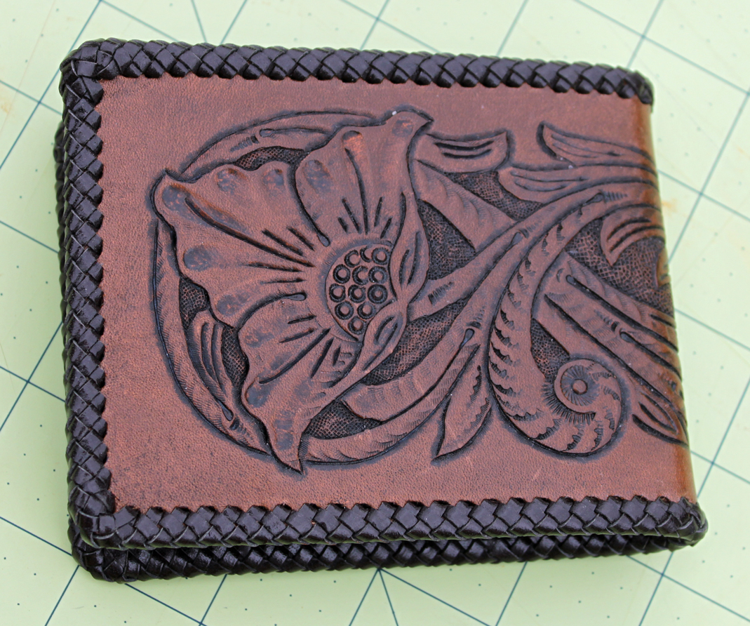

Wallet
Chief31794 replied to Chief31794's topic in Purses, Wallets, Belts and Miscellaneous Pocket Items
Thanks Wild Bill, Chief -
I believe what you are asking about is "keyholes", Tandy and others sell keyhole punches, but they are not necessary, I make my own keyholes by punching the correct size hole, then slitting from the hole and terminating the slit with a very small punched hole to act as a "Stop" to prevent the leather from tearing. Hope that helps, Chief

Wallet
Thanks Papaw, Chief -

Wallet
Thanks for the kind words. I'm glad they helped you. I think that lacing has lost a lot of its popularity. When I started working in leather in the late 60's early 70's, lacing was very popular as well as carvings. It seems that tastes have changed and people like more of the elegant plain look with good looking stitching. I seem to get orders for more items like that than the hand carved, laced items. There are a few exceptions, but I think stitching is much more popular than lacing (talking about the looks), however, many times tastes change and old styles come back. Too bad I'm too old to wait for them to come back around again. Thanks, Chief -
Wallet
Thank you, I didn't know anyone was still watching those videos I did on Youtube. I hope they helped, wish the video was a little better produced, I did them in my shop with a single camera. I got a lot of criticism about having my arms in the pictures and stuff like that, some people say they helped. Thanks for commenting. Chief -

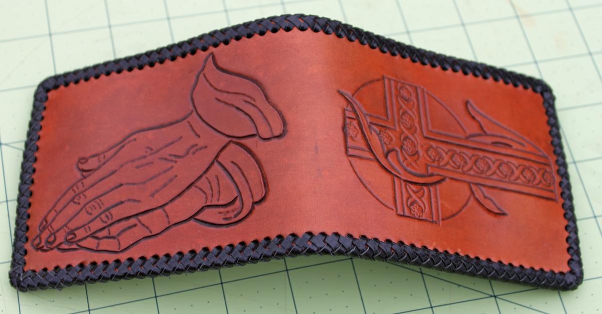

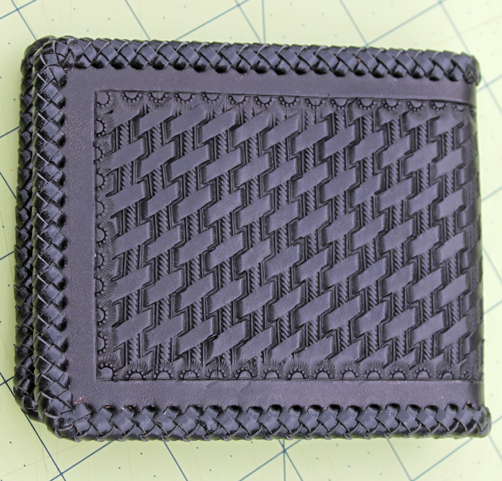

Wallet
Some are done with Double Loop (Traditional), the ones you are probably talking about are a stitch called "Mexican Basket Weave" or "Round Braid". It is a simple stitch, uses about the same amount of lace, covers better and is stronger because each hole has the lace passed through it two times (3/4/3) on the corners. Thanks, Chief -
