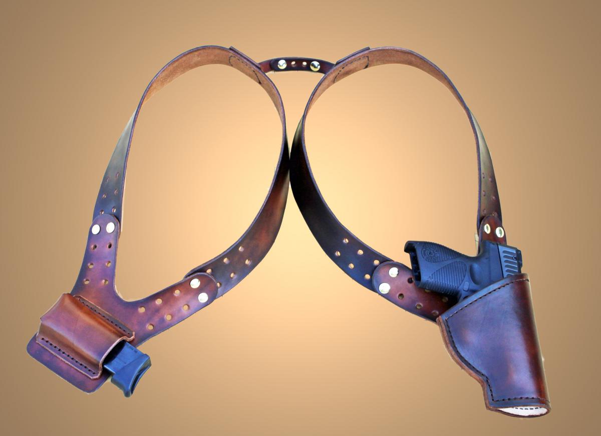

Hadn't seen too many of these out here. Had people around here interested (not many), so I put one together without much fuss just to see how they would look. I learned a few things about shoulder holsters. Hope these don't make much of a comeback. Chief

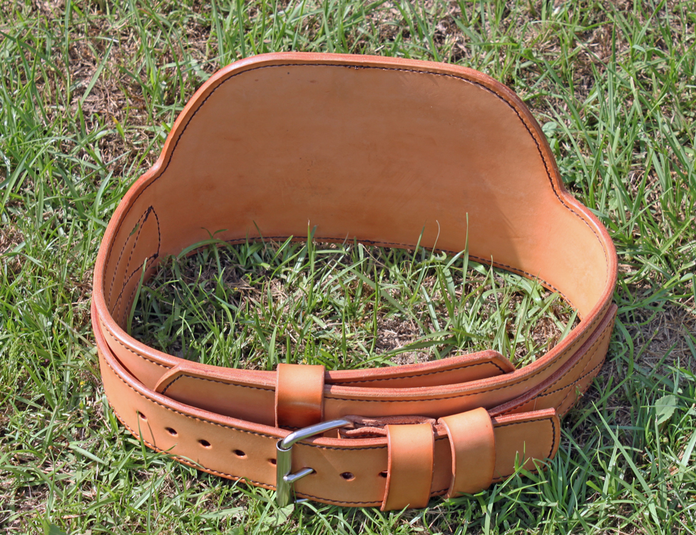

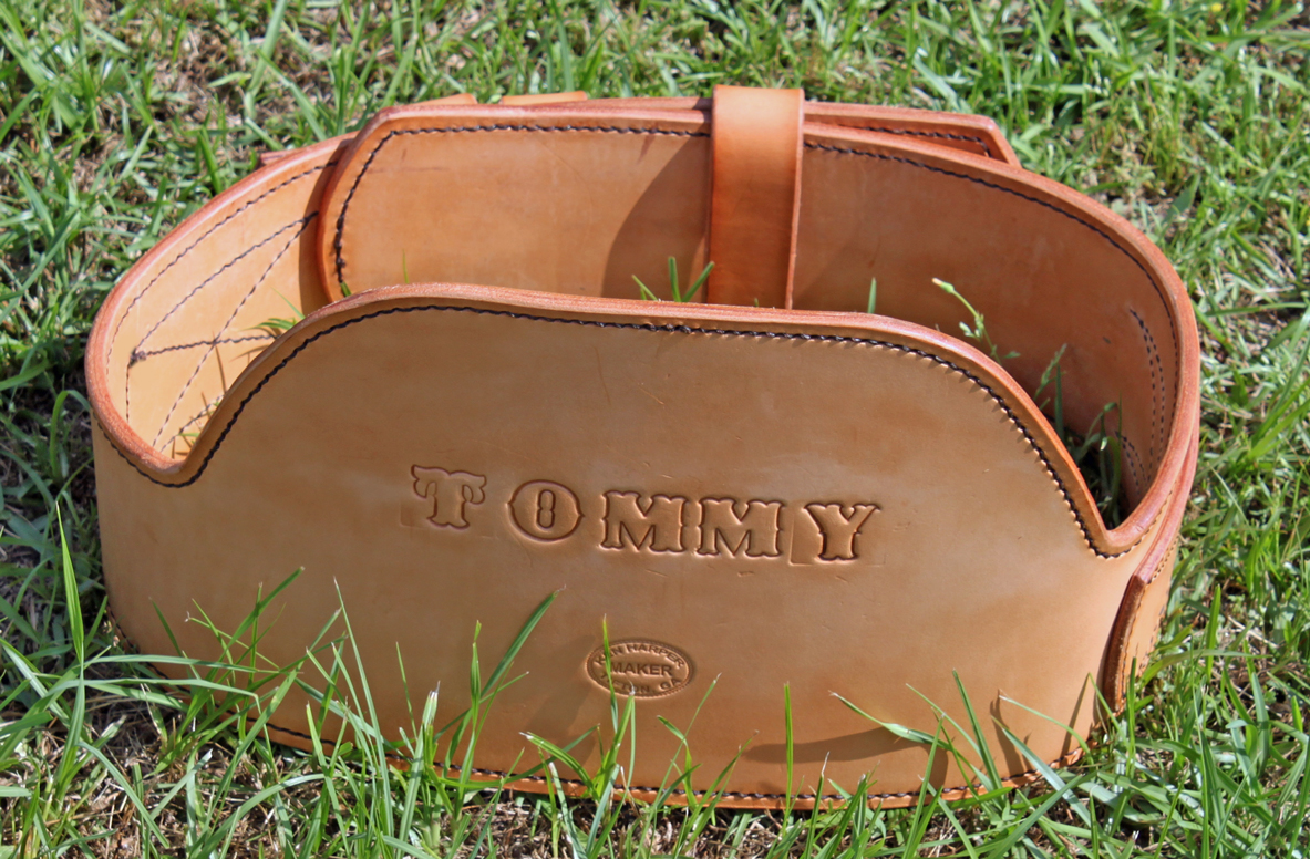

it's a little over 5/16" thick, then the buckle strap is ~1/4", I used 9/10 oz Hermann Oak and laminated it flesh side to flesh side on the main belt and the strap is 8/9 oz 2-1/2" with a 2/3 oz liner. The main strap is ~48" long and the main strap is 4" wide while the lumbar support is 8" wide, the buckle and tongue straps are 2-1/2" wide. The center hole is set at 39" which was the customer's measurement for the belt so he can go up or down ~4". The thing ways over 6 lbs. Chief
