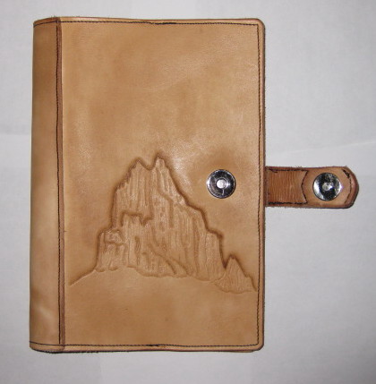

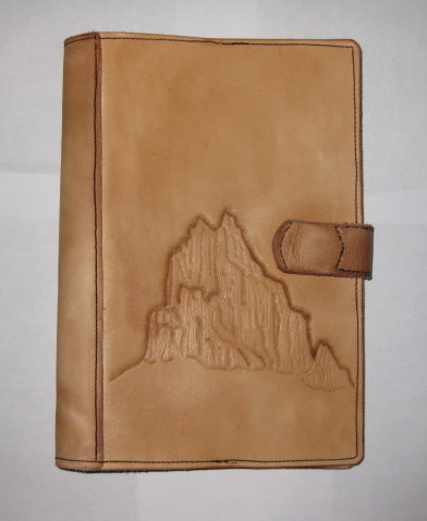

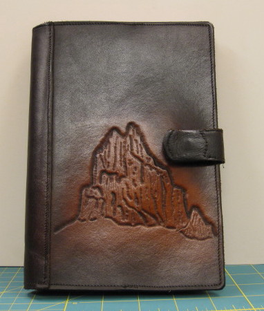

Just finished this day planner to be donated at work for a raffle to help out a co-worker in troubled times. As usual my pic's aren't very good. There's some problems with the stitching but not as noticeable after the dark dye is applied. the image is of Shiprock, which is an old volcano on the Navajo reservation here in NM close to where I am currently working. Thanks for looking Scott

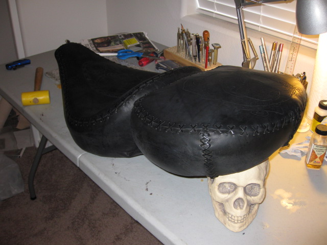

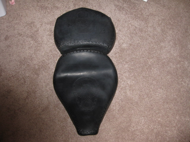

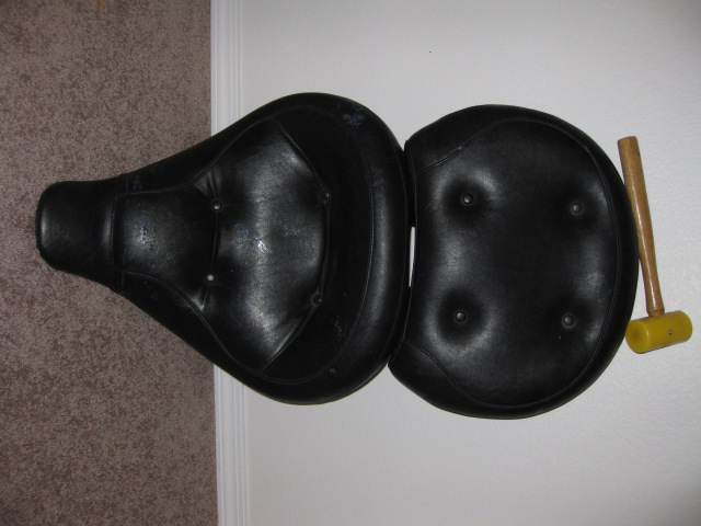

Ok so it's finished and was a real pain in the A*& it wouldn't have been so bad had the driver seat and passenger seat been two separate pans. Thanks again for all the advice given. I trimmed the foam down on the driver's seat. I stained it with vinagaroon. it is actually a nice deep black the pics aren't very good. The artwork for the seat was the owners tattoo, which I thought fit better on the passenger seat, so for the driver's seat I put a timing chain and gear. I thought it would go well with the gear thru the skull and the owner is a mechanic. critique is welcome. I've added the before picture. Also for some reason I could not get the wrinkles on the pass seat out even after letting it dry and restretching. Only way was to trim some leather out and lace it. Just seemed like it was to round and was nowhere to pull the extra leather to. Scott -

AZRider, here's my 2 cents. I use cool water to soak the sides. If I remember correctly hot water can cause the leather to harden taking away some of it's flexability when dry. I also ONLY wet the sides the top doesn't need it and can make your top vulnerable to scratches, marks etc... I personally don't use glue. Some do, some don't. Before I put the cover on I mark the center of the seat front and back, then I mark the center of the leather top center front and back. It just gives me some reference marks to line up with. The back and front of the seat are the hardest to put on. If you can't get all the wrinkles out let it dry and go back the next day after the leather has "set" to it s new shape. The remaining wrinkles will be easier to remove. Scott

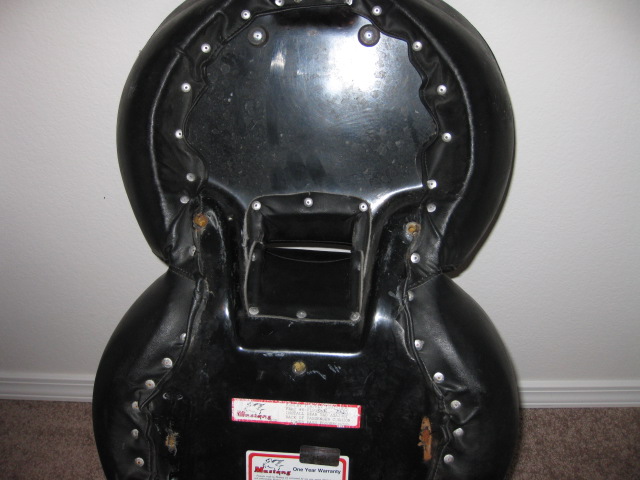

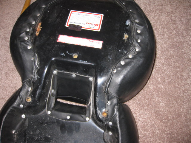

here's the pics of the bottom of the seat. I am palnning on tooling a top for it. It's supposed to be his tattoo. I was asked to do it all black but also said to do what looks best. the bike will be flat silver. I'm try to get a light grey by thinning some fiebings black to use for the anchor and gear. maybe a cordovan for the life ring. Any suggestions would be helpful and greatly appreciated. Scott -

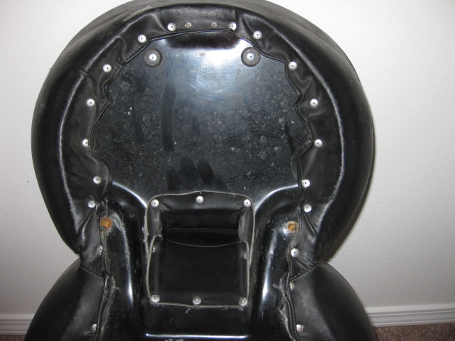

Ok I just got another seat to recover. I didn't know all the specifics on the seat I had been thinking it was a solo seat. Its for a military guy in Iraq. His buddies are fixing up his bike for a surprise when he returns (my brother being one of the buddies). This seat is a Mustang for a full dresser and the pan is metal and seat and passenger seat are all one big pan. not able to separate them for covering. Has anyone ever done a seat like this? I need to somehow get the new cover down in between the seats. Thanks in advance. P.S. anyone have an entire elephant hide? I'm gonna need it to cover this monstrosity Scott

Here's my 2 cents. John and Randy have already said about everything. You should go to the motorcycle section here for research. There are some new tutorials just posted. WET the sides as John said. It will allow you to stretch the leather tighter and get out more wrinkles. What I do when I have a steel pan is to drill my holes the size of my rivets but on my first go around with the fitting I hold the leather on with sheet metal screws that way if I can't get out some of the wrinkles (always happens to me) I can let the leather dry and "set" then back out the screw re-wet and pull out the wrinkle. only then do I put in the rivets. Scott
