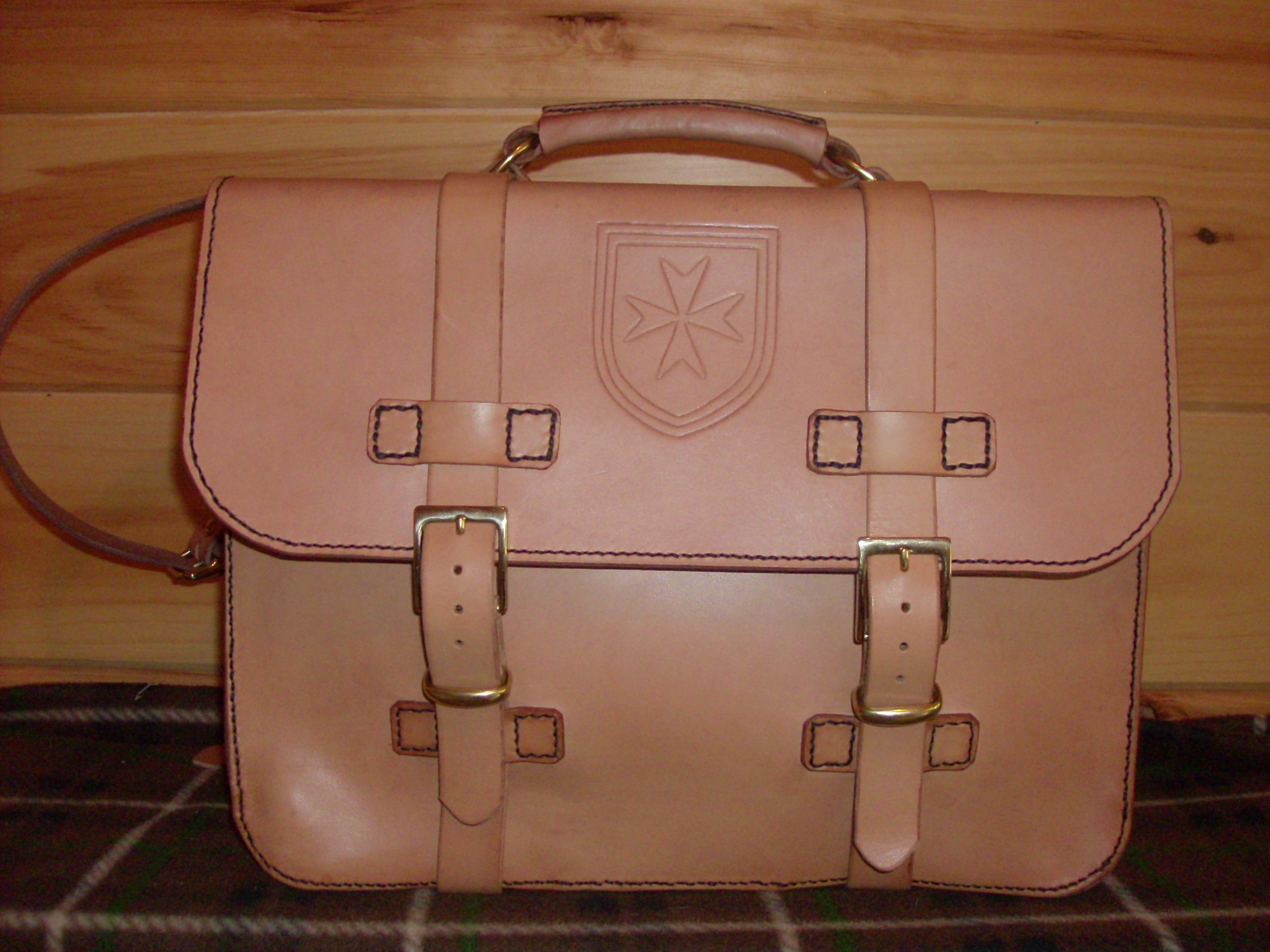

I have been working on this bag on and off for months and it's finally done. It's the first time I have tried to make one and I learned a lot. It is ALL hand stitched. 1,452 stitch holes many are triple stitched. The center is 1/2" thick where all the pieces come together (should have skived it) I will do a few things different next time. The back strap holders troubled me for awhile, since I was originally going to place them on the side but with the gusset bent in the strap would have bent the top so they look like the afterthought they are, since I had to unstitch some of the top. If anyone has some construction suggestions I'll take them. Thanks, Scott

I posted this in the "bag, briefcase" section a few days ago but I don't think that forum gets many visitors so I thought I'd try here also. As the title says any ideas how to make the top of the bag more rigid so it can be carried without the top lifting/bending. the bag is in the style of ESantoro's I can see on his he has another piece of leather on the underside stitched to the top is there anything that should go between as an added stiffener thanks Scott

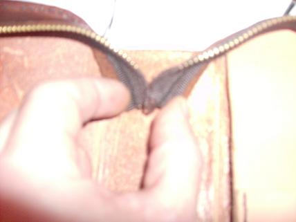

So I am trying my first zipper project. I am trying to make a briefcase with a zipper closure. I bought "the art of making leather cases vol 2" and followed the directions. Unfortunately the example they use was for a thin book, which I didn't realize would make such a difference in the zipper. My zipper seems to be to short and when fully assembled the briefcase wont be able to be fully opened. So my question is can I add some teeth to this zipper? (I really don't want to re-do it) or is there a way to move the ends closer together that I am not seeing? I also notched the case as per the instructions so it limits my ability to cheat the zipper closer. Thanks, Scott
