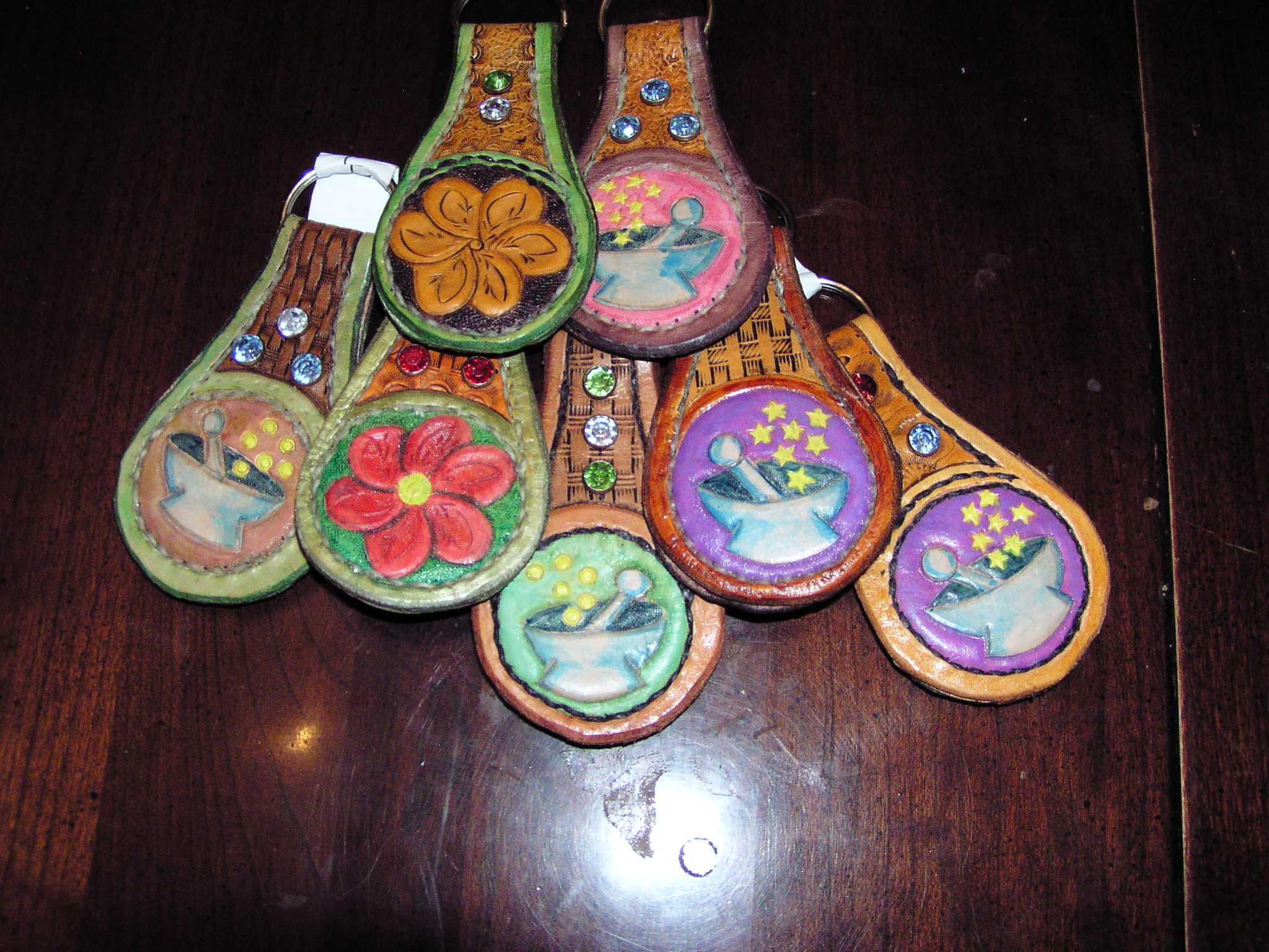

All my staff wanted a personalized key fob once they had seen one! Thanks to my friend Brian Walker of Tandy in Littleton, CO for teaching me the dry brushing technique that gives some depth to the mortar and pestle design. Dave M

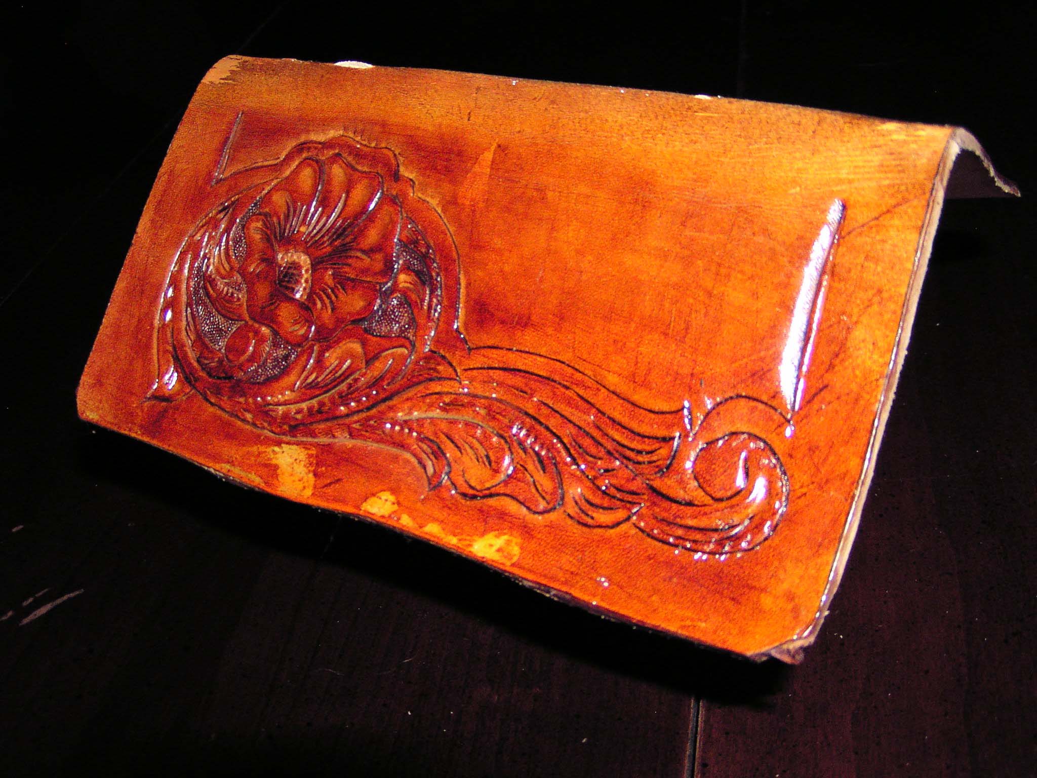

I used a "sharpie metallic silver" marker on this and gave it a coat of Neat-Lac. That was a few weeks ago and I've been using it as a coaster since then so it has had some exposure to water. It still looks the same now (for better or worse). -

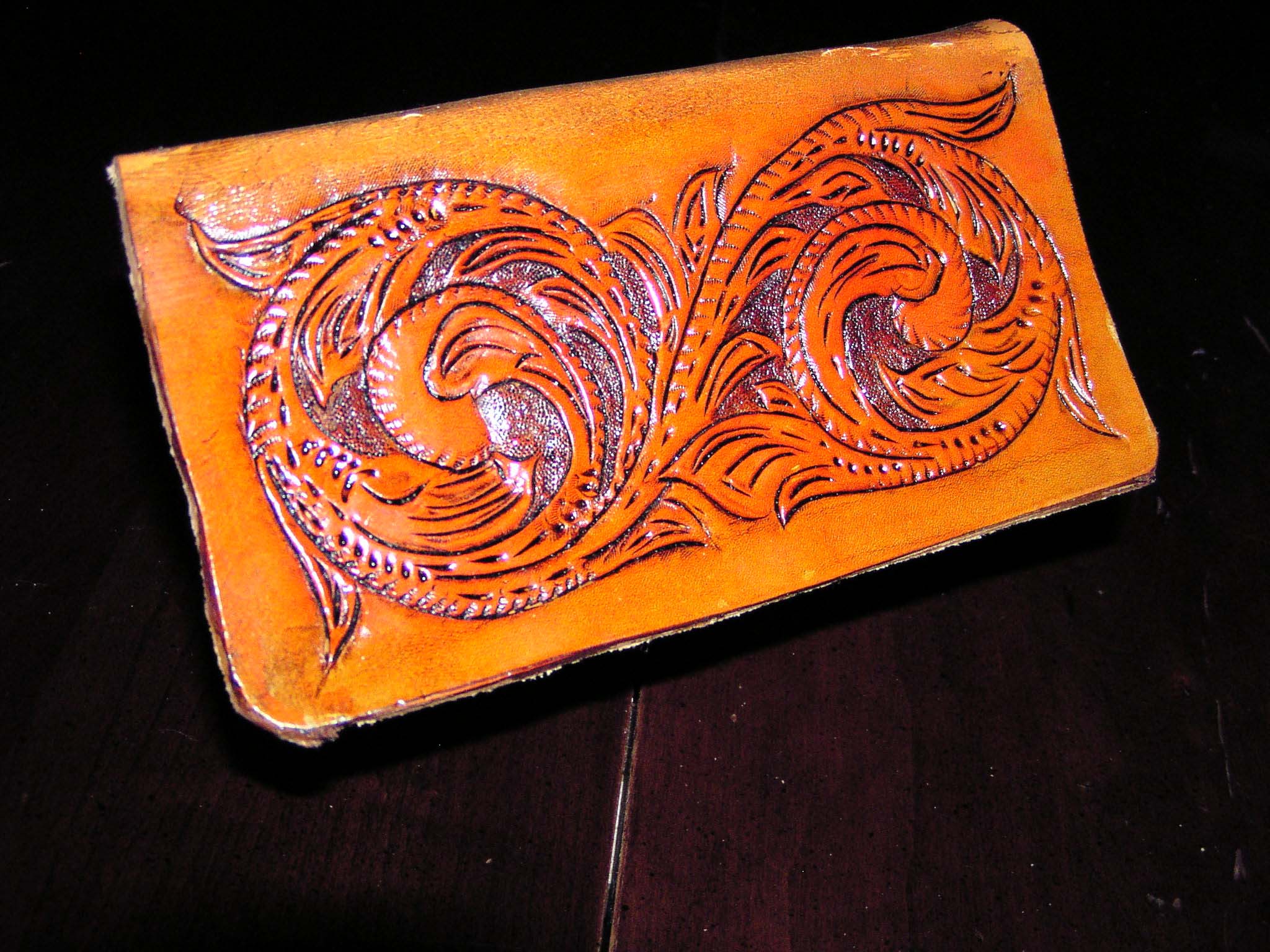

I made these on a thick chunk of scrap leather. The quality of the carving isn't consistent but there are a few areas that came out pretty well. Best though, is that I learned a lot and really enjoyed the entire process. Constructive criticism from the very talented members of this board is appreciated.
I was a pretty good hand at leatherworking in the distant past and am now starting again. However, I mostly used kits that included patterns. Now I'm looking to be a little more inventive and creative. Where does one go for ideas for new patterns? Or do you just make them yourselves? I saw patterns in the Tandy store but thought the price seemed a little exorbitant.
I was visiting my dear ol' Mom last weekend and noticed that she was still using the checkbook cover I made for her when I was in high school--back when gasoline cost 49 cents and Richard Nixon was president. It got me wondering why I gave up such a rewarding and fun hobby. It probably had something to do with lack of time due to school, work, kids, etc. So I got out my old tools and got right to work on...what else? another checkbook cover. This seems like a really nice bunch of folks. I'm looking forward to chatting with you. Dave Mumaugh
