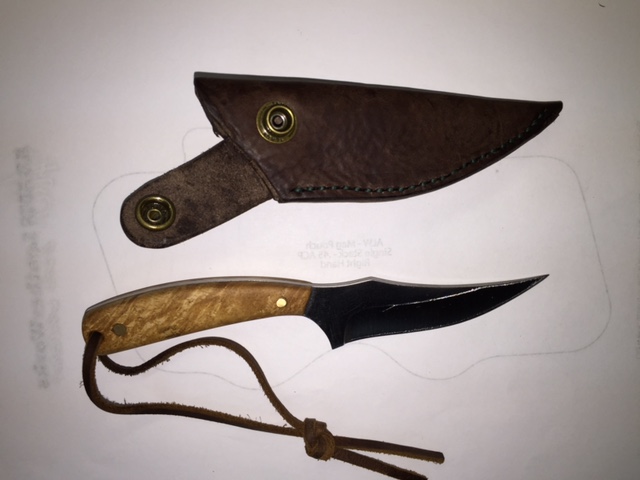

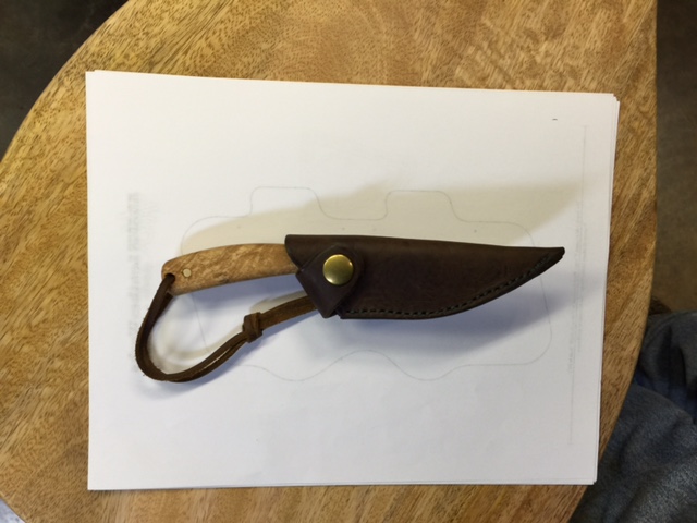

@Stu, Got a set of them, have a couple VB pricking irons too, Actually just honed and polished my narrowest set of the tandy punches so its smooth and makes smaller holes when i want to bang it through whatever im making, my biggest problem with this thing going wonky was because i was lazy to build a punching jig for this sheath or to glue the welt and stitch line, so was punching the holes on the edge of my workbench and the piece wasnt exactly flat because of the belt loop and keeper, Its a learning experience -

Kulafarmer replied to Kulafarmer's topic in Gun Holsters, Rifle Slings and Knife Sheathes
Thanks Stu,Is purely utilitarian, EDC An old timer is exactly what it was called, i like the blade style, sharp, small, for just utility or quartering game, I just wanted a basic sheath that was soft and light and would keep the knife in it no matter what i was doing, its definitely not the prettiest thing, does have a belt loop on the back, stitchings a little crooked but it aint fer looks,,,, I like the handle to ride high so when im on the tractor or in my truck its not in the way, -

Fooling around getting the feeling ,, #1 project Knife is a blank from Texas Knife, love this style, fits in your hand good for cleaning bambi!

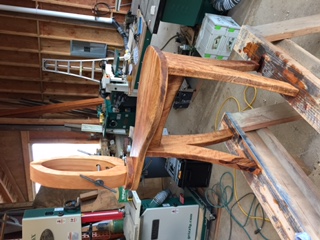

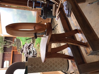

Thanks, is basic, seems to work good, just got to line the jaw with some leather, not sure if i want to use some suede or regular stuffThe seat and legs are mango, had some oddball shorts in a batch of lumber i cut for some doors and cabinets i need to build, the jaw was just cut from some scrap 4x6 doug fir i had laying around. Will cut new ones out of glued up mango when im satisfied the face angles and depth work. May make them longer, can drop something 16" wide into it as it is though
