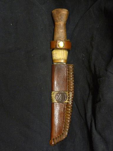

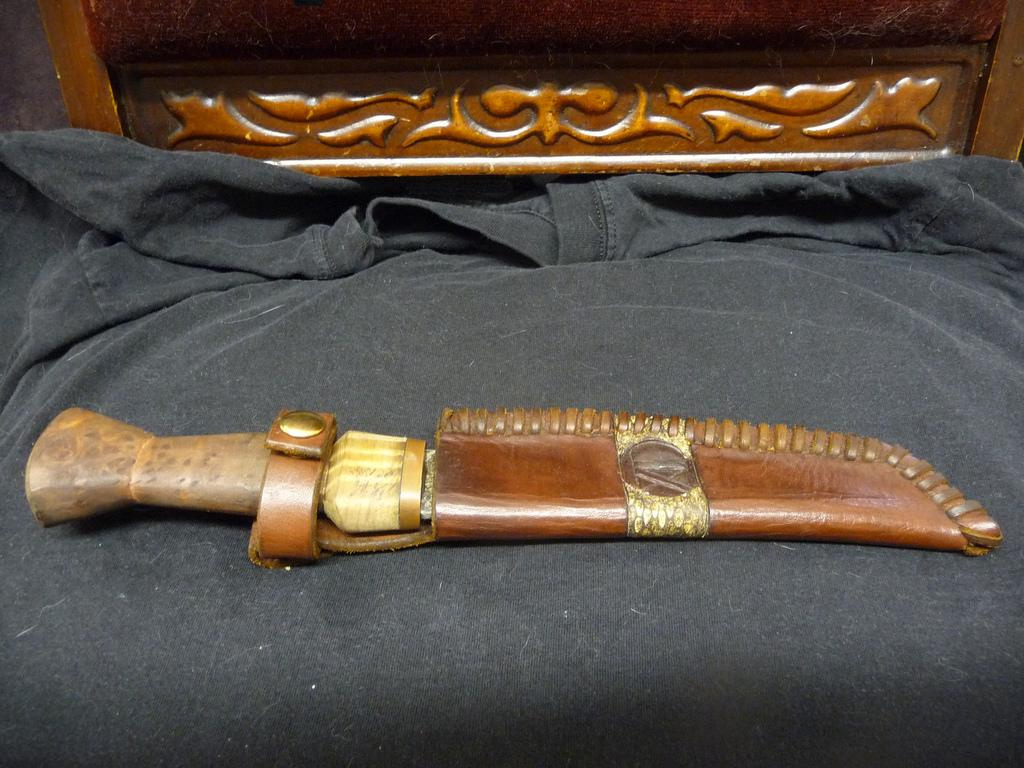

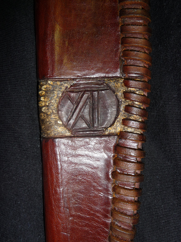

  17. "XI" Knife Sheath : This is a second photo of a custom knife sheath featuring the Roman number "11". The band is made of diamondback snake skin. The knife was made by Shane Stainton of Red Dog Forge. The colors, theme, whipstitching, & placement of the numeral were requested by the customer. Comments are Welcome!
