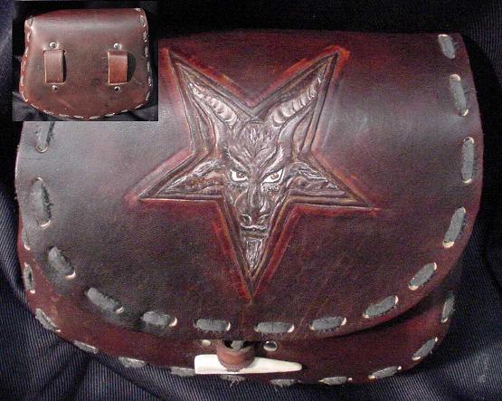

Thanks Tom! The "triquetra" (that's what we tend to call this particular knot in the US- I don't know if this is what it's "officially" called) is one of the easier knots to do in smaller leather work for me. It's nice and neat and self-contained. It also tends to look good in multiple orientations too! I've done it on bags, horn carvings, boxes, candle holders. I even found a 1/2 inch stamp with one on it! swivelsphinx
