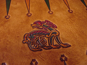

Here's a custom Backgammon board someone ordered from me around Feb of 2004 that also isn't on my site, since I never got a shot of it when it was complete. This one is also of celtic influence (...I do seem to do a lot of that, I guess). The photos are of work in progress, pretty much finished, but not yet trimmed and framed. Kate

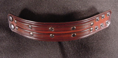

No, these are not lined, although I may make some that are. Meanwhile, thanks for that tip - I didn't know about nickel being a known skin irritant. The rivets are from Tandy, but the closures are nice mini-anorak snaps from Dritz, which appear to have some kind of resin coating on them. I will do as you suggest on the rivets. Kate -

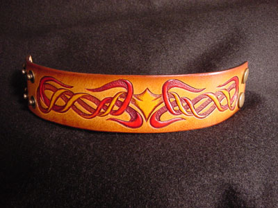

Jim, to color the celtic/tribal design, I covered the entire carved portion with solid yellow dye. Then started working back from the tips with reduced oxblood. When I got to the parts where I wanted the red to fade into the yellow, I used a dry brush technique very similar to what Peter Main describes in his books. This involves loading the brush very dry, then working from more intense color to where hardly anything is coming off the brush. This produces a kind of feathering of the color with your brush. The edges had a little reduced brown dye sprayed around them with an airbrush. Then I antiqued with my usual formula (the recipe is in another thread, but I can list it here, too, if you're interested. Usually, I have a hard time getting the yellow to show much after I apply the antique, but the formula I use now seems to let the dye colors come through a little better, so I was pleasantly surprised to see that yellow still showing after the antique had cured. The other wrist cuff was colored entirely with an airbrush. Solid brown over the entire thing (as well as the trim pieces), then the edges were shaded with some brown dye that had a little black mixed in. Same antique formula as the celtic/tribal design. Kate -

Just finished up a couple of wrist cuffs I decided to make on a whim. I've been seeing high school and college students wearing ones they got at Wally World and Hastings that are made of plastic. Every time I see plastic "leather", I just want to spit! :ranting: But this time, instead of spitting, I made something. Kate
