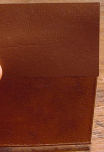

  6. Some tricks I discovered for matching colors... If the customer sends you a photo, there is too much variation in the way different monitors and softwares will display colors, so I ask the customer to send me a physical color sample. I do some small dye samples that I think will match the color of the sample, then photograph them together with the customer's sample and load them into Photoshop, or any software program that will give you RGB values of your color samples. Then I compare the RGB values of both samples, and that tells me what to add or remove from my dye formula to get the right color. (See the attached photos.) The last time I used this method, I was able to pretty much nail the color.
