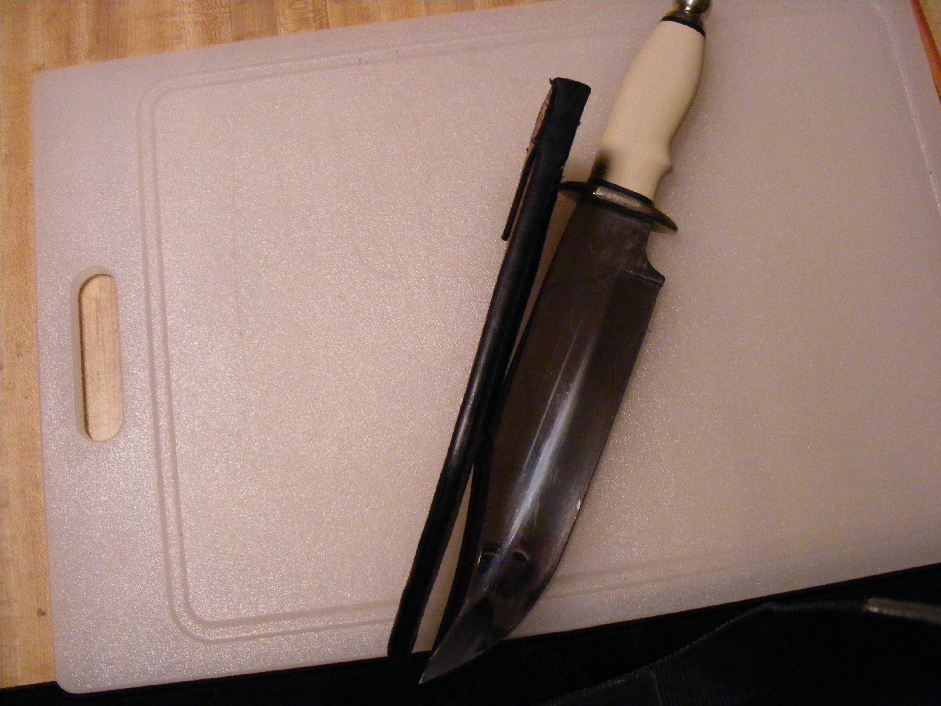

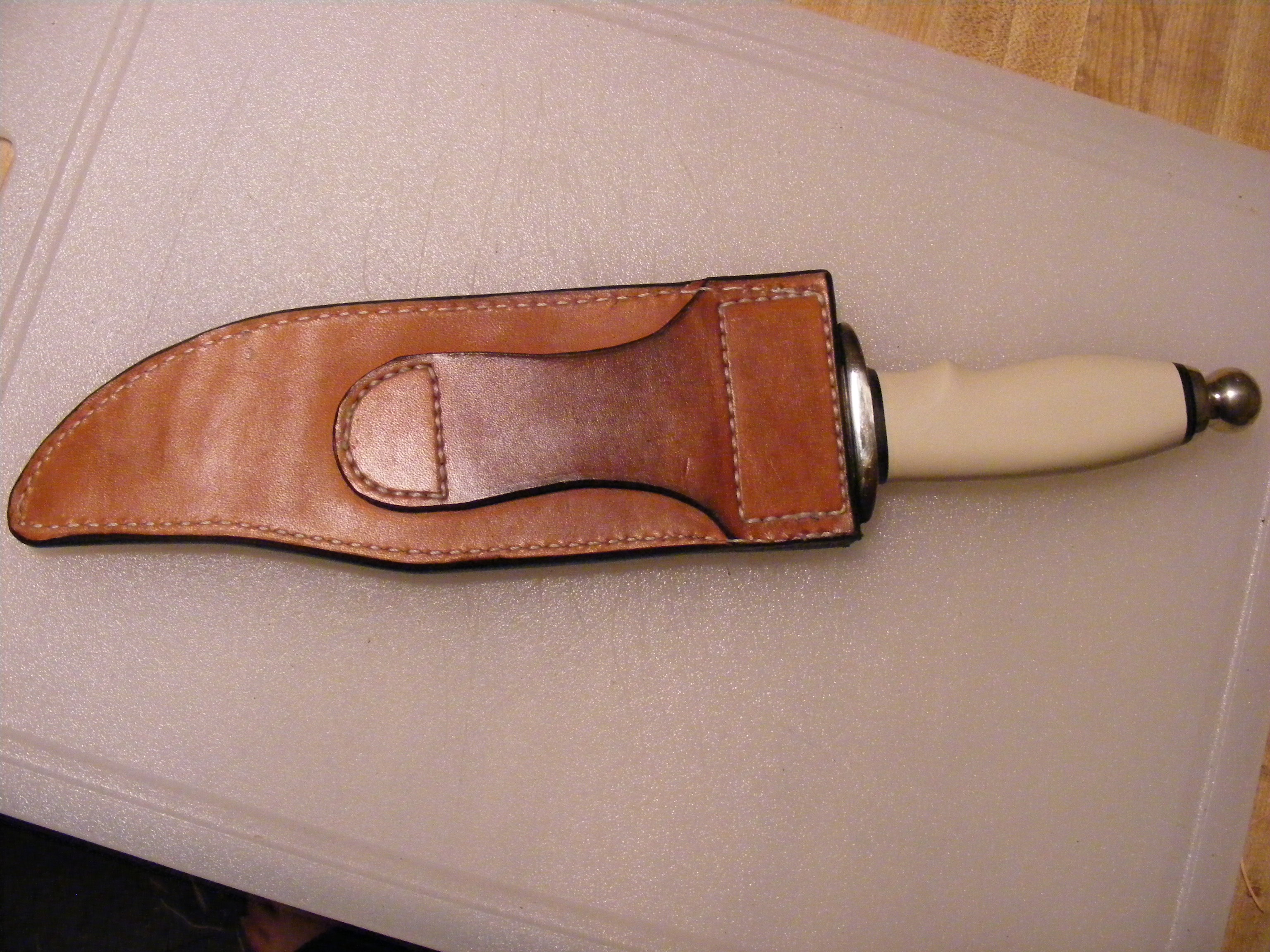

I got bored yesterday, with making holsters for others, and decided to make something for myself. I had a new Bowie, that a friend made for me, and it needed a sheath. I also had some left over 8OZ Hermann Oak so off I went.This is the first sheath I've made in a couple of years so there are some small whoops boos but all in all not too bad. The sheath has a double thickness welt at the spine tapering to single thickness at the clip point and a single thickness on the edge side.
