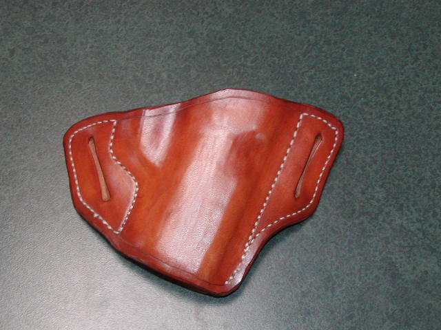

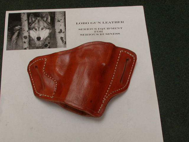

Well, another day in the life of a holster maker, here at Lobo Gun Leather (serious equipment for serious business, since 1972). What a mess! Looks just like a dog's breakfast! Maybe a few of these will look something like the second photo in another day or so. Trying to get caught up on last week's orders. Started cutting patterns about 7:00AM, assembling, cementing, sewing, forming. Too much like work! That is as far as I got. As the photo shows, El Lobo is now in the natural environment (ashtray and beer prevalent). Dying, edge dressing, burnishing, and finishing will wait for tomorrow. Not a bad day's work at all, I think. 12 items for 9 customers, all ready to ship by the weekend. Life is good. Hope you have all had a good day as well. -------
