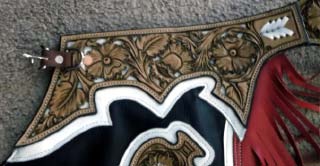

Here's a pair of bullridin' chaps fresh outta the shop. They're headed to TX to a college bullrider. Let me know what you think. Typical bad camera, but they turned out pretty okay.

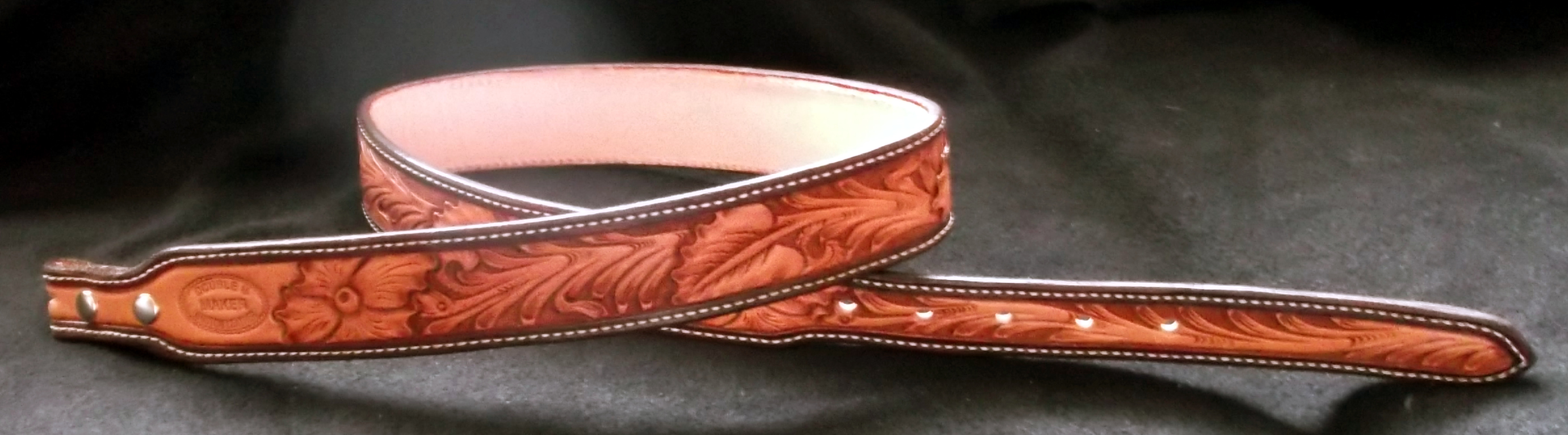

Hey all.....thanks for the nice words. I really appreciate them. And, both customers really liked the finished products. Jimbob....I'm not even sure what type of antique I use (see, the leatherrookie name really does still fit!). I know it's not a paste. It comes in a bottle. Basically, the process is a light oil of extra virgin olive oil, double coat of Neat Lac, antique, rub off excess antique (and really rub it off til there's no more that comes up on the sheepskin), followed by Tan Kote. I hope that helps. Thanks again for the compliments.

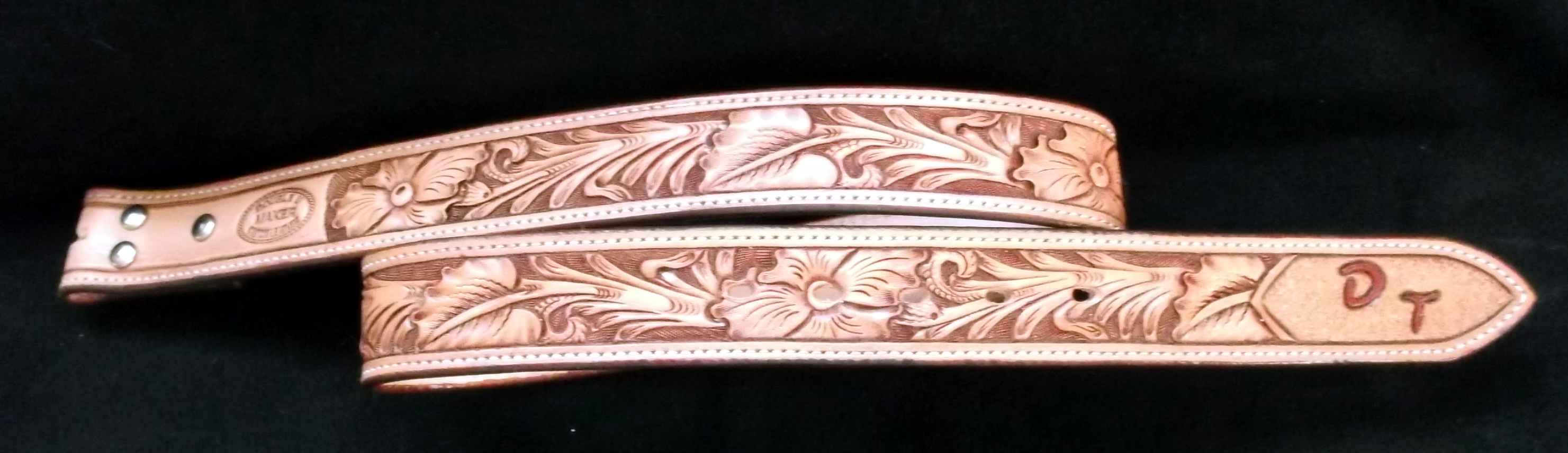

Here's a couple belts I just finished. The one with MB on the tip turned out really sweet. I used a new pattern with some scrolls in it, and I really like how it worked. The other one turned out okay, but I sure like the MB pattern better. Let me know what ya'll think. Thanks for looking and stay blessed.

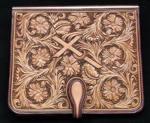

Thanks everyone for the very kind words. The insides were a bit of a challenge, but with some help from a couple friends who are real leatherworkers, I got it figured out. MCN.....the edges are simple. It's just dye. I dye the entire stitch area up to the first part of the border. -
Here's the latest. Got it done just in time for Christmas. It's the last Christmas order on the books. The customer was starting to get a tad frazzled that it wouldn't get done!! No worries. Anyone, for the first one, it turned out pretty nice I think. Let me know what ya'll think. May God richly bless each of you, and remember that Christ is the only reason for Christmas.
