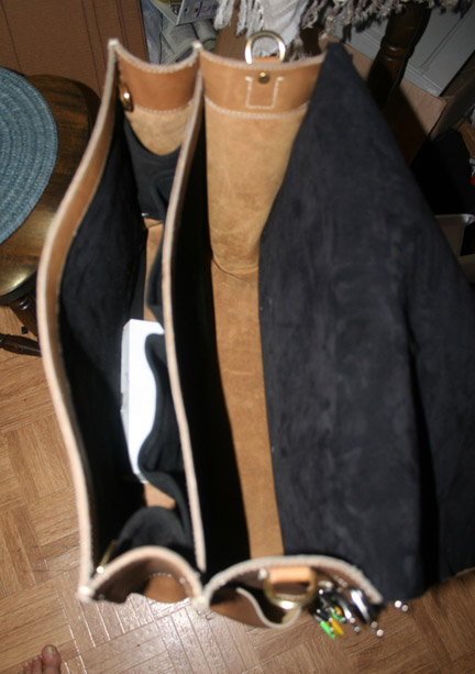

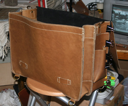

It's been a while...Latest Briefcase
esantoro replied to esantoro's topic in Satchels, Luggage and Briefcases
Thanks all. I've been out of production for several weeks because I was rethinking and revising the process of production and getting used to some new attachments, settings, sizes, variables etc, so that the details in every stitch are more pronounced. As always, thanks for all the help and putting up with my "thinking out loud." Ed -
