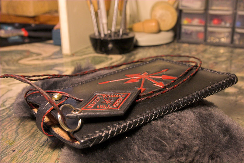

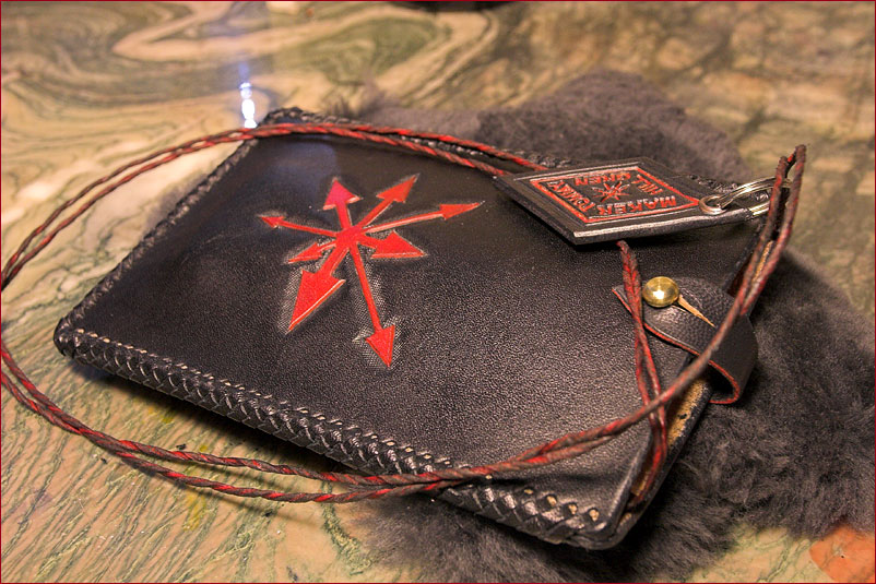

TomSwede Posted April 10, 2009 Report Posted April 10, 2009 Again a chaos symbol AND black/red combo (hey, that's what my customers want;-) but different customer. This case will hang from the neck and keep his glasses handy at work from a twistbraided cord made from goathide. It was decided and added after original design was layed out so stitching position was not optimal and it could have looked much neater if it was sewn before I laced up the sheath, blah!! It is a basketweave braid (off course;-) and the back is plain black so didn't take pics of that. I also made up a keyfob to go with it as he wanted the back clean. I made some molding towards the bottom to ensure the glasses would not be squeezed and take damage when pushing then in and out. I worked the inside with an old cigartube while leather was still cased (I did pour some water from inside too before molding). Tom Quote Confucius - Better a diamond with a flaw than a pebble without. --------------------------------------------- www.1eye1.se blogg.1eye1.se

Members CitizenKate Posted April 10, 2009 Members Report Posted April 10, 2009 Now there's an idea... a lanyard eyeglass case. That is very sharp, Tom! The key fob almost looks like a designer label. Gives the piece a nice, professional touch. Kate Quote

hidepounder Posted April 10, 2009 Report Posted April 10, 2009 Nice case Tommy! I really like your makers stamp on the tag. Classy! Bob Quote

Members bustedlifter Posted April 10, 2009 Members Report Posted April 10, 2009 Super! I like the closure device Tom. Quote

TomSwede Posted April 11, 2009 Author Report Posted April 11, 2009 Thank you very much all!!! I actually wanted to line it but customer wanted to keep the raw leatherfeel at the inside so scratching the glasses is his prob. ALL of my customers ask for a natural back so that is why I almost never line/slick and/or colour the fleshside of my work. Kate: can you explain the term lanyard to me plz?? This case sure has Tom written all over it ha ha but I blame/thank my customers for the kinda signature I use ha ha but it really is my first hand choice aswell. MY Ambassador tells me to not overuse the combo and move on with other colours. The closure is two layers of goathide ONLY glued (Very pro, yeah right) but I do want to see how it holds up without stitching over a longer periiod and customer agreed to this. He can allways come back and get it redone for free WITH appropriate stitching. Gunna have to make me a cigar case in the future. Thanks alot Tom Quote Confucius - Better a diamond with a flaw than a pebble without. --------------------------------------------- www.1eye1.se blogg.1eye1.se

TomSwede Posted April 12, 2009 Author Report Posted April 12, 2009 Thanks Clay!! I feel that that I'm the type that displace just about anything with or without senilestrings!!! It was quite expensive one time when my neighbour asked me to look after his elephant and I misplaced him in my fridge...poor thing froze to death!!!! That is a beautiful and classy looking case RHall!! Yeah, gotta be careful with eyeglasses, expensive and very fragile. I also thought about a snaplock but was afraid it could also damage the glasses (the frame). The ones I can get takes quite some force to close but most of all I think the type I used now was suitable to the case. Yours is alot sleeker and mine is actually made oversized and this was also because i was worried about stress damage to the glasses. I asked customer if He wanted me to make it sleeker with more molding but he liked it fine just the way it was. Tom Quote Confucius - Better a diamond with a flaw than a pebble without. --------------------------------------------- www.1eye1.se blogg.1eye1.se
Contributing Member Crystal Posted April 14, 2009 Contributing Member Report Posted April 14, 2009 Hey Tom- Very classy looking case! I have to ditto everyone's comments about the key fob, very sharp! And of course, as always, the lacing is beautiful! Crystal Quote Black Dog Custom Leather
