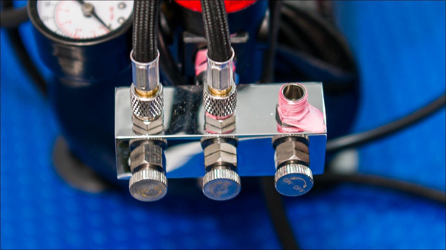

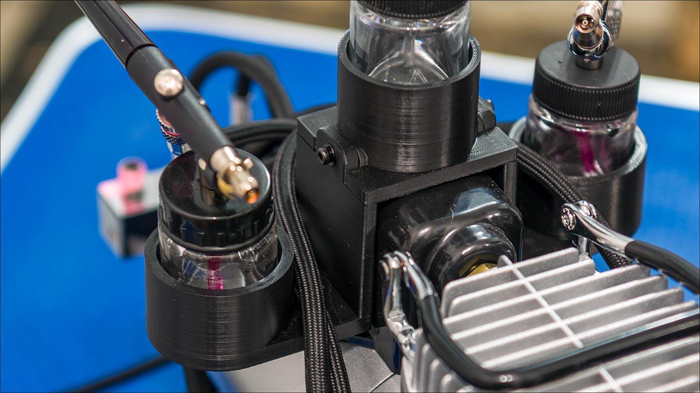

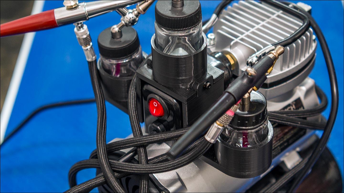

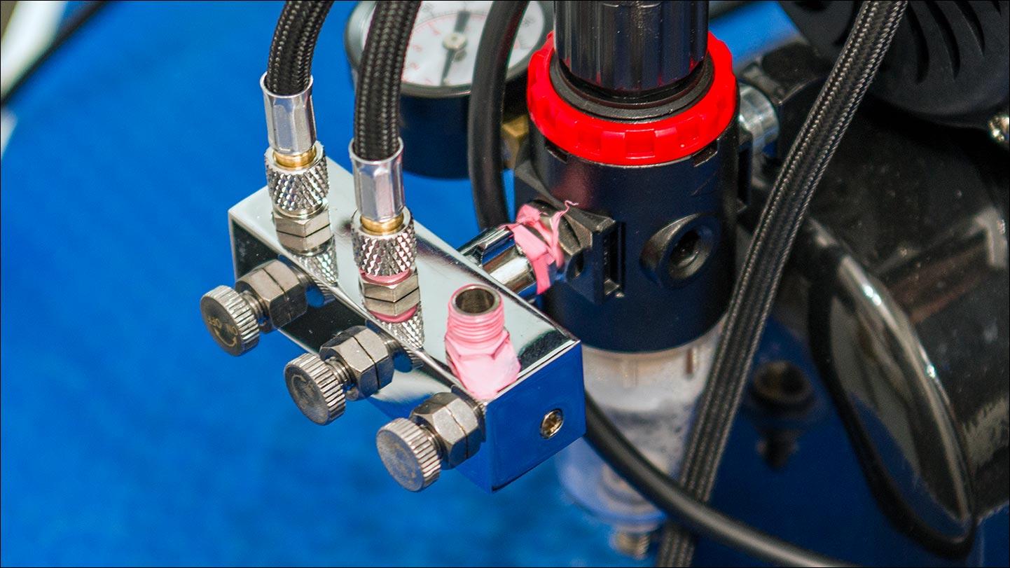

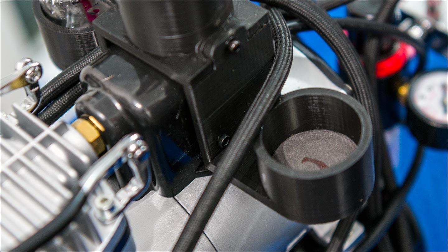

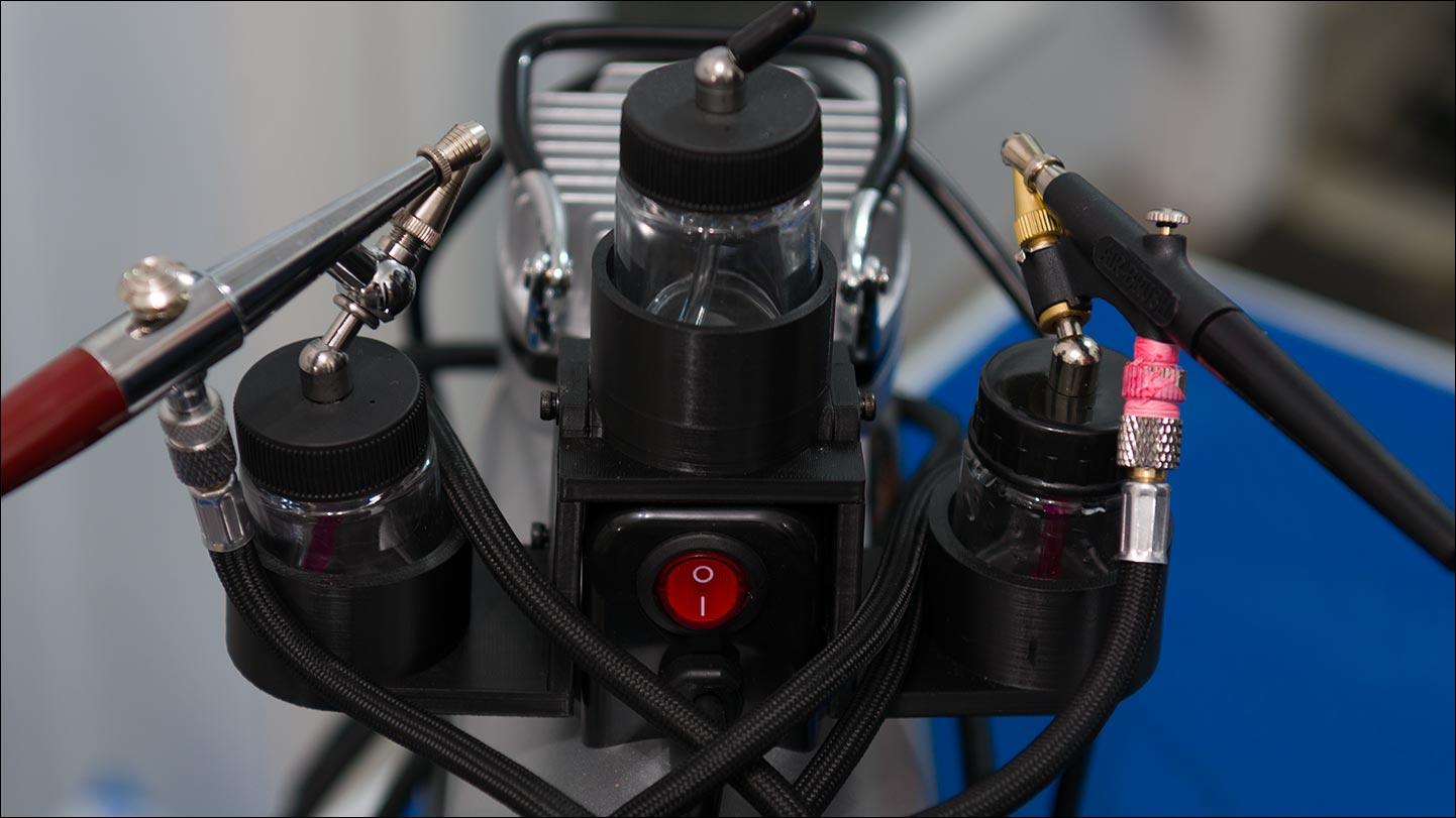

The following is long and my experience for dying, oiling leather. My journey to airbrushing and the cost of a small setup not including a spray booth. How I got here: i) Tried the dabber method I could not get consistent results from one piece to another and used to much dye. ii) Tried the dipping method got consistent results just never liked what it done to veg tan leather or the end result. iii) Tried the brushing method getting consistent results were difficult. iv) Tried the continuous spray bottle that women use for misting hair but typically gave a spotty coverage. The spray bottle was large, clumsy and awkward to use. v) Tried the small cordless airbrush which was a dual action airbrush. It did work but was under powered pressure wise, clumsy and awkward to use due to it's battery pack size. I have used a single action Pasache airbrush in the past with a real compressor and it worked perfectly. The pro to a real air compressor is all the reserve air capacity while the drawback particularly indoors is the noise of the compressor motor. To that end I purchased off Amazon.ca two cheap single action airbrushes ($40 CAD), nylon braided 6' hose ($28 CAD), 10 pack of 60 degree down angle glass bottles ($30 CAD), three way outlet splitter ($10 CAD) and a small airbrush compressor with a 3 litre reserve air tank ($106 CAD ) for a total of $214 CAD. The reason for: i) Airbrushes: The simplicity of the single action airbrush vs the dual action airbrush. Insert the bottle of mixed dye and thinner (50/50) to the airbrush, push the down on the "go" button, set the nozzle spray and you are good to go. As a note I use 100% pure organic JOJOBA oil and the airbrushes will apply it without dilution. I like JOJOBA oil as it is almost identical to sperm whale oil. ii) Hose: The air hoses that came with the Amazon airbrushes, to be kind, were absolutely terrible. They are made of plastic tubing with poor end fittings that leaked. iii) Compressor: The airbrush compressor is almost silent, had a cooling fan, water separator and a 3 litre air reserve tank. iv) Bottles: Pro's: Glass bottles are easier to clean, don't stain like the plastic ones and you can see at a glance how much dye / oil you have left. Also I can mix different dyes, oil and thinner without the worry of any cross contamination. Con's: Getting 60° angle down angle adaptor lids with rubber seals, spout covers and 22 cc (3/4 oz) glass bottles for single action airbrushes can be either difficult or expensive ($6 - $10 CAD each). v) Outlet Splitter: Simply convenience. The three way splitter with three separate shutoff valves makes it so easy to change between airbrushes. Personalization: The setup was still lacking for my needs. It needed: i) an airbrush storage holder and I'm to cheap to buy one that fitted over the Pressure Regulator at $30 CAD ii) a dye shaker to prevent any die/thinner separation. So me being me I designed a very simple one and 3D printed it. The holder mounts on top of the ON/OFF electrical box, install 3mm high density rubber in the bottom of the holders and was dirt cheap to make. When the compressor motor kicks in the airbrushes and or bottles vibrate slightly. Conclusion: What I have found is that airbrushing for dying and oiling uses considerably less fluid then any of the other methods that I have tried and gives more consistent, repeatable results. As a note I use JOJOBA All comments are appreciated. What are your thoughts??? kgg
