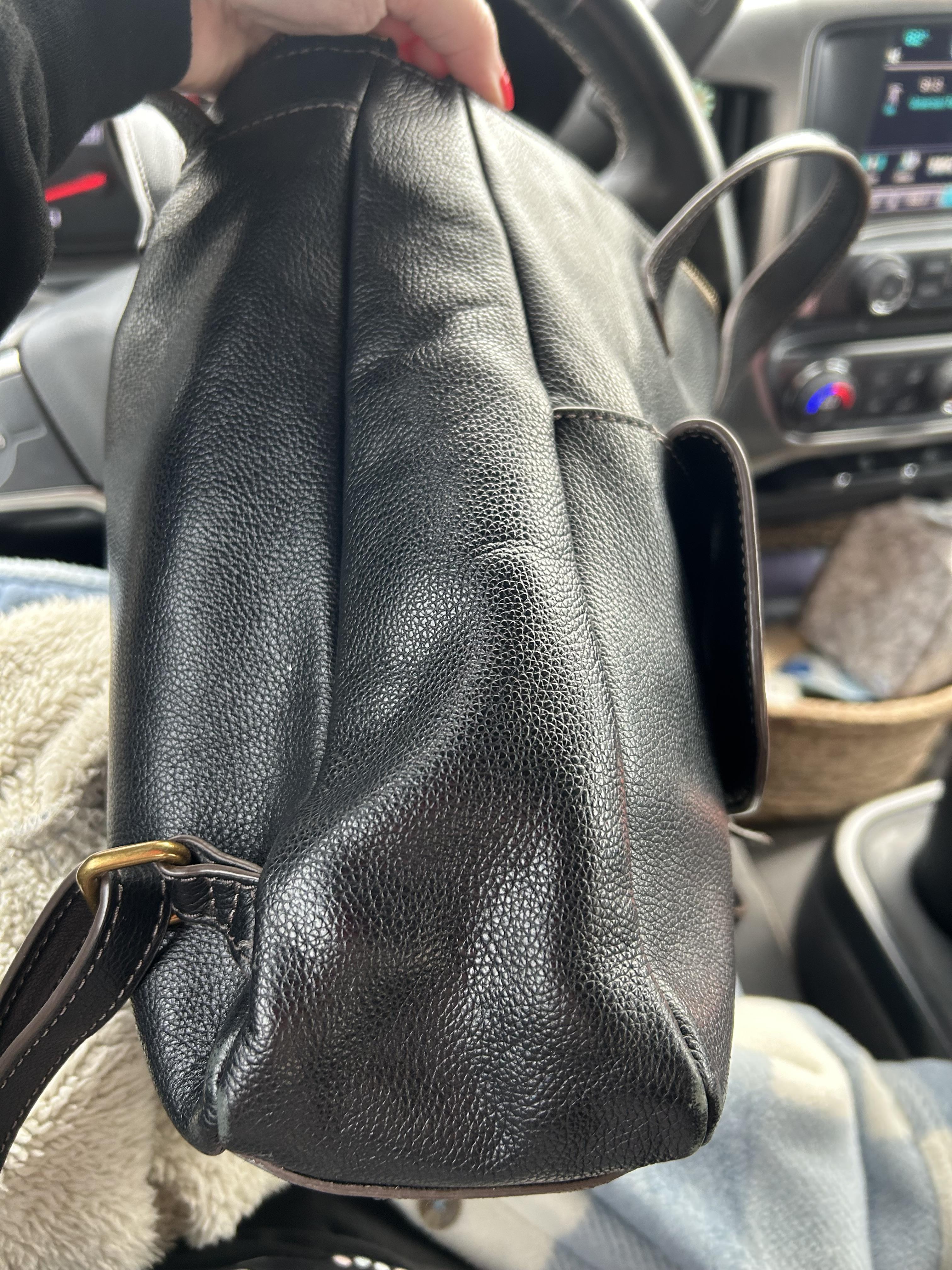

Hello I’m needing some help with pattern creation. I’m wanting to share a pattern with the man who will be making my backpack as he is in India and isn’t quite understanding what I’m referring to, but I can’t find any online. Does anyone have a standard tappered PDF pattern you could share with me? Photo for reference.

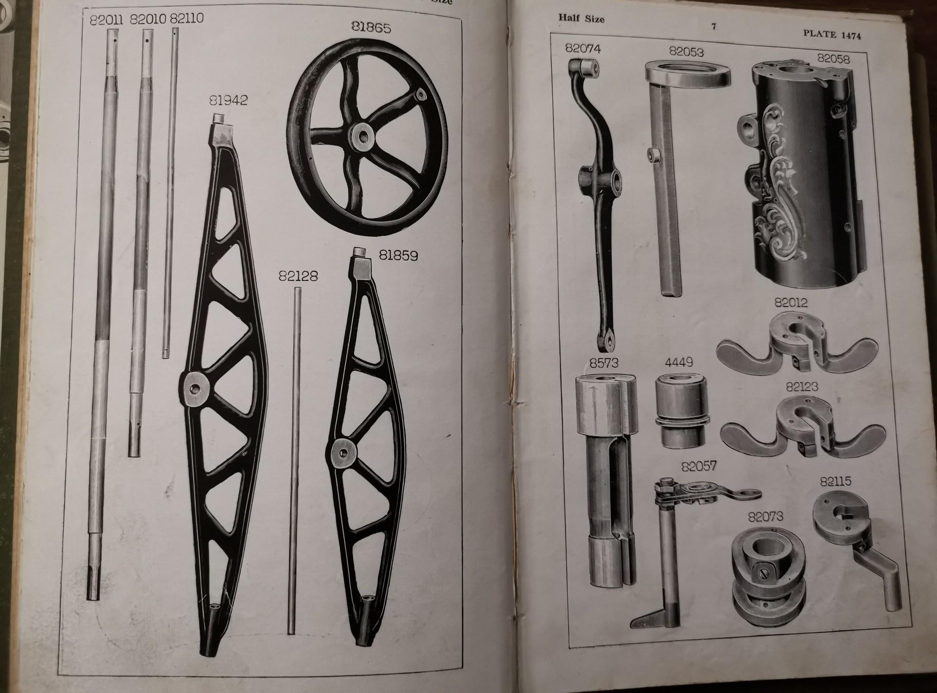

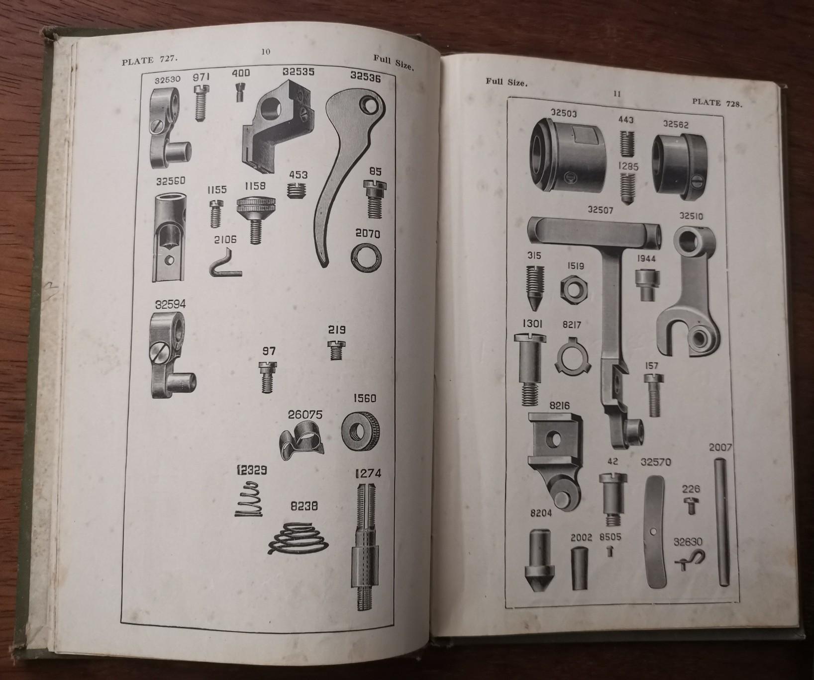

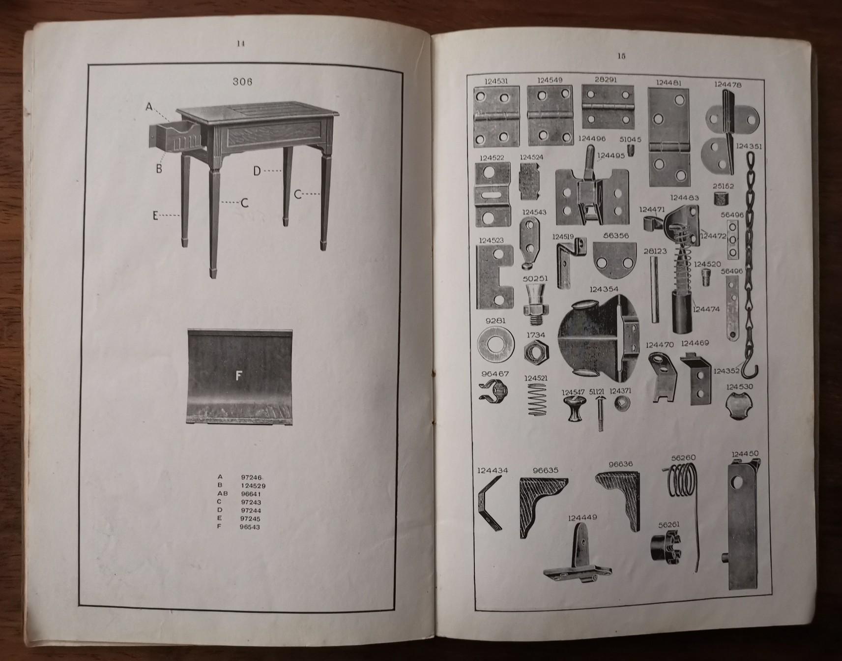

I spotted these whilst searching through an antique book store, I was so excited with the find the owner almost gave them to me for free. He said chances were pretty slim anyone else who might recognise their significance would find them there. Thought I'd share just for the historical significance. If anyone is interested I may be able to photo and email better quality files., just let me know.
