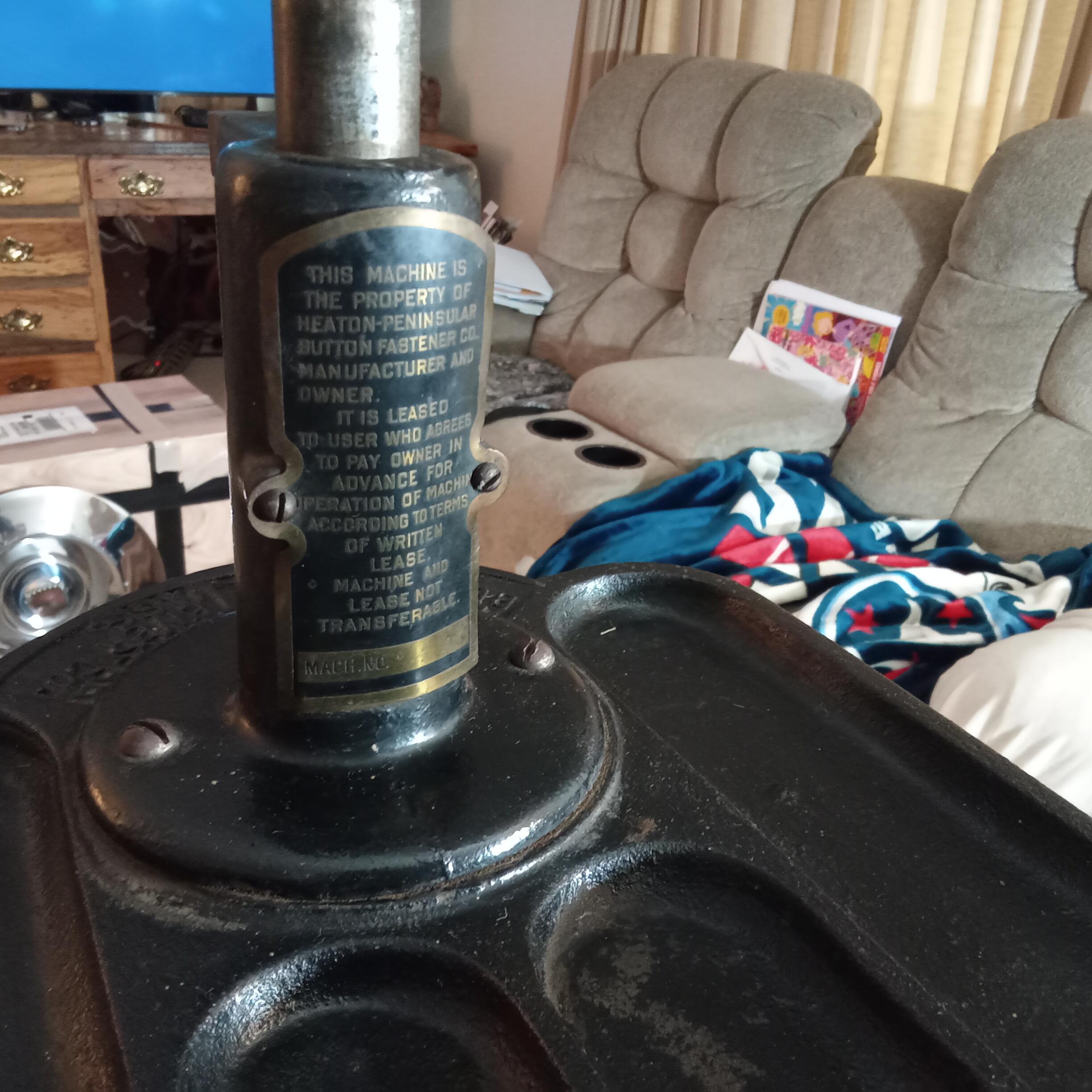

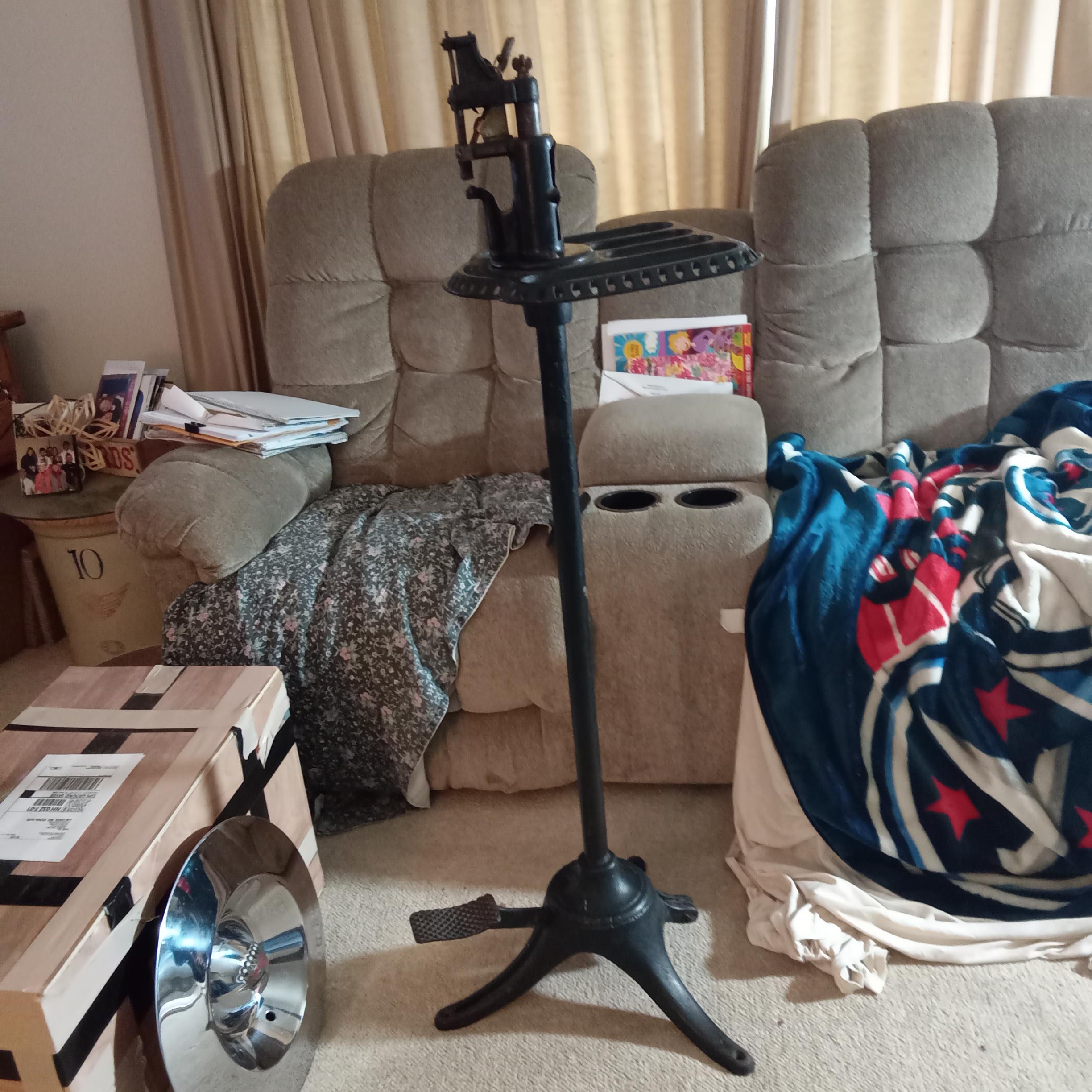

I recently purchased a cast iron stand with a Heaton-Peninsular Button Fastener... manufacturer.... Boston Massachusetts..... Excellent condition..... Is anyone familiar with it.....thanks

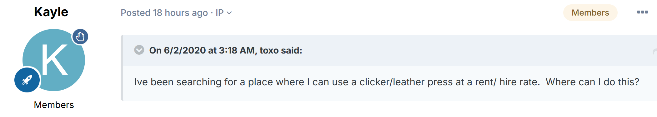

@Kayle When you quote someone, you keep the quote in the box and type your comment in the box below it. What you have done makes no sense at all. Please clarify what you are really trying to do. If you are asking where you can rent, then start a new thread in "wanted". Did you realize that you are commenting on a thread that is 5 years old? Toxo is located in the UK. You appear to be located in Spotsylvania, Virginia, 22553. You should identify your location so you get help that is more specific to your location. This is a world wide forum.
