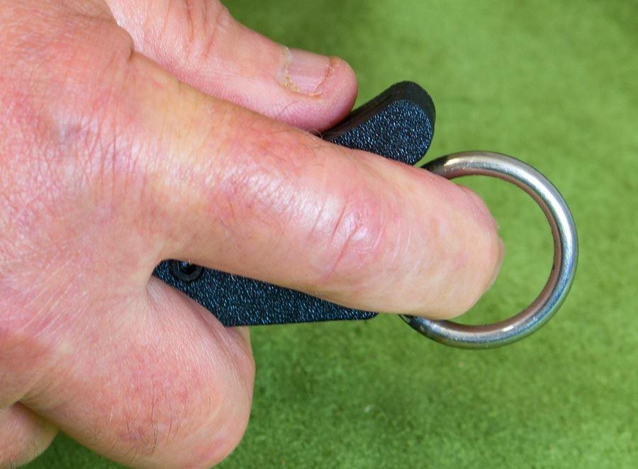

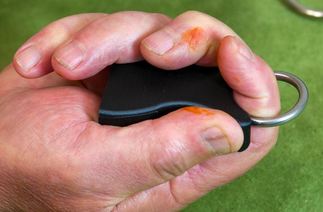

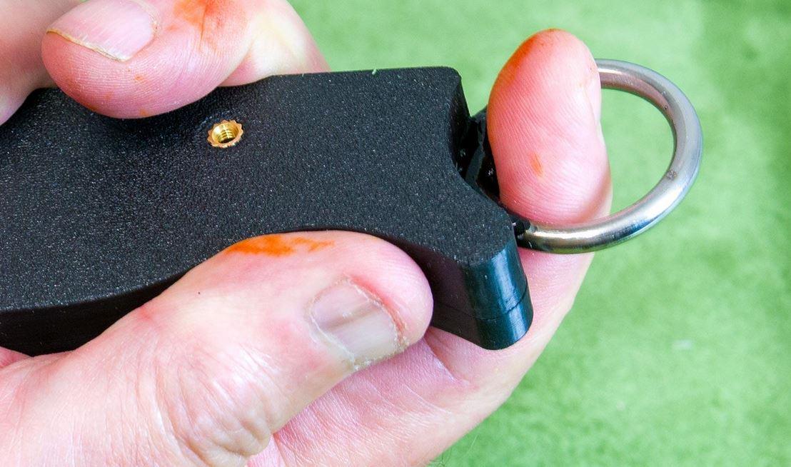

I have tried a few different tools like the bone folder style but was never pleased. I just could never seemed get the right amount of pressure to give the detail I thought should be there. When I did get the pressure right I somehow always managed to gouge the leather. Probably just me. My solution, design another tool. I made a folder using stainless steel welded rings combined with 3D printed parts. Cost very cheap probably less then a $1 and other costs. kgg
