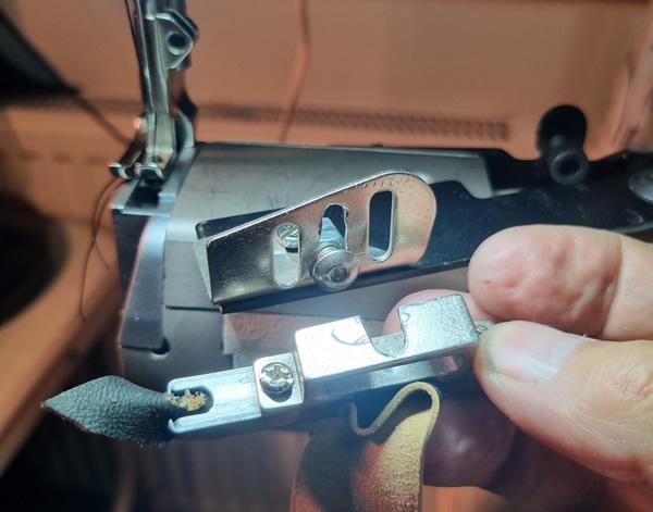

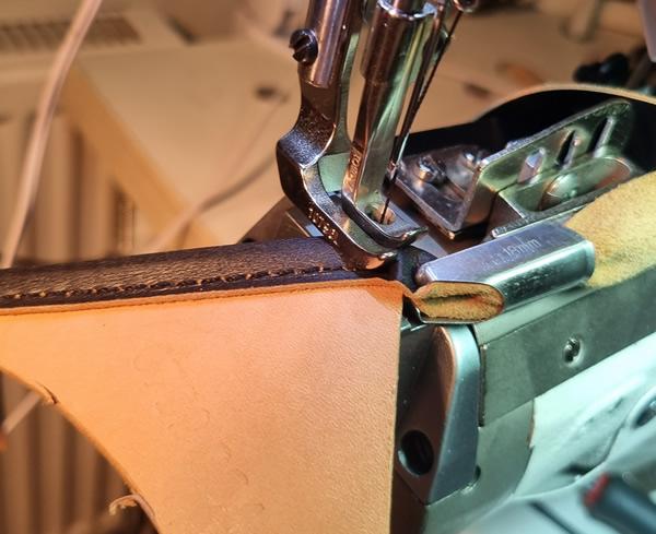

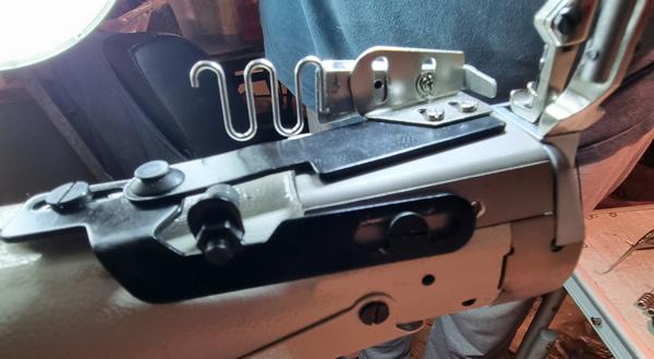

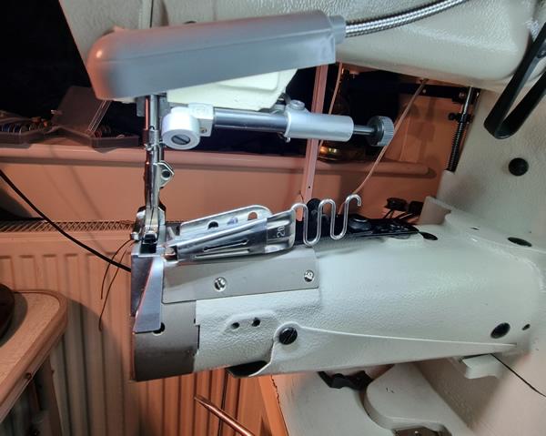

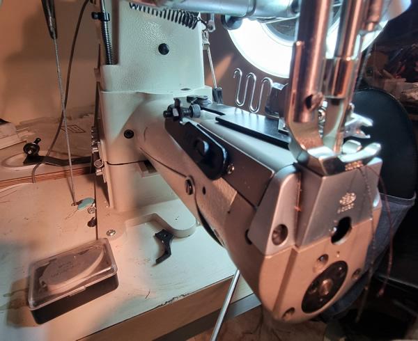

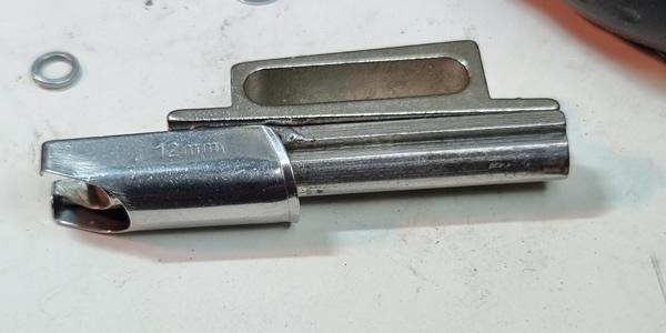

OK, so it took a bit of fettling but from what I've learned ALL binders need some fetting. For starters, in my ignorance I asked for the wrong folder and it was too small. I had a couple of this type to play with and they seemed a bit simpler. Took a bit of working out to get it in the right place whilst retaining all the up/down backwards/forwards options. I also wanted to keep the original bits in case I need them later. Yay! My first ever bind. not perfect yet but definitely progress. I won't show you the back side just yet
