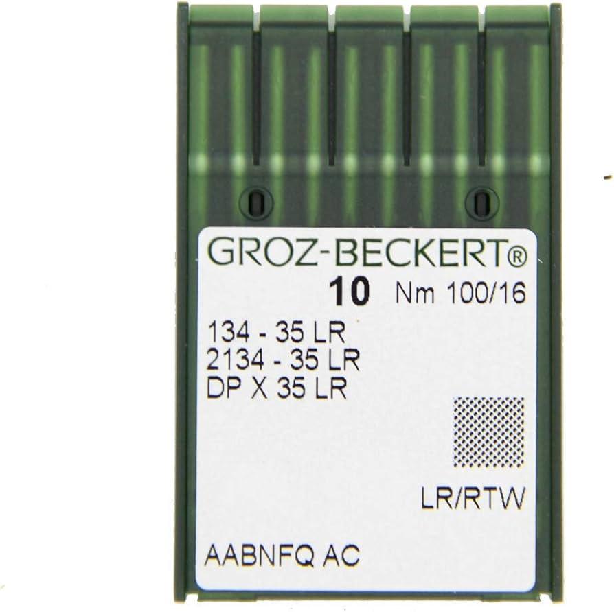

  2. the second spring might be for the P in your clpmn coding. that stands for. Four-motion drop feed but i think we have the same base model machine for the rest.

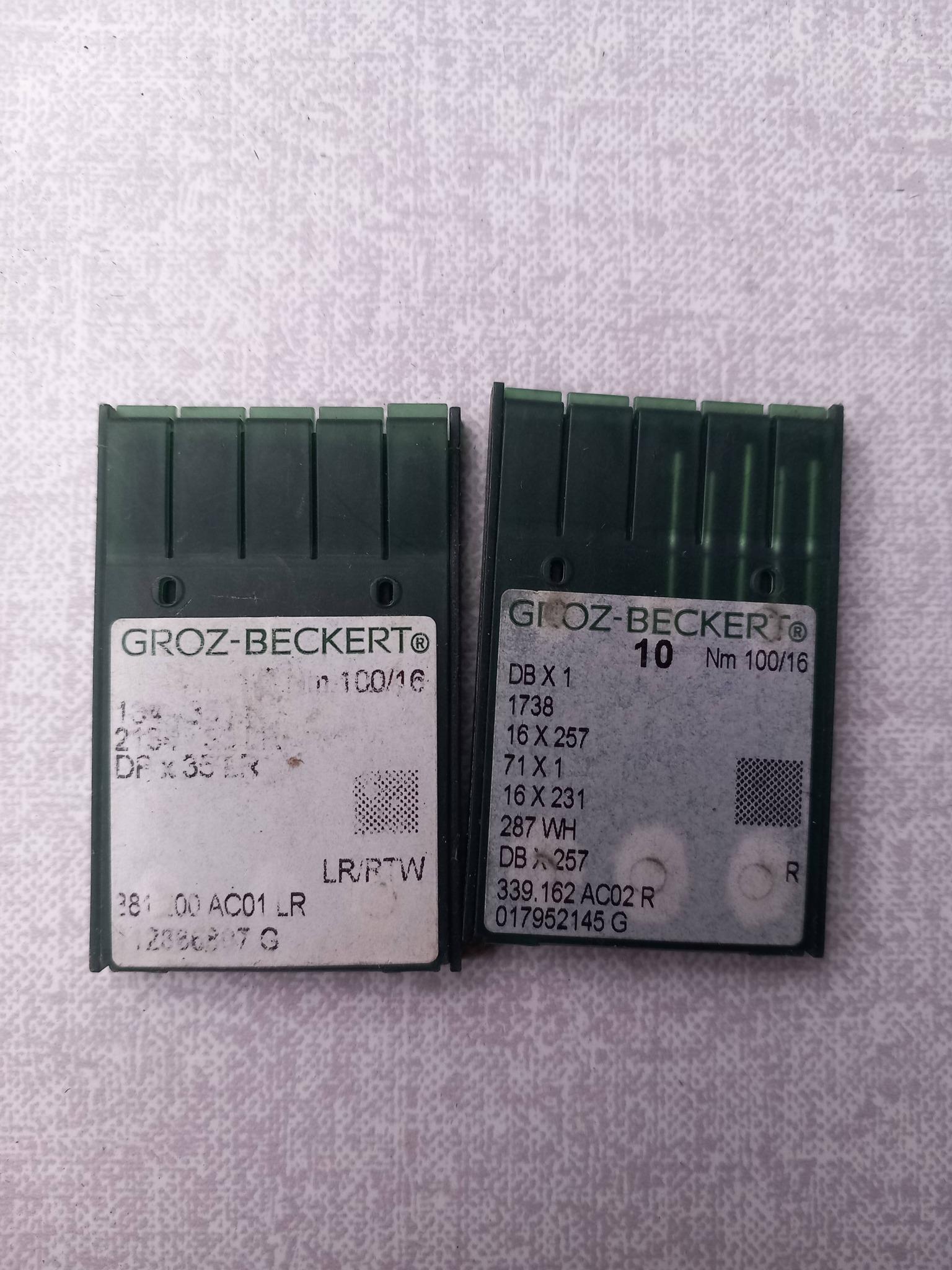

  3. thanks everybody for your knowledge. ill go see what the problem is with the needles in the coming days. im curious now 😆 these came with the machine. and i think the left ones are these ones so im figuring its set up with the 134-35 needles as you guys been telling me. and the 100/16 size is that right for the threads i wanna sew with it ? sorry if my questions are stupid. the internet teaches me allot but gotta say not all the info is always right it seems 😂

  5. thanks for the info. i havent been to my storage unit to compare the needles that are in it and with it. the ones in the picture came with the machine. and the ones i mentioned i bought online according to the specs of the machine. so wil see whats what.

  8. I believe not, according to user manual, but I can be wrong That makes sens. I intend to use 20 (tex 135) top and 30 (tex 90) bobbin, with a 120 needle. I suppose I'll have to get a new bobbin case for it... I'll give that a try !
  9. Thread underneath the base(on the left) instead on going between it.
  10. There were rougly 10 different hooks for the 545, depending on thread thickness etc. Your hook/machine is set up for very thin thread (likely textile garment production), so no open notch. Likely max. NM 100 thread. Good thing: You could still get parts and adjust the 545. What thread are you intending to use?

  12. Hello All, I recently had the opportunity to get a Pfaff 545 : And I am experiencing an issue with tension : There isn't any notch neither in bobbin case top, neither in bobbin case base as it normally should (circled in red below, sorry blurry pic). As a consequence, thread is pinched hard while sewing, and pulling the needle thread to the bottom of my work, no matter how I try to set upper tension or bobbin tension. Have any of you having this machine, a similar problem and how did you deal with it ?

  14. My Pfaff 545 H2 also came with 134-35 needles, depiste the fact that is should use 134 needels according to Pfaff standards. It has probably been modified to run with with 134-35 needles at some point in it's previous life and I keep it this way

  19. Wizcraft is correct, my needles are the 134-35 as well. My machine model is 545-H3-6/01 CLPMN. Mine is for leather so that might explain why I have two leaf springs on mine as opposed to your single spring. Other than that, I think we have very similar machines.
