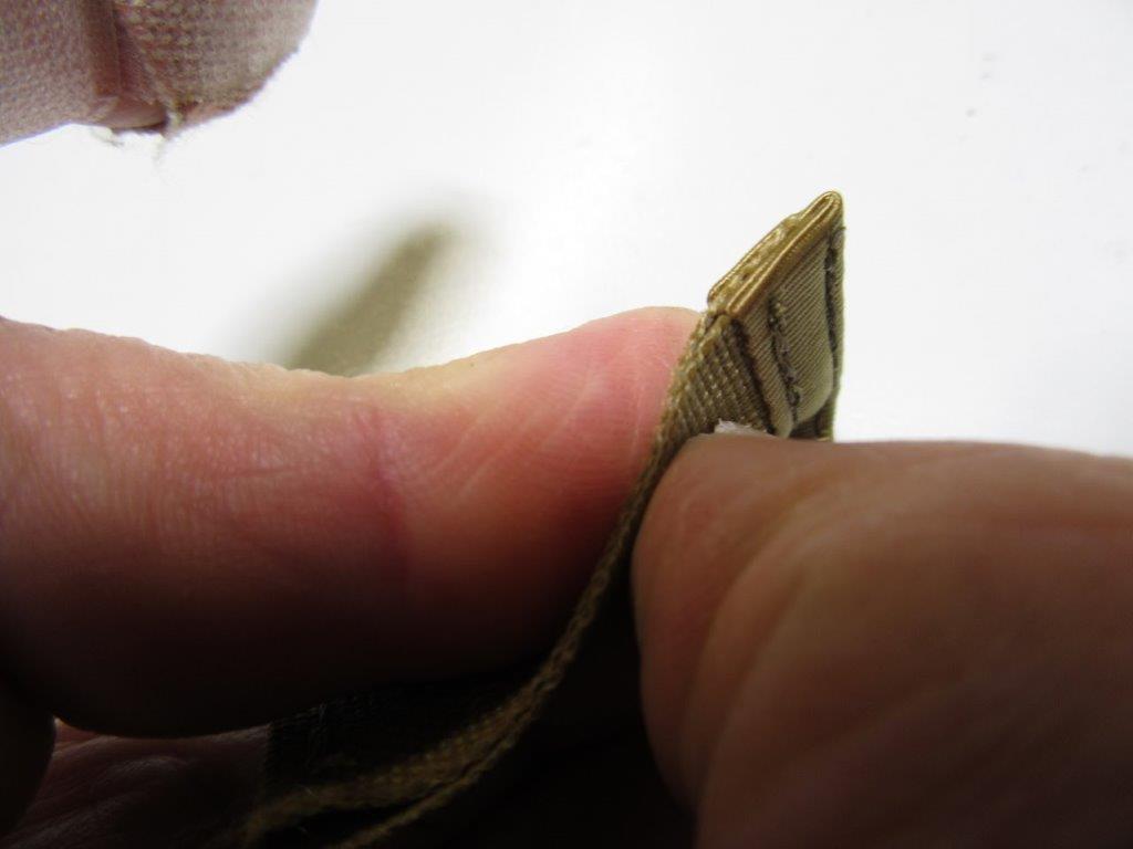

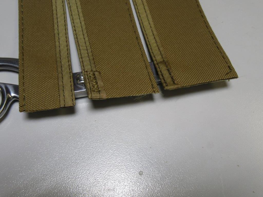

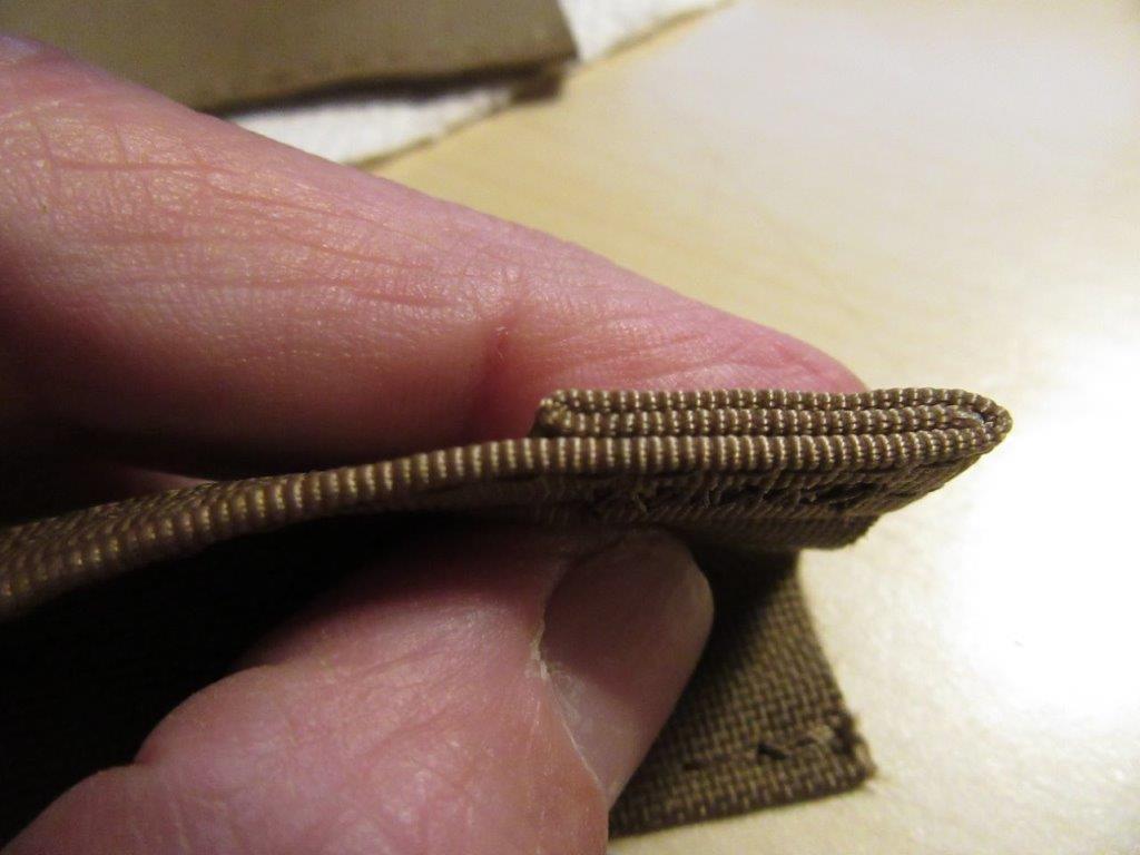

I grabbed some scrap and did a few quick and dirty finish on 3/4" tape ending for example with folding pieces of 1-k cordura . and there probably other techniques also. You can just Hot Knife, cut . . You can do a double-back fold, and do a quick little zigzag or bar-tack . . you can do an inward 'tuck' fold finish . The double-fold over, and tack is pretty self-explanatory for a finish on the tail-end . Hot Knife, cut-off takes a little practice to make look clean, and also a good seal/melt . Also Nylon hot knifes different than if you using Polyester. Polyester binding. You can make both look good, but they melt/act a little differently. Personally I think nylon cuts melts nicer. The inward tuck fold on the finish. That is used a lot with ending finish. Also on binding where you bind a circumference and finish off running on top your starting point. There a couple ways you can do it, and there is some technique involved that takes a little practice . Main thing is you have to stop the binding a couple inches from the finish. leave the Needle or Needles in the plunge holding down the material . Then slide or fold back you binding Folder out of the way, and cut the binding leaving some binding to work with for making the fold-tuck. Then just sew the finish without using the Folder. Also there couple ways to work the binding with your under-tucking . You can just fold it as is, and fold inward. Or you can do a 'split' center-lengthwise in the tailing piece your tucking . - - - -

Hi Guys, so binding has been going fine on my Pfaff 1245 with the synchronized binder. Most of the things I work on are larger. A 24" x 12" cover is small. My Dad had a need for a small pouch he could wear on his belt. The pouch is only about 5 inches long by 3 inches tall. Really small for me. I made a couple, each time with improvements. I decided to bind the edges with 3/4" nylon 4088 tape. That went fine. But then I realized I didnt have a great way to finish the binding. I usually just run the binding over the beginning of the tape, then run it off the edge. Then burn/melt the tail off with a hot knife. Is there a better way? My crude method looks crude when done on a small piece. What fo you guys do? Small stuff is hard! -
