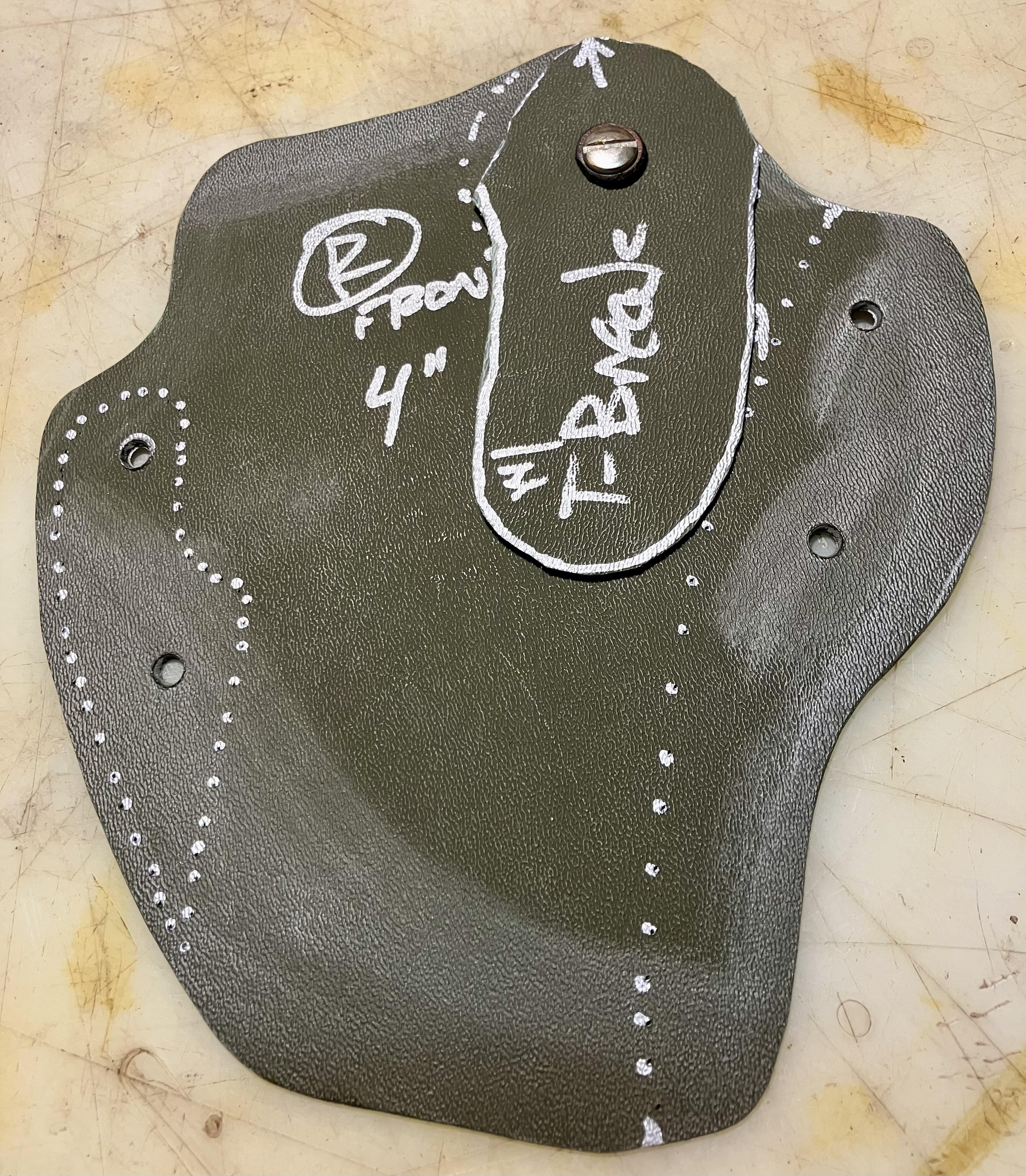

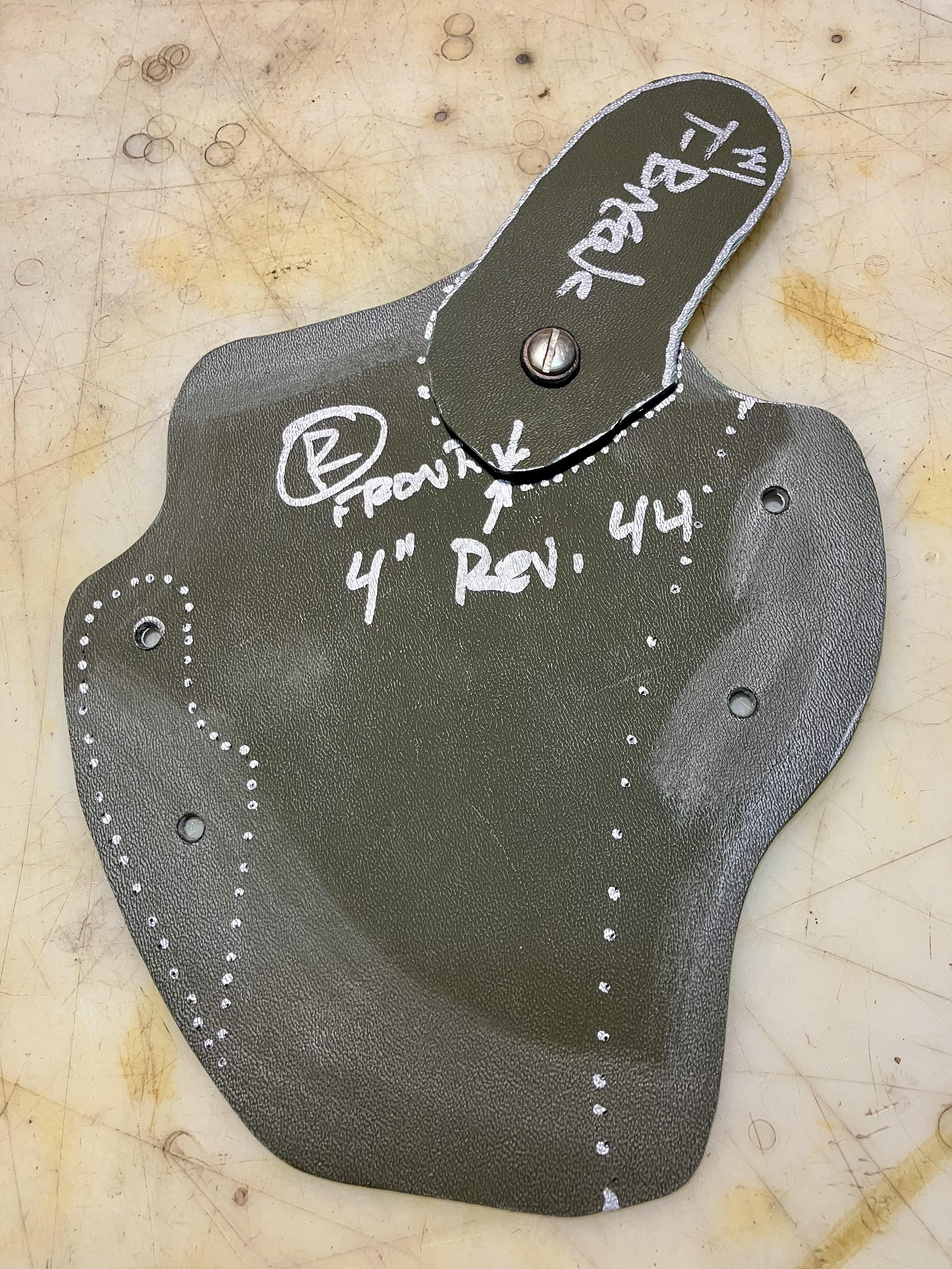

Decided to replace some posterboard patterns with kydex for longevity, but ran out. So instead of making a separate pattern for thumbreak versions, created a swing away piece that patterns the thumbreak. When swung back it doesn’t affect the pattern. But when you need the thumbreak, just line up the arrows. It pivots on a Chicago screw. This way save patterns and I won’t loose the piece.

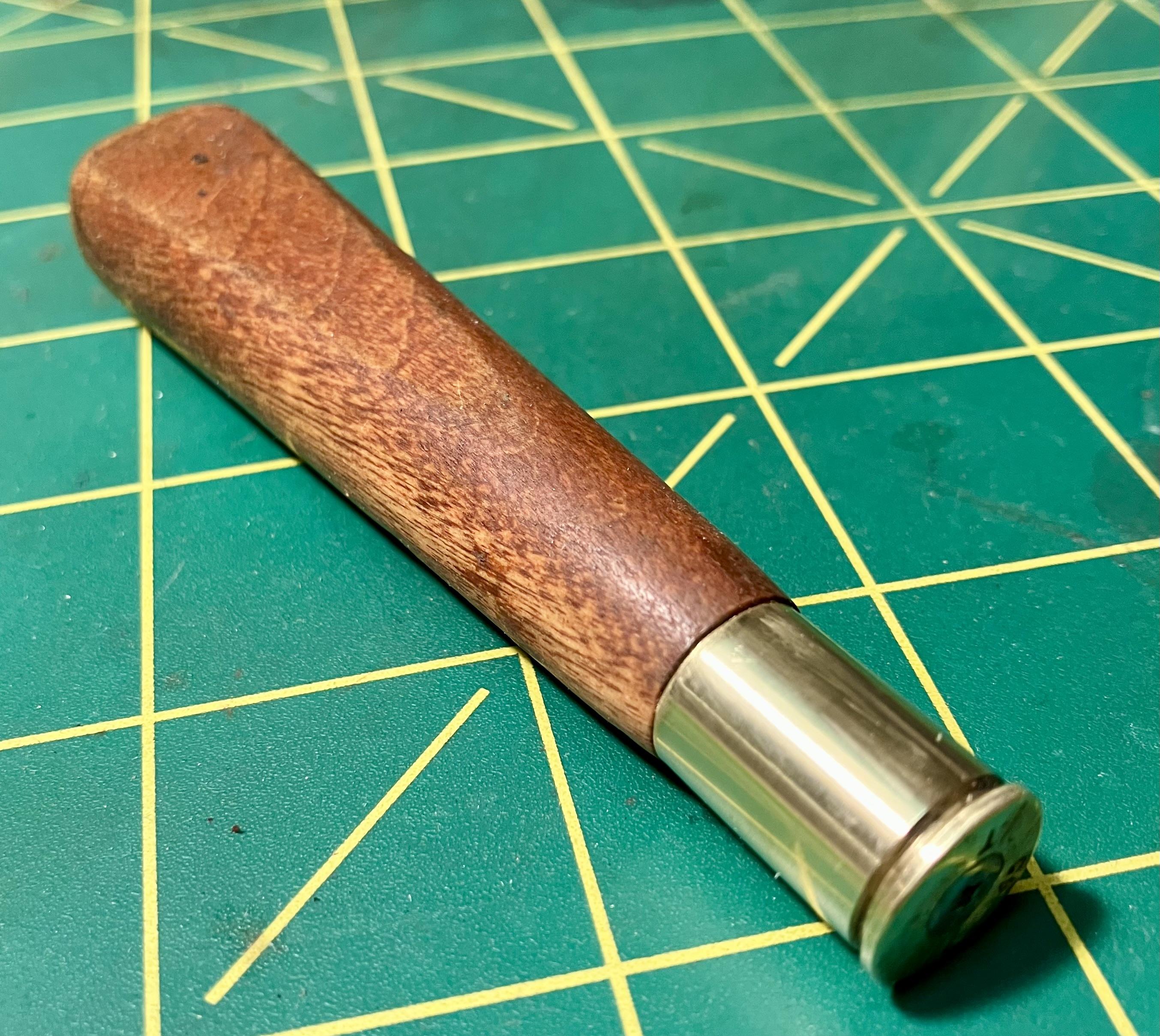

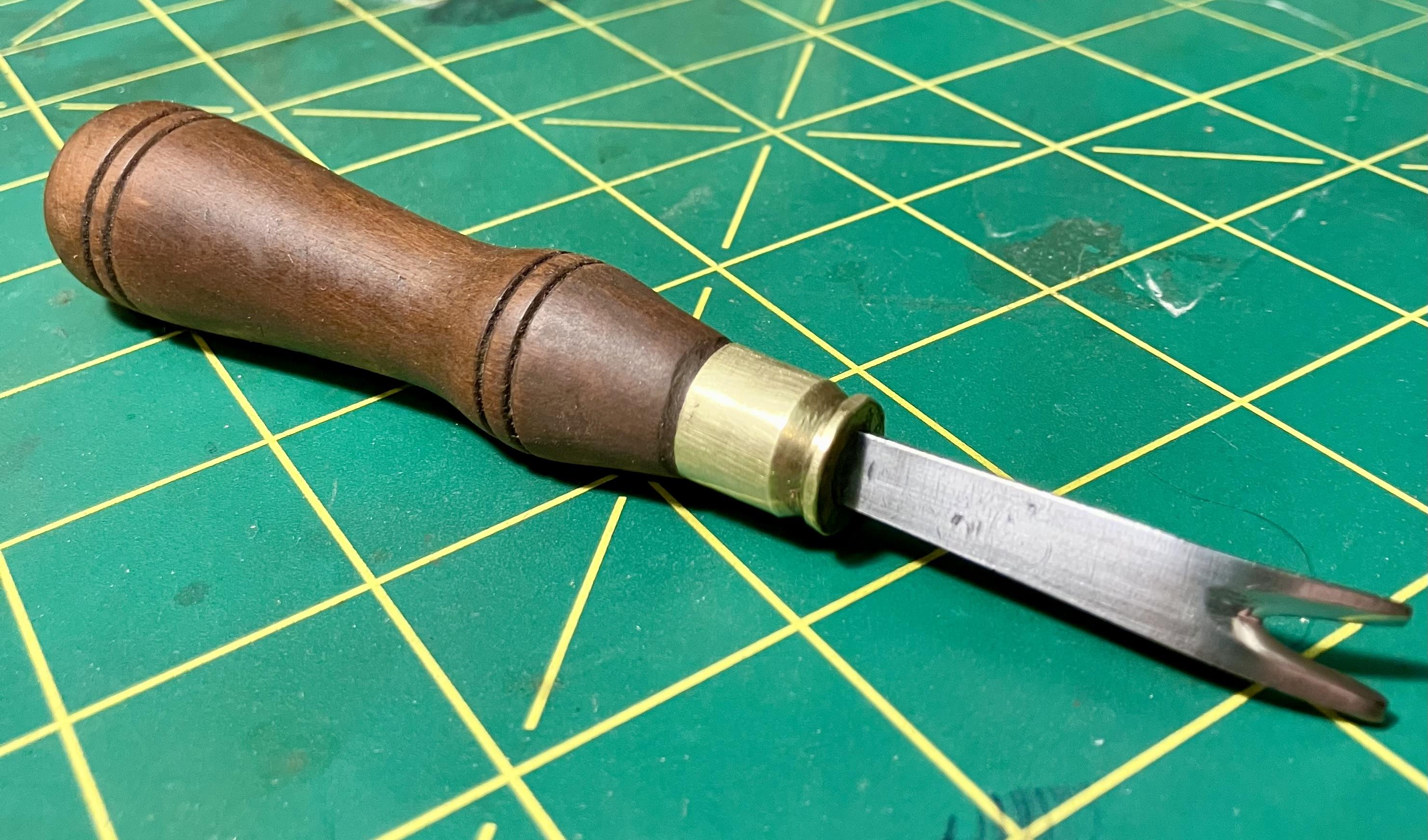

I’ve had an old Tandy awl that I’ve never used as an awl, but it works great as a boning tool for wet molding holsters. Removed the awl blade and epoxied/screwed in a cut down piece of .45 Long Colt brass. Works great, even the rim of the casing adds detail. This edger lost its brass ferrule and the blade was loose. Used a piece of cut down .45 ACP brass and epoxied it in as a replacement. It’s solid now.
