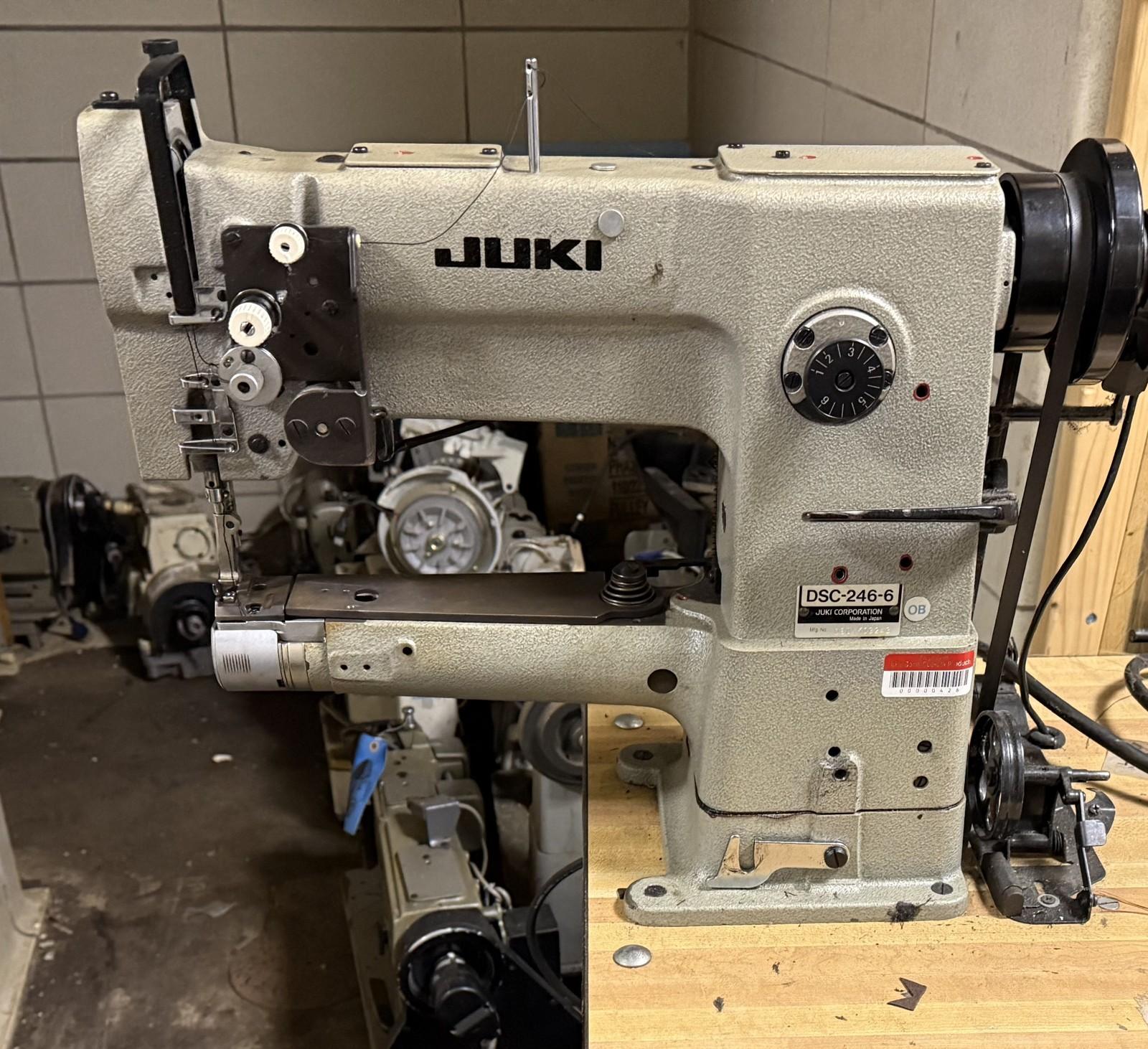

  3. The Juki DSC-246: i) dsc-246 hand lift is 9mm and by knee is 15mm vs Juki LS-1341 hand lift is 9mm and by knee is 16mm ii) the thread ranges on the dsc-246 uses needles sized from 90 to 160 (#14 to #23) so that means it should handle V46 to V138 in thinner items vs Juki L-1341 needle size of 100 to 180 (#16 to #24) which means it can handle V69 to V138 in heavier stuff or V207 in thin. iii) the max stitch length is 6mm for both machines iv) use a "M" style bobbin for both machines dsc-246 loads from the cylinder arm front vs ls-1341 loads from the cylinder arm top v) cylinder arm diameter is smaller on the dsc-246 then the LS-1341 vi) Since we all jam up a machine at some point in time the LS-1341 has a safety clutch while I don't think the DSC-246 has one. In a nut shell if you need / want to use with thicker thread and with heavier / thicker items or seams buy a LS-1341. If you want a binding machine buy the DSC-246. Parts / accessories for the DSC-246 are not as common as for the LS-1341. I sort think of the LS-1341 as the cylinder bed version of the DNU-1541S flatbed. How much are they asking for the machines?? Keep in mind you may want to consider a new LS-1341 clone for about $2700. I would like to know if these machines were used in a commercial environment or by a hobbyist. If they were used in a commercial environment then I would be very wary as they would more then likely have been rode hard and put away wet. kgg

  5. I'm no expert but at first glance it looks like the 246 has a moving plate on the arm which is usually found on binding machines. possibly the feed dog movement is side to side rather than an oval movement which gives more control over more types of material.

  8. I need some help distinguishing the main differences of the 2 juki cylinder arm machines. i prefer the bobbin arrangement of the 246. I sew backpacks, so need this machine for sewing in bottoms, doing some repairs, binging round bottoms and items with tight corners, sewing collars ect. I used a 246-7 earlier this year and was impressed, and the swing away binder attachment worked well, though i have no need for -7 version. i do not want a dedicated binder for this machine. Advanced sewing has both models available used and trying to make the most informed decision i can. on the pictured 246-6 they offered to set it up as a manual machine, new motoor with needle positioning. my work is at alpineluddites.com if you want to see exactly what i build. i did buy a Pfaff 355 a few years ago and it didn't have pull i needed and kept breaking needles. i sold it to a leather worker. thank you
