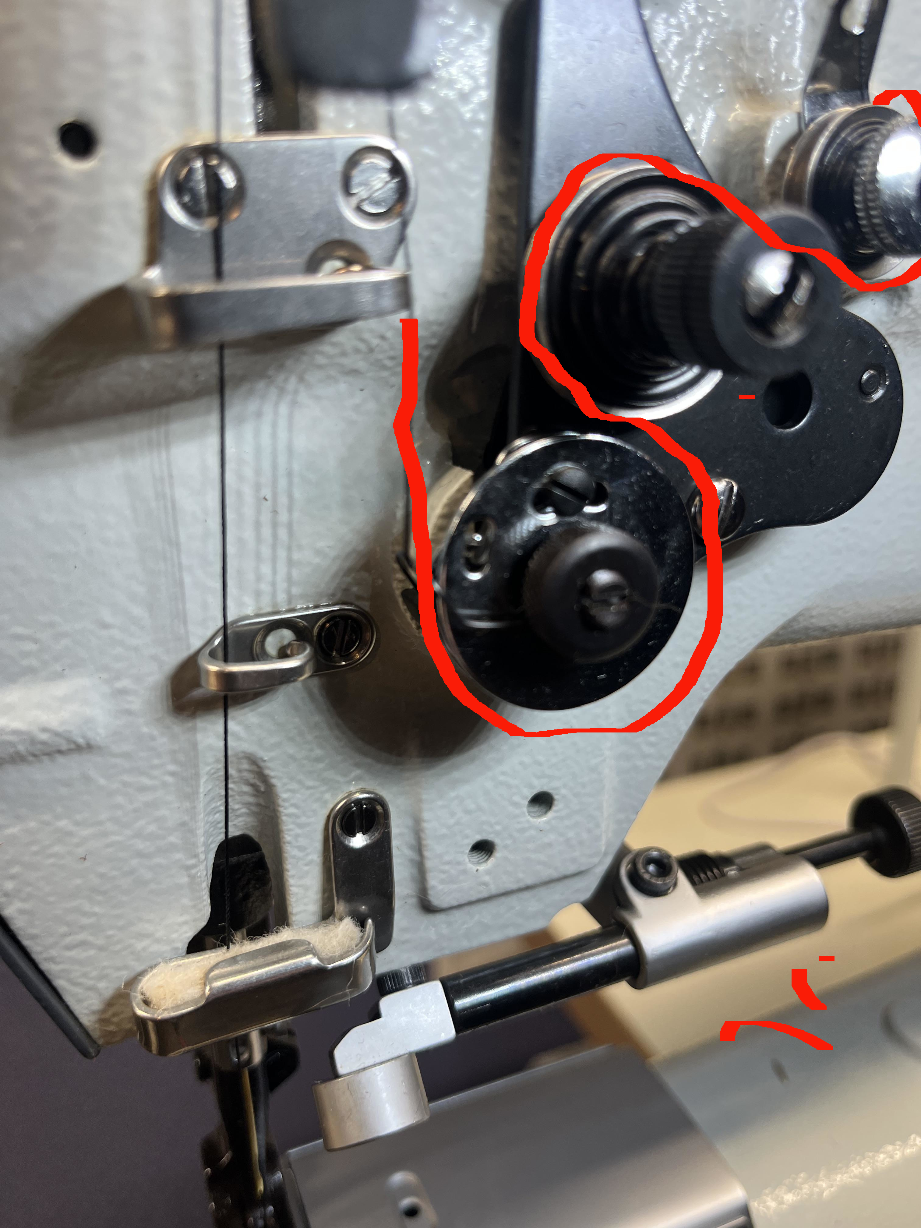

Your threading of the top thread around the tension discs is incorrect, refer to your manual for the correct threading. kgg

My thread keeps jumping out of this tension spring. Do I need to rotate it down to keep the thread in? Also do I remove this wool like material from this thread guide? thanksr tj
