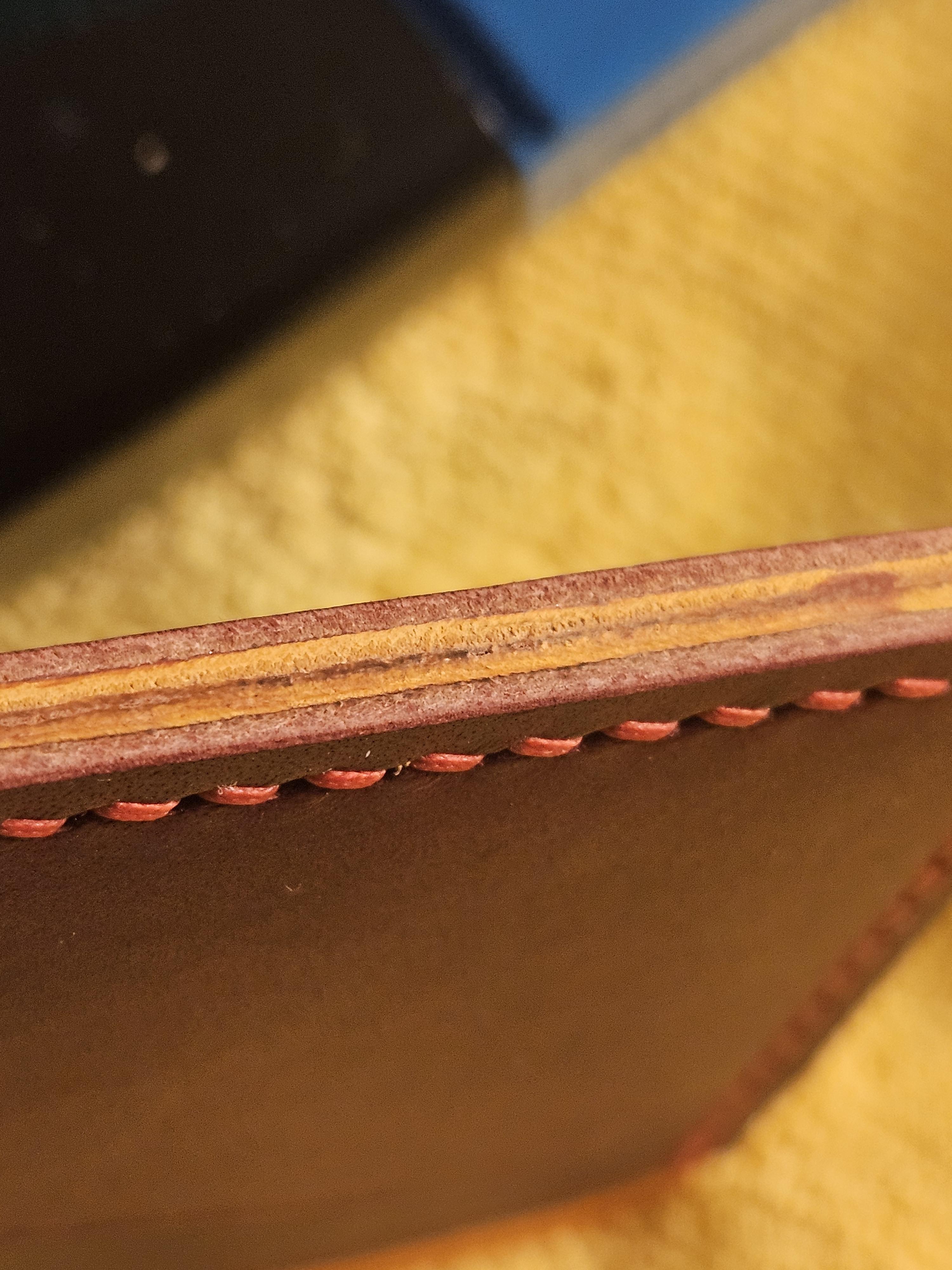

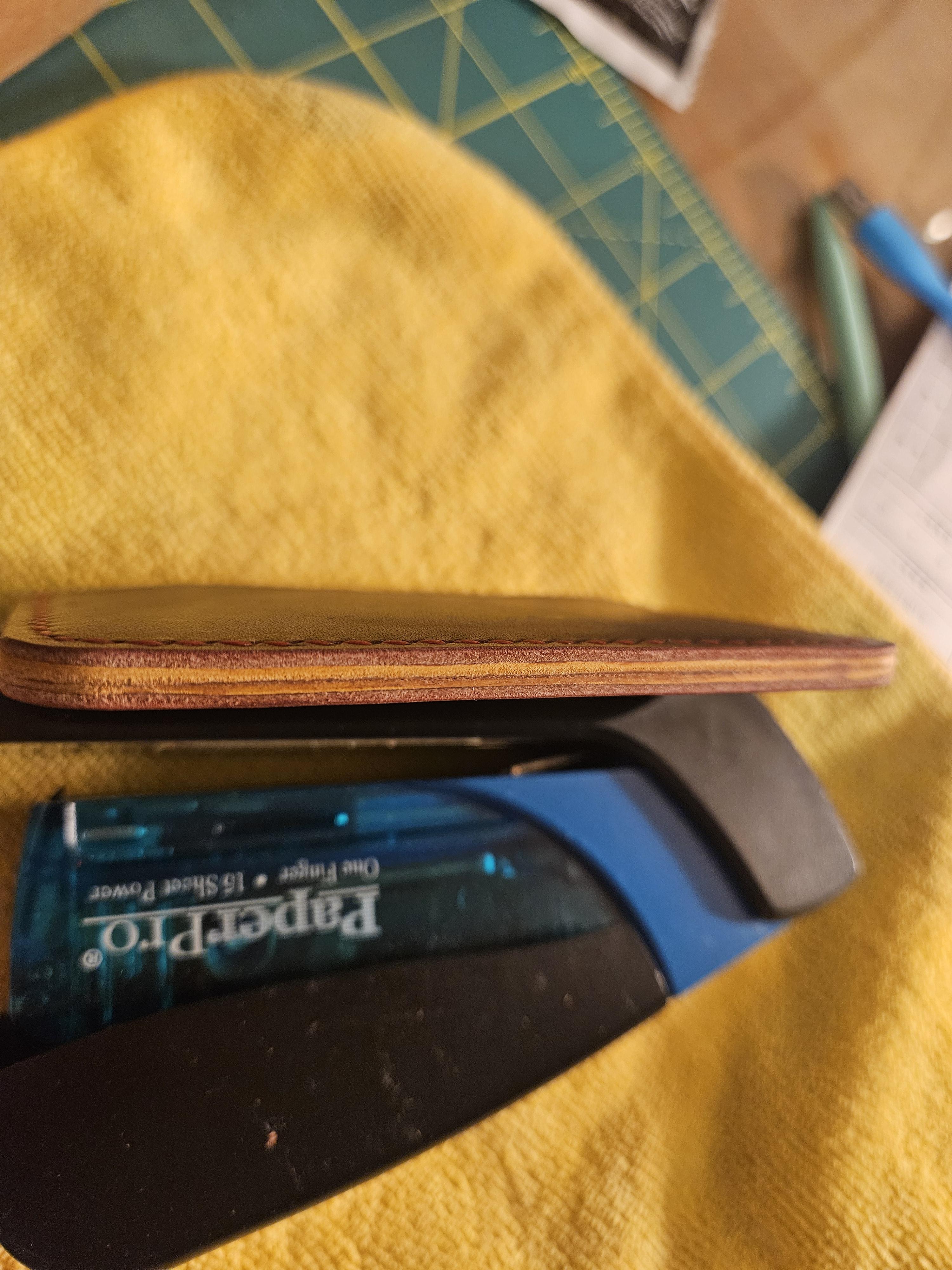

That looks great! It would be time for tokonole or gum trag, or you could go with Nigel’s method, which he swears is not licking it off-camera before slicking. (It does work, though… 😉) -AZR

Yeah, that's lookin' good. Apply the Tokonole! Good luck!

Thanks for the input guys. Here's me latest project. Sanded the edges upto 1000 grit. Shall I apply Tokonole now?

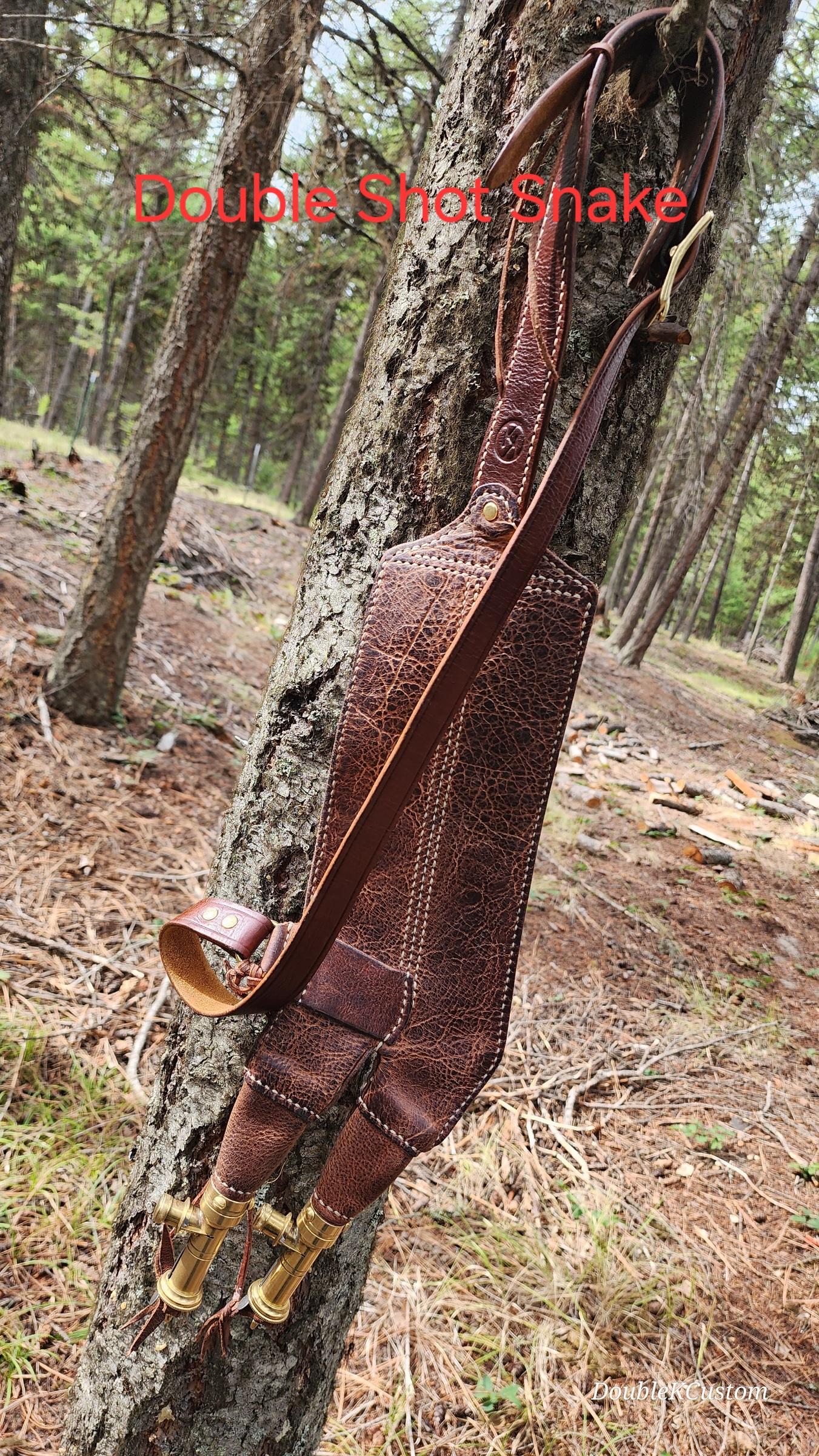

That is really a specialty item! Looking really good I must say. My best suggestion would be to use a cow horn. In Europe it was the standard thing for holding black powder, so it won't be damaged by the chemicals in the powder. Cow horn can be shaped if you heat it up first. I am unsure about what temperature, but I think 325-350 degrees Fahrenheit seems to be the spot as far as I can see on the Net. You heat it up in some hot oil, and then you shape it. I'd make a tapered piece of wood with a broom stick as a handle. The tapered piece should look like a small cartoon christmas tree, with the brrom stick out the wide end. Cut a cow horn to a length a bit longer than the tapered piece. Heat up the horn, and press the tapered piece into the horn, and when it cools down it should retain its shape. An alternative route is to take the wide part of a cow horn, cut a piece off, slit it open and heat it up. Then you flatten the piece. WIth the flat piece you mark out to form a tapered pipe. THen heat it again and shape it over a prefabricated piece of wood. I have never tried working with horn this way, I just know the theory behind it. But I guess it might be a heckuvalot of work to make something like that when no one is ever going to see it. A second option would be to form a small cone using some sheet metal brass. Brass is easy to solder and if you get something fairly thin, it is easy to shape as well. Brgds Jonas -

A polythene measuring cup, with the bottom cut off. The polythene will be flexible enuf to deform but re-take its shape -

Nice. Got it done, looks pretty good. Having lined pouches for blackpowder and shot I feel your pain keeping things all together and lined up. Not sure what you used for lining here? I ended up using waxed cotton canvas to keep things moving freely and mostly waterproof, although the bison was fairly water resistant anyway. Nothing, I mean NOTHING sticks well to waxes. I used heat and tried to clean the wax off the edges, and that didn't really help. But I didn't need to punch stitch holes through the canvas. I figured that out after an hour or effing around trying to get things lined up so I could punch everything. The needles go right through haha. So in the end it wasn't too bad, but it was difficult none the less. Ensuring there's at least a folded edge so the stitches don't pull through, while keeping it all nice and flat against the leather (glues and cements don't work) was really frustrating and I think I went through double the material before I got it right. Any kind of pouch with loose lining is a nightmare to make imo

I just got an order for a double shot snake. I've made one before, for the same costumer but it's been a few years. Definitely not a very common item, even at all the black powder supply companies online. There's no need to make any changes to my pattern, but he suggested using something on the transfer from the shot bag to the spouts to help keep their shape. I was thinking something like a funnel but not a thick piece of plastic. Was looking for something thinner but crush resistant. I have no clue what to call these tapered tubes other than that, tapered tube. That's not working for me on Google and was curious if anyone has any recommendations where to start? I could go with plastic sheeting but i think that'll crush. Anywhere here's a picture. The area I'm taking about is between the 2 powder/shot spouts connection and the main body. Any help is appreciated. Thanks
