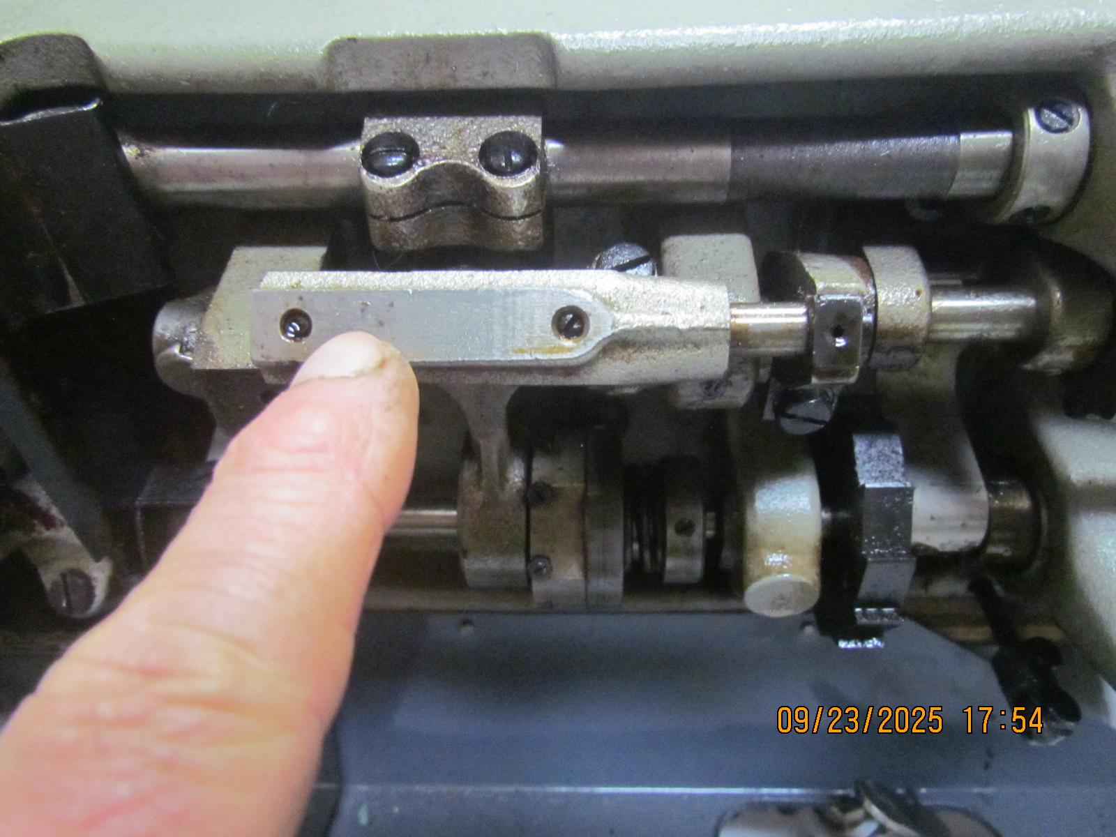

  2. Here's the part that should move, if I'm understanding the video correctly...

  4. That's in the ballpark.. Is the inner toe still lifting higher than the outer toe?
  5. Here's the link to the video. Procedure starts at about 10:00. I'll post a pic in a bit...

  7. Thank you again everyone! I will respond in more depth soon. Just wanted to share an exciting update. I haven't worked on the stripped screw at all. However, I noticed that now the worm screw "D" turns with some resistance and actually changes the height that the presser feet lift. So I guess all the PB blaster freed something up in the eccentric mechanism? Even though I can't loosen the set screw "C", the worm screw "D" is moving the eccentric. So I was able to use the wisdom in another post combined with turning the worm screw "D" to get it walking high and looking good to me. I've attached a video of it walking now. Does it look right to you all? So I still need to address the stripped screw, but at least I know the machine is usable and adjustable and works right. Will report back when I have time to work on the screw again. Walking111.mov

  11. Can you post a link to Uwe's video, and post photos of the block you're trying to move?

  13. I was attempting to equalize the forward and reverse stitch length, as described in the video by Ewe. Got to the point where you move the block, to either lengthen or shorten the forward stitch, and it wont move. After loosening the screw, when I try to move it, it just moves the reverse lever. Isn't it supposed to pivot on the shaft?
