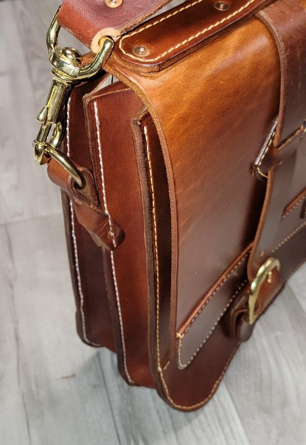

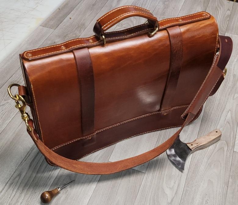

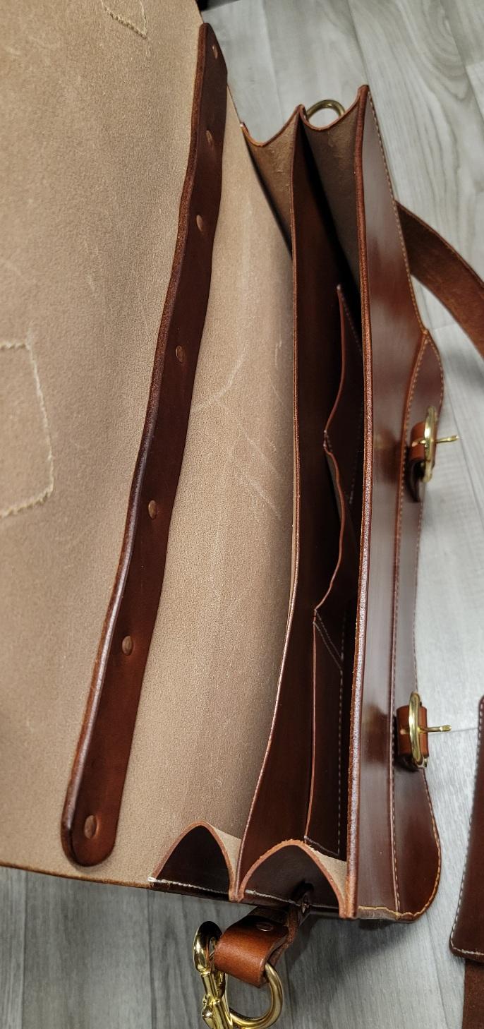

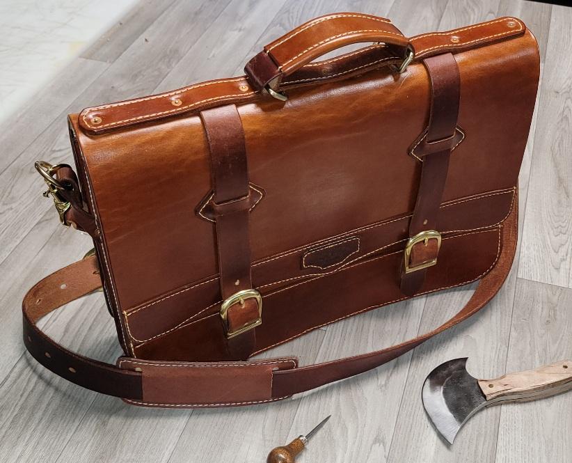

I have a large laptop with a 17" Screen so I decided to make a bag to fit it. The bag 17"X 11.5"X 4" I used 10oz vegtan for the front and back panels as well as the shoulder strap, 5oz for the center divider. I played around a bit with the shoulder strap attachment points and came up with a different design than what I've seen before.

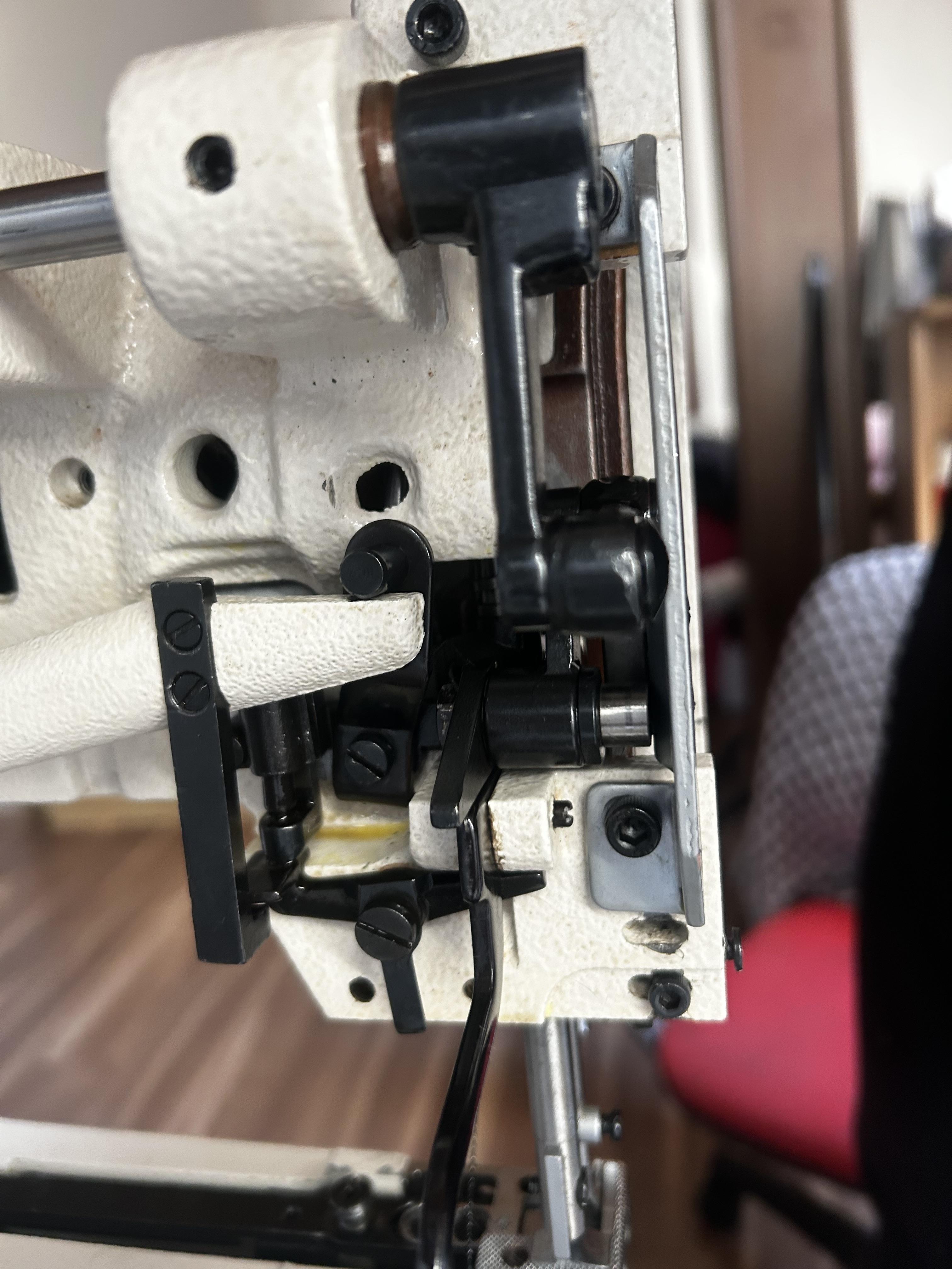

Hi Romana, What material are you sewing? Does the machine make good stitches? Presser Foot Pressure On my machines I typically reduce the force of the presser foot because it's uncomfortable to lift the presser foot otherwise. But I'm stitching lightweight materials predominantly. @Wizcrafts is often reminding us that the presser foot must not lift off the table when the thread take up lever tugs on the top thread to complete the stitch. In some cases (stitching on corrugated plastic signs when i do not want to crush the signs) I remove the main pressure spring altogether. But for thinner material I have to put the spring back in or the feet don't contact the cylinder bed well enough. Lubrication In the case of the Pfaff 545, I needed to add a healthy dose of grease to the plates on the back of the machine where the knee lift connects---otherwise it was noisy and hard to move the knee lift. Comfort Grips Also in the case of the Pfaff 545, the hand lever for lifting the presser feet is so tiny and awkward that I wrapped some foam around it and held it in place with duct tape. This made it somewhat more comfortable to lift by hand. (The knee lift was much better after greasing)

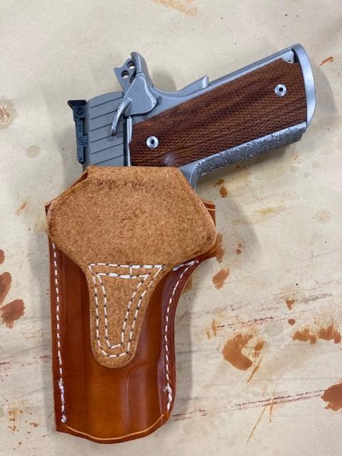

@larry1096 I see your loop design. it looks more maneuverable than mine. Its narrower at the fold so you can move the "ears" out of the way. Ill have to tweak my pattern to reflect that. Looks good
Hello, does anyone have instructions on how to adjust the back of the machine? It's a Pfaff 335 clone. It's hard to lift the presser foot.

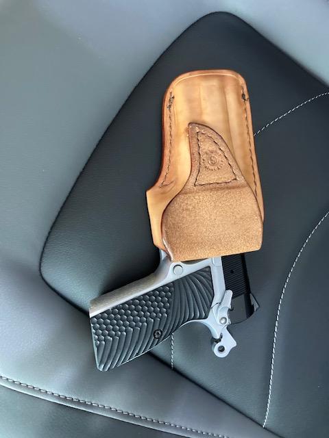

Yup, it looks comfortable but I havent tried it on yet. Shame on me haha. If I wasn't in arizona (where wearing long garments is much frowned upon) I'd consider it for daily carry. I still could, AZ is open carry too. But I dont much care for broadcasting like that. Just me I suppose
I've found you can make your life easier (i.e., get some breathing room around the stitching) by being sure to run the rear flap straight down the body of the holster; requires tweaking where it folds, of course, but it's doable. Larry
Nice work!! high and tight holster.
Thanks, it is interesting and fun to make
I like the design. It's the next step more coverage from a Yaqui Slide.
Yes, the hardest part is stitching near the belt loop. My presser foot is realy wide, I should have swapped it out for mt left toe foot. The loop causes the holster to not lay flat so get some deflection sometimes. Probably my inexperience with my outlaw machine. Definitely going to try again
