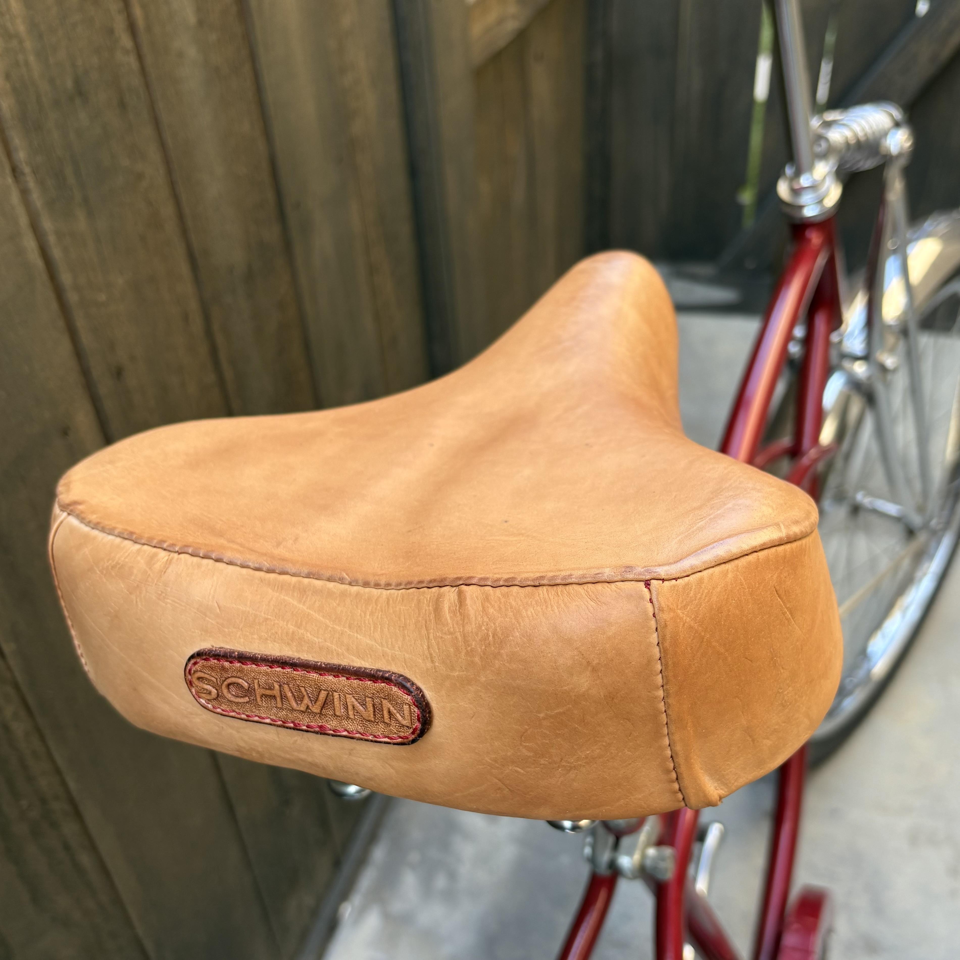

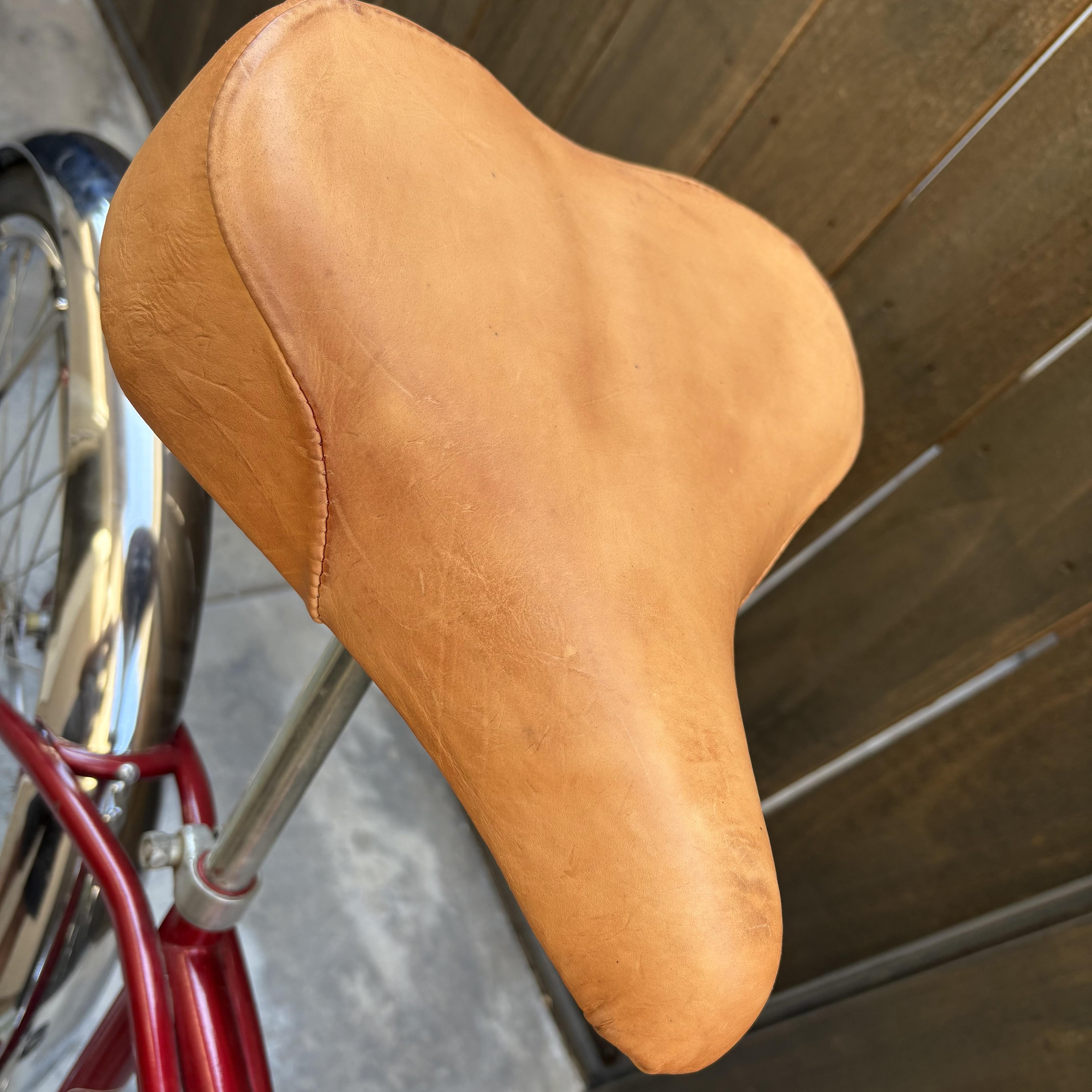

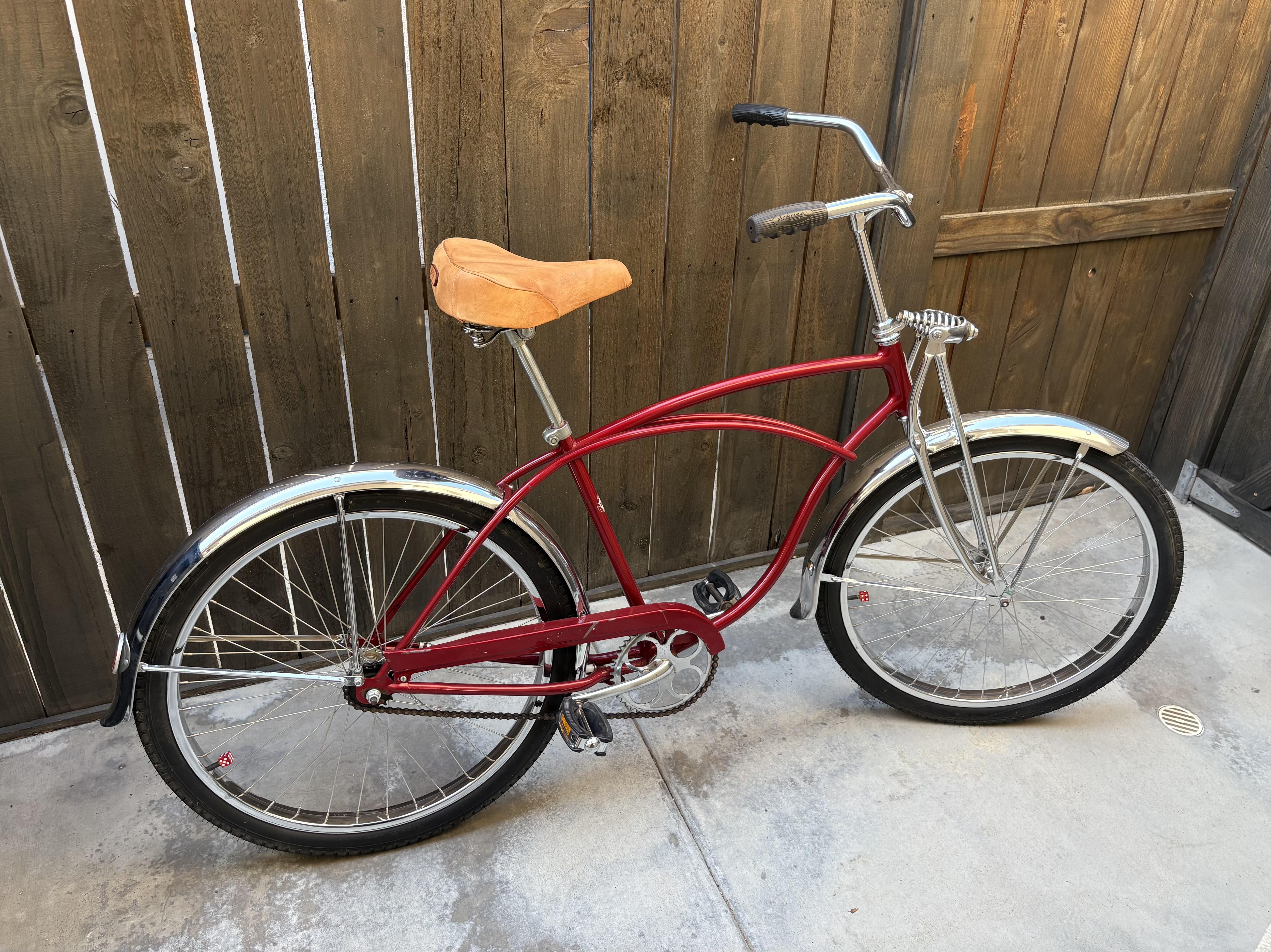

Third time’s a charm. I made a wooden form to mold the 2-3 oz. veg-tanned leather. It could have been done in two pieces but the first two tries left me with barely enough for the third and happy result. This seat is closed-cell foam on a metal pan so contact cement was used. No staples. Hopefully it will hold up to riding. Finish is neatsfoot oil. Next bike saddle project is a plastic pan that will take staples. It will use the same wooden form for preliminary molding.
