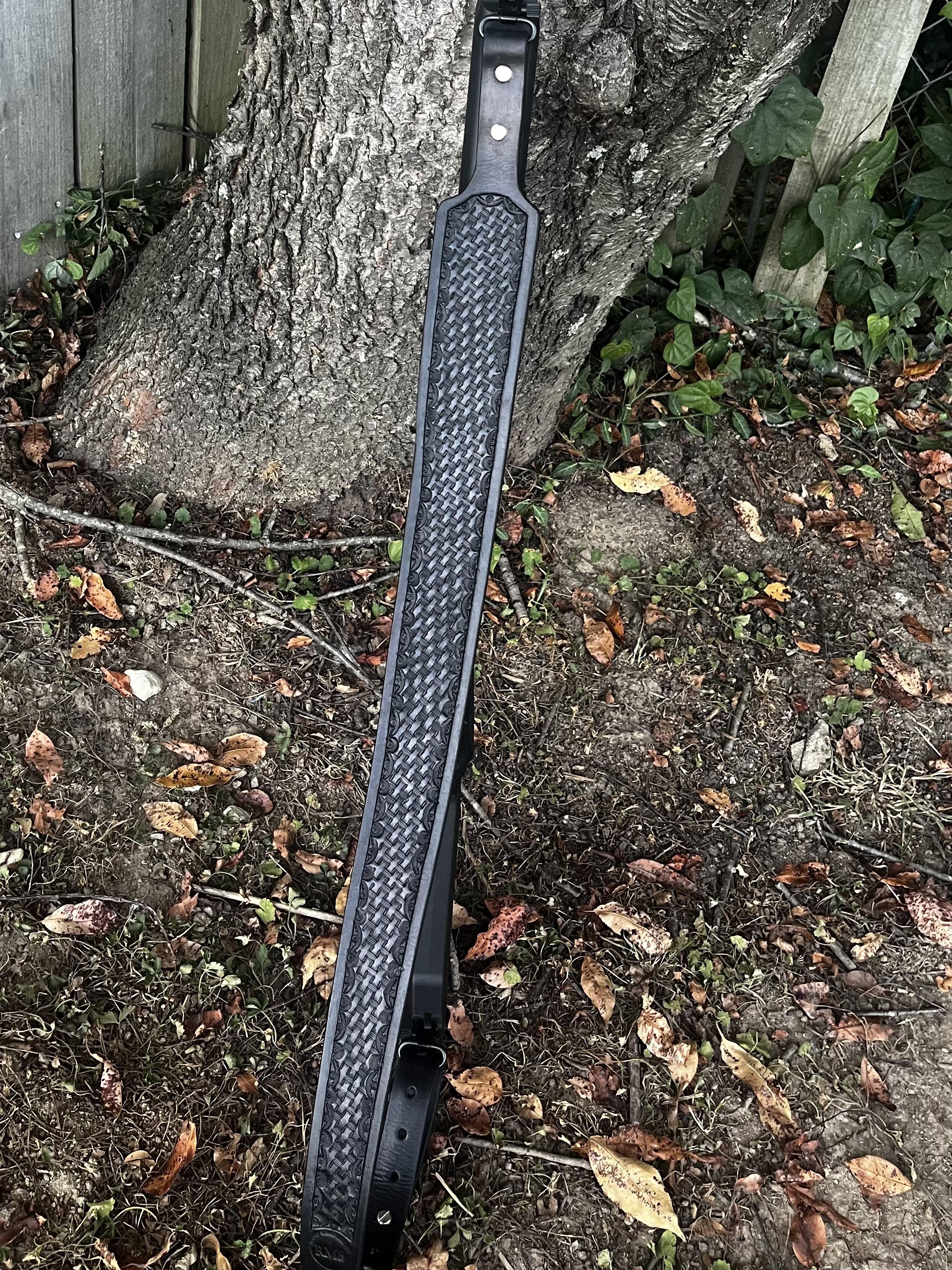

Started to get back into leatherwork after almost 10 years of on and off practice. I’ve made myself anything from holsters, belts, to knife sheaths. I still wear the first project I did 10 years ago around my waist (with a few new holes poked in it). A few of my rifles have been missing a sling for a while, So I decided that would be a good project to restart with. Not perfect, but certainly makes it easier to climb the Appalachian hills. ~9-12oz veg tan, some lined some not, no sewing machine, fiebings black dye, el cheapo amazon chicago screws, big box swivel attachments

This is really well done! I like how you tapered each piece symmetrically. The tooling is great! Leaves on one side and wood chips on the other. Great attention to detail.
Nice...I use actual shell casings that I cut down...
