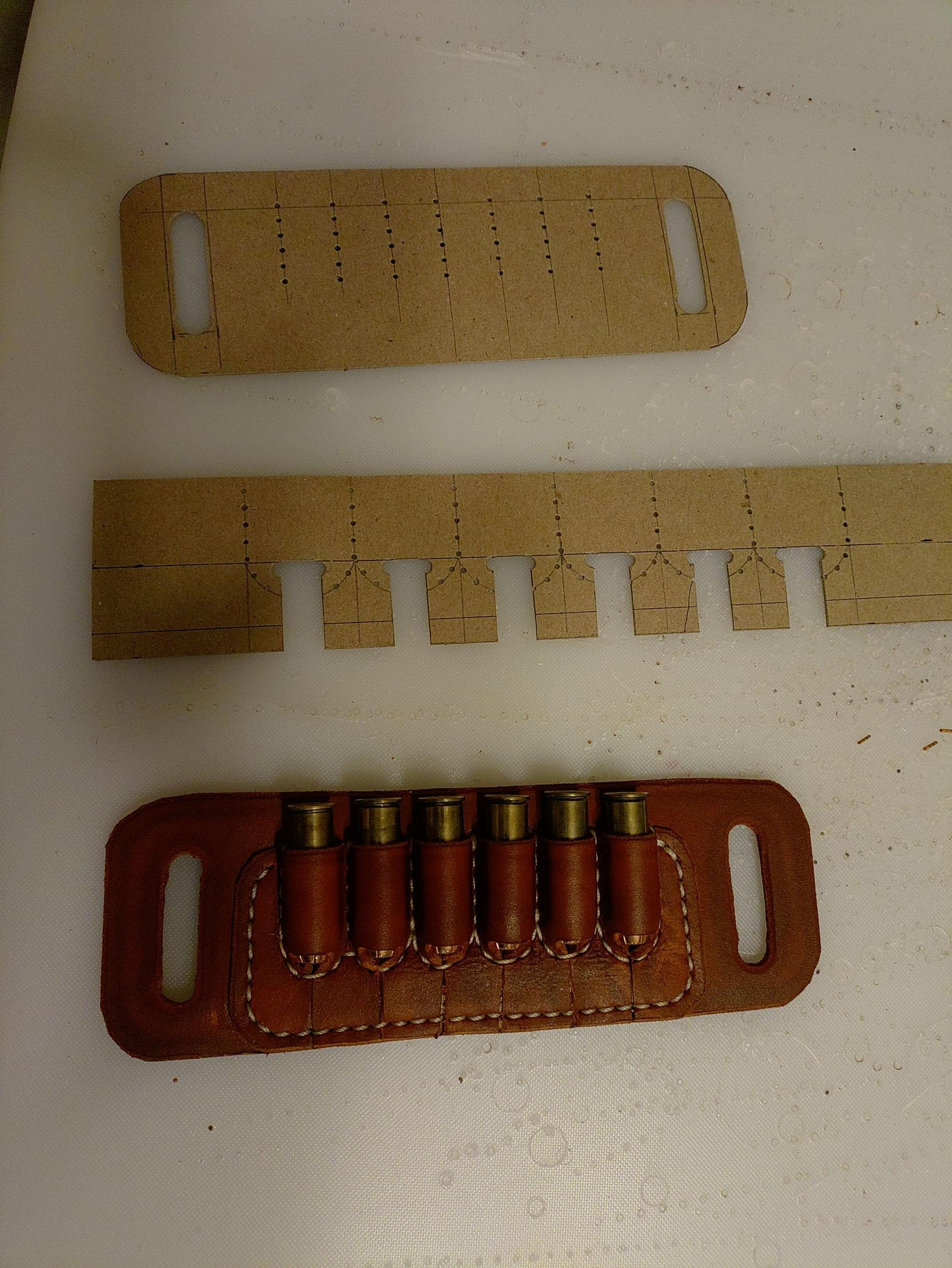

  16. So that is kind of what my question is. On this machine, the needle top of stoke happens 20-25 degrees before the take up arm reaches its top of stroke and that is when the bobbin thread releases. top photo marked 0 is needle top of stroke, bottom marked R is take up top of stroke.

  22. So I was waiting for leather to dry a little and thought I would fiddle with this. The removed material at the bottom needs to be the diameter of the cartridge (in this case .429" -44 mag) The oval punch should be close to that plus the thickness of the leather doubled (.429 + leather doubled) The stitching down the case wall needs to be measured with a couple strait edges holding the leather and bullet down to a flat surface. In my attempt, my punched hole is a little too long. The stitching holes I just eyeballed the radious going under the bullet. Knowing these measurements I think I could build a pattern. Then the stitching on the back piece I think would be like a normal piece except the radioused part under the bullet might need to be punched during assembly? On a bottle neck case, Ill probably have to work that out but I think the oval hole might need to be higher?

  27. I saw that too. With a round hole punched at the apex of the dart, everything fits together nicely, possibly without wet forming. But wet forming probably wouldn't hurt.
