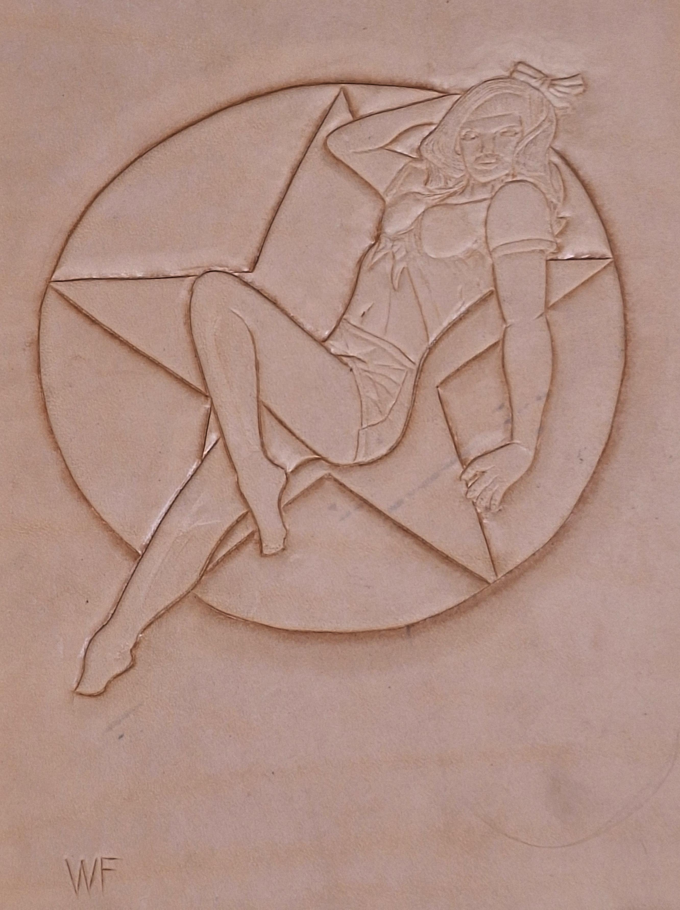

Looks great! Clean and to the point. Yes, the pressure of tooling causes the mirroring.

What causes the mirror of the tooled image on the inside of the flap? Is it the pressure during the tooling? The thickness of the leather? How much dye was used? How deep the cuts were made? Sorry, I haven't done any tooling yet.
