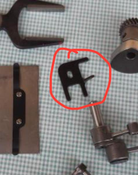

  2. Ich habe auch noch dieses rot eingekreiste Teil übrig, von dem ich nicht weiß, wofür es ist und wo ich es hinstellen soll.

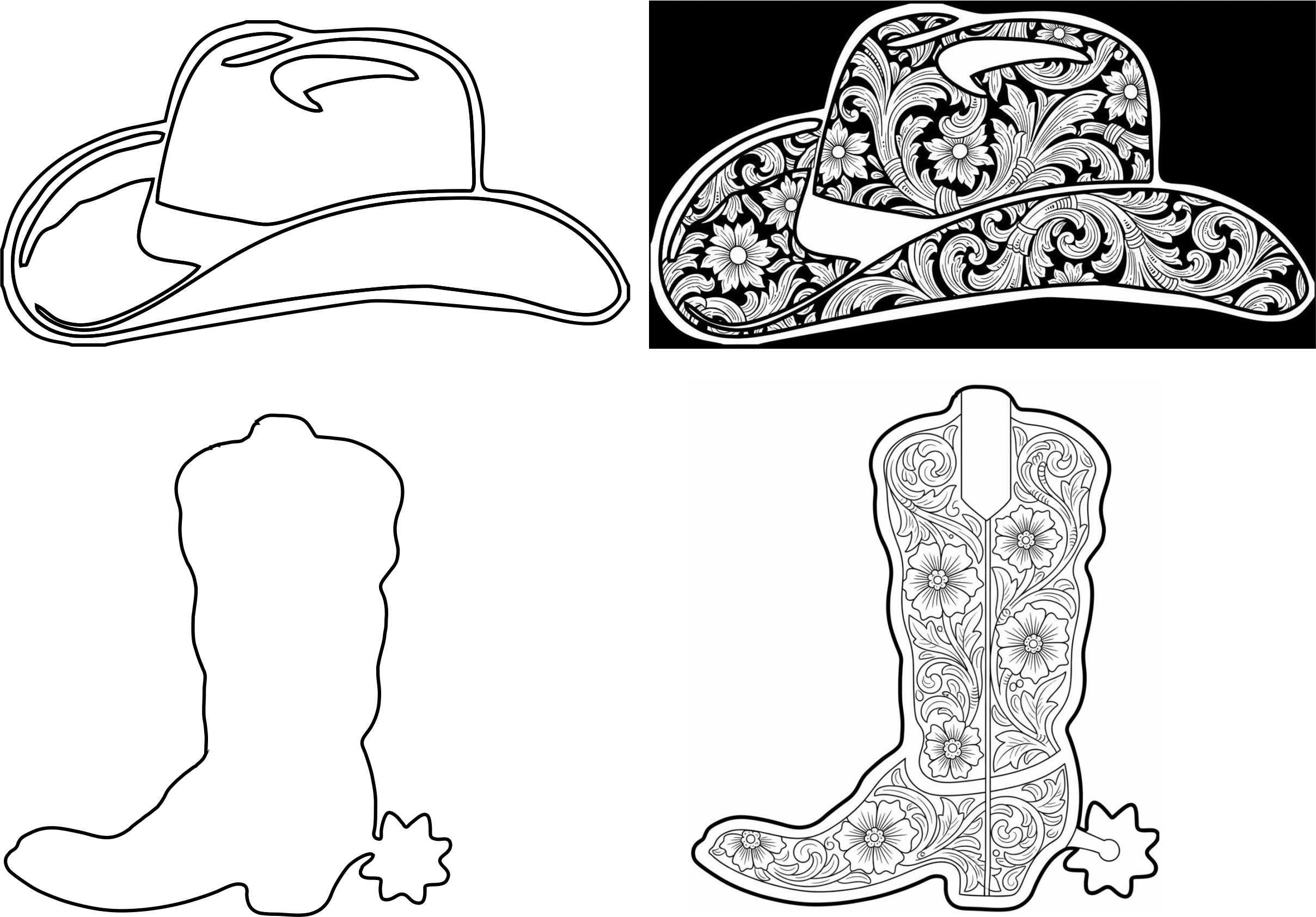

  7. I was just selected as a tester for EngraveFill Pro. I should go live in the next couple weeks, but WOW am I impressed. Cool thing is, you only pay what you generate. No $300 programs! check it out. I am in no way associated with them, just a tester, but they seem like nice folks. https://engravefill.app/?fbclid=IwY2xjawNzE-pleHRuA2FlbQIxMABicmlkETEwR1lxM3p0RmljTWE0a3VMAR64tK9fXckb7w-6E-TNOLTRVzfAAHNsNPu1eLJrSl3CKLo7wEgeLRGHwR3kKw_aem_1tv2YBQc8KI2ve2MMQ98lw&payment_id=pay_1VKVbNuCXXuqulKKitxEJ&status=succeeded#/ On Facebook https://www.facebook.com/groups/1359934906135899

  28. Ah! Evidently something to hold a seal while you're carving it. Thank you! Ey! Belli ki onu oyarken mührü tutacak bir şey. Teşekkür ederim!
