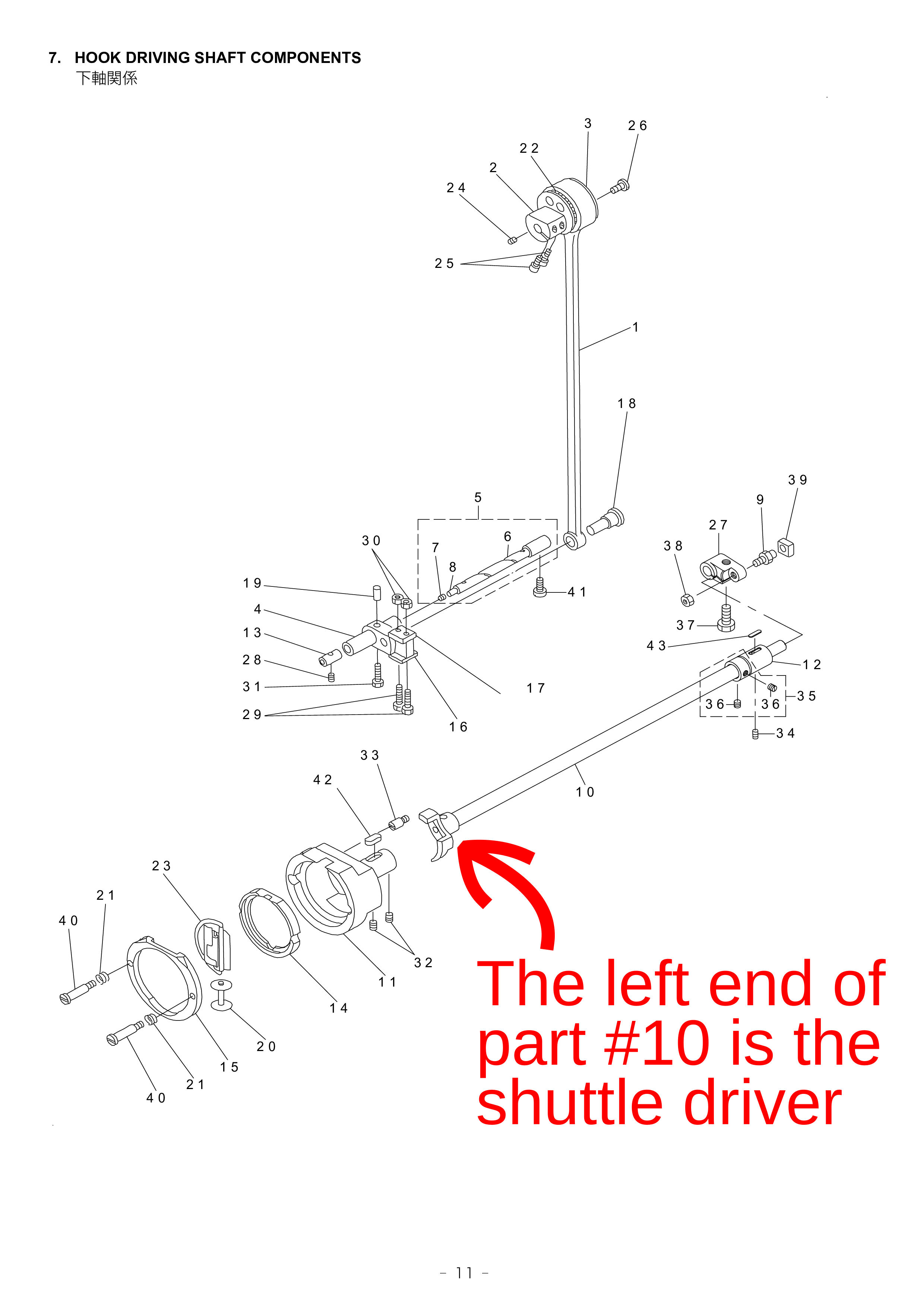

I haven't found many parts on a sewing machine that bend. That is, most parts on my sewing machines seem to be a very hard material that is likely to have fracture as its failure mechanism, not plastic deformation.
An internet search for juki 243 parts manual led to this: https://www.jukisewingmachines.co.uk/pub/media/productfileupload/j/u/juki_tnu243_parts_book.pdf On pages 11 and 12 shows the hook driving shaft (part #10), the left end of which is the shuttle driver.

I read through that section and wasn't sure, either. I'll bet Friquant or Constabulary will know. I saw the post that seems to show a little rotational movement for the feed dog. If I'm visualizing it right, it seems like moving the needle away from the hook would move it even closer to the feed dog hole. It'll be interesting to see the final outcome.

aaaah I´m toooo much "singerized" I guess... 🤪 its a bit different on the 243 as it seem but you can move the feed dog holder sideways.... but its a bit more difficult as it seems. Looks like you have to loosen the 2 screws #25 but an actual picture of the underside of your machine may give us a better idea....
You can move the feed dog holder a bit sideways.The feed dog holder is attached to the feeding rod with 2 pointed screws (one on either side). When I look at this picture I think the feed dog seems to be misaligned. What I would do first is loosen the 2 feed dog screws and try to align the feed dog. Then I would try to move the feed dog holder to the left. It should be the same as on Singer or 45K or Adler 104 flat bed machines. I´ll take pictures tomorrow...
