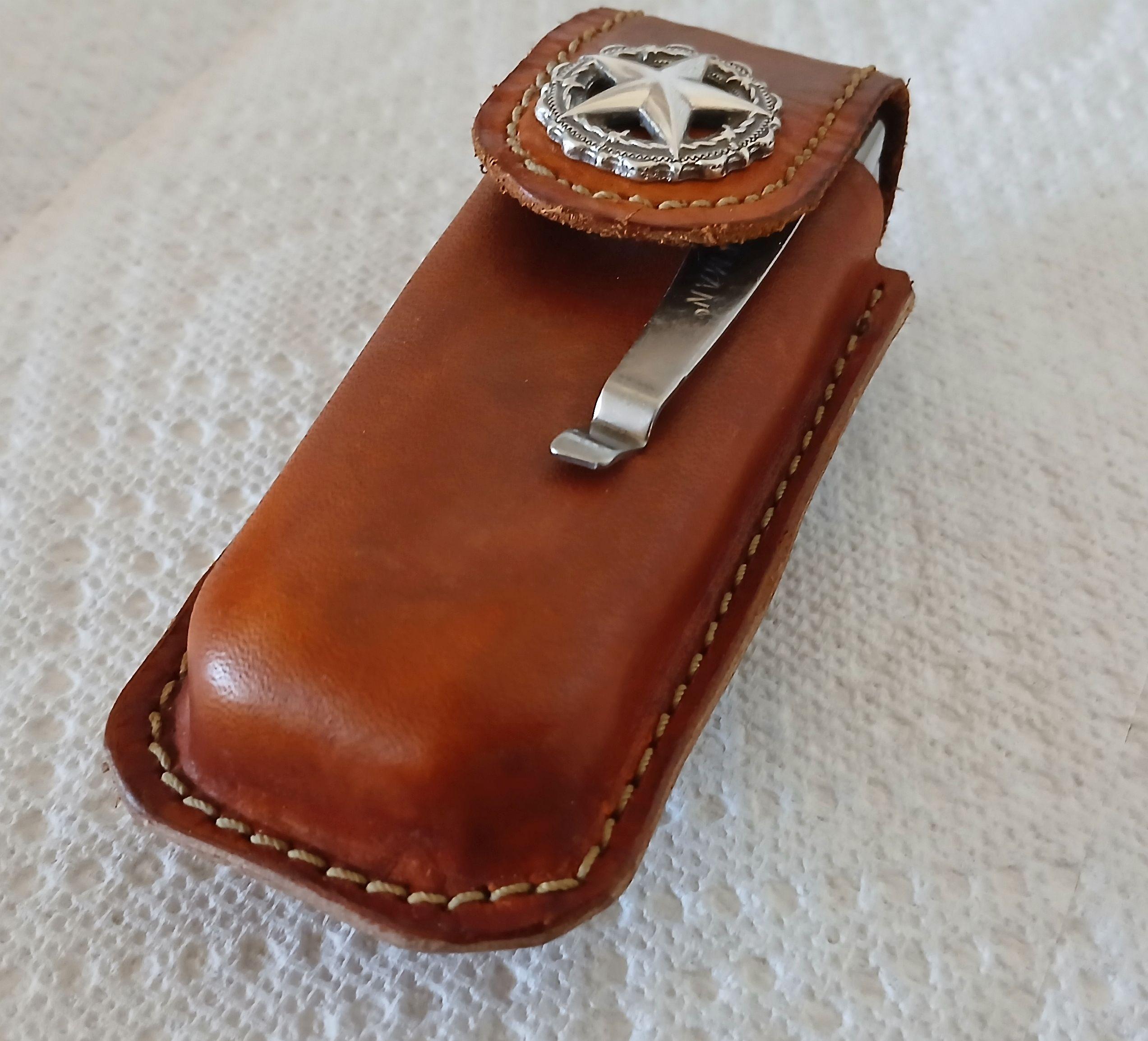

So I purchased the zipper feet and made a quick case as a test. Forgive the edges and finish, as I considered it a quick experiment. In the end I really appreciate the input and suggestions and am quite pleased with the result. For an old guy with arthritis this will be a game changer!
