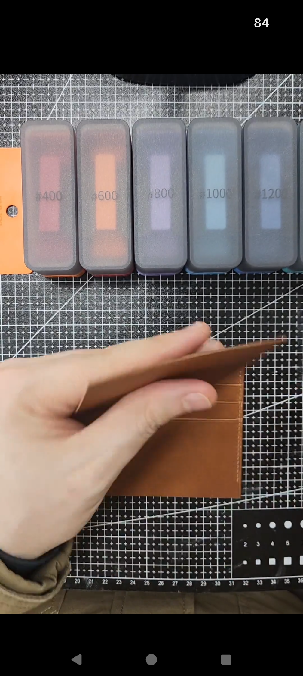

I've been seeing a LOT of these "minimalist" wallets. Screenshot added for reference. Not my style, I'd probably never build one, but how in the hell do they make them so thin? I'm obviously doing something wrong because my wallets are fat. Well, comfortably plump. This is 4 layers in the pic, and it looks like barely 1/8" thick. I understand it's pretty thin leather, but is there a certain way to cut the pockets? On the edge of the stack, it only appears to be 1 or 2 layers thick. I'm listening.... Learn me something. Lol

Looks great. I wish I could get my carving to look that good. I use glazed pigskin for my wallet lining and pockets. Seems to be about the thinnest material that will still hold up.
