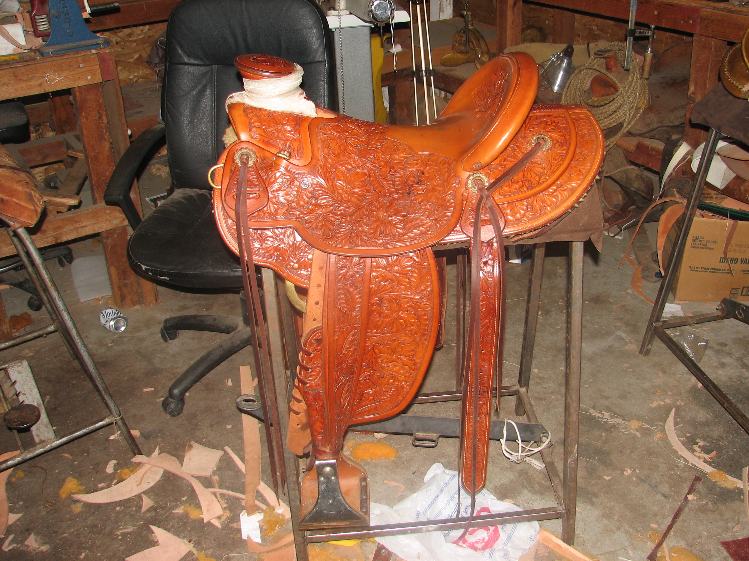

  2. Built this saddle in 2006 to go to the Elko show,Rode it a little this spring and roped some calves out of it .Fits a horse good.15 1/2" seat ,5 x 12" cantle,90 degree bars,5 x 3" high wood post horn,silver conchos,6" monal stirups,Skirt rigged.$3950
