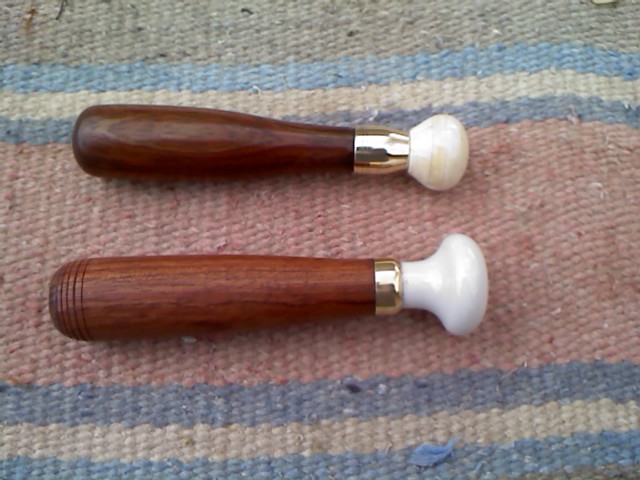

Tim, Here are a couple that I have made in the last couple of days., The larger flatter one is a porcelain cabinet knob and the other rounder one is an ivory knob that i found. I have several of them since i found out they are real ivory I am slowly buying them all up at the resell store(a store that resells items from a house that has been renevated or torn down and the parts salvaged.). They do not know they are ivory and i have not told them yet or the price will go up 10 fold. I turn the handles out of bubinga and use a brass compression fitting and turn it on my lather after I have turned the hande enough to place it on and keep it in place by drilling it and then screwing the knob into the handle with a little super glue to keep it in place . then I finish turning the handle. I think they come out nice and I have you to thank. Had you not put your pics up I would not have went to the resell store looking for door knobs. so Thanks alot for the insperation. I have a couple of people that are wanting some so I guess I will make some and see if i can sell them. Gary
I just finished my latest custom leather tool. It is a mini ball slicker that is made of Ivory. I scored at the restore(a store that takes donations of old homes and parts from the old homes) odf some porcelain knobs. there was several knobs that looked different and I took them to a friend that knows Ivory. (I thought it might be Ivory). When i got home I had to one up into a ball slicker. (never heard of one either till I coined the phrase). It is great to slick down the cove in some of my frames. let me know what you think of it. the end is pre ban ivory.and the handle is made of bubinga. the ferrule is made of soild brass. the other is a small mini bouncer that I made yesterday. it also has a handle made of bubinga and a solid brass ferrule Hope you like them. Contact me about the bouncers. As for the mini ball slicker I only have a few pieces so I am making them for my own personel collection.

I have just finished a mini ball slicker. It is made out of ivory. I was at the restore(like a thrift shop but for building supplies from remodled and toern down home) and I came across some cabinet handles that I thought was porcelain but when I looked closer I saw that they were different. I compared them to some Ivory that a friend has and found out it was ivory. I decided to make mini ball slickers. never heard of a ball slicker till I made one. and It does work nice. One is of Ivory and the other is of porcelain. They both have solid brass ferrule and both have bubinga handles that I turned on my lathe. hope you like them.© © leatherworker.net

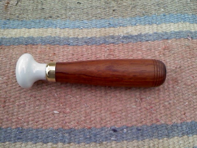

I made a mini bouncer out of a 1 1/4" porcelain cabinet knob. The hadnle is made of bubinga wood and it has a solid brass ferrule. I attached the knob and ferrule to a bubinga wood blank and then turned the blank . Let me know what you think. Gary© © leatherworker.net

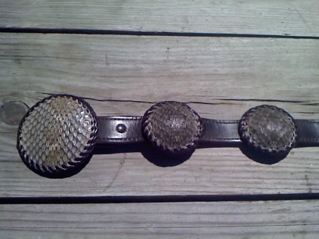

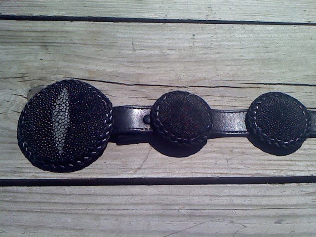

Here is my latest projects . I made two conchos belts for practice. this is what i came up with. The conchos of both belts are made of 2" nickle rounds that I made concave by using my pepe steel concho die. once concave I soldered a 1" concho strap on the back of it. I used 1 1/2 oz leather on the back and then covered the concho with the snake and stingray. I laced the snake one's with a dark brown calf lace and the sting ray with a black calfs lace. The buckles were a little harder since I do not have a concho die that large. for that I used 16 gauge brass cut 3 1/2" for the snake and 4" for the stingray. I used the end of a log and with a template made a round mark in the log. with a ball peen hammer I made a concave area and placed the brass pieces in the log and with a poly concho hammer(rounded on both sides) and made the buckles concave. I soldered a belt strap and a hook on both buckles and finished like the conchos. I made the belt for both. the belt is about 18" to long just in case the person that buy's them is of a large frame or unless they are like me Fat.lol.

Black stingray concho bely. I made the conchos with 8 nickle rounds 2 1/2" in diameter. i concaved them and soldered concho straps on back . then i used a 1 1/2 oz leather for the back. I used a blcak calf lace for the double loop lace on the sides. the buckle is 4' in diameter and was made from 16 gauge brass that I concaved and the soldered a belt strap and a hook on the back and used the same technique as the conchos to finish. I made the belt to go with it.© © leatherworker.net

Western Diamond back rattlesnake concho belt. I made the conchos out of 2 1/2" nickle rounds and soldered concho straps on back. the 3 1/2 buckle was made out of 16 gauge brass and concaved and a belt strap and hook soldered on the back. Has a 2 1/2 oz leather back and calf lace done in a double loop style.© © leatherworker.net
