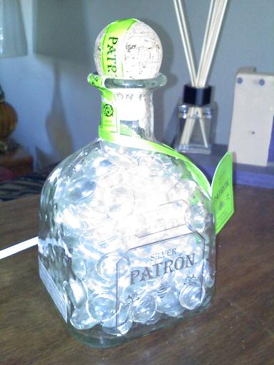

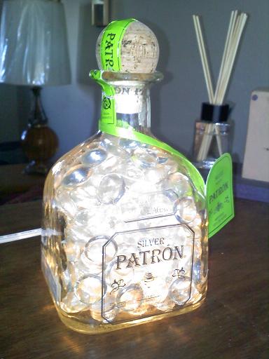

  4. My wife loves tequlia ,so do I .It make me look better to her lol. I saw that TKleather had done some pendelton bottles and decided to do a couple of tequlia bottles. I used my 1" glass hole drill and put in a small lamp like the christmas tree bulb . I put some clear glass beads in it and lite it up. and I think it came out real nice. I still need to make a bottom for it and decide if I want to make them with shades which means I have to drill two holes. I think I might leave them like this.I have all three size bottles made. I just have to get more of the cord and light sockets. Let me know what you think.One picture is with it turned on and the other is turned off. Gary
