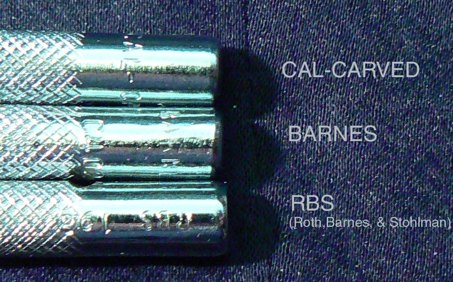

Ah, the old Ellis Barnes iron ! ELBO ? Haven't run across any of those yet. Or the Chatsworth. I do have a couple of stamping tools that Ellis did put the name "BARNES" on though. At least in the early years, Ellis did seem to use the same tool configuration whether he was making tools for Cal-Carved, RBS, or with his name on them. As can be seen in the attached photo, they all were a bit shorter than Craftools, and the knurling was carried closer to the end of the shaft. This was allright for the Cal-Carved and his name since the name went around the shaft, rather than along it. You can see where the number carried into the knurling on some of the RBS tools. Do the names of the ELBOs and Chatsworths run along the shaft or around it? Could you post some pics of the tools ?
