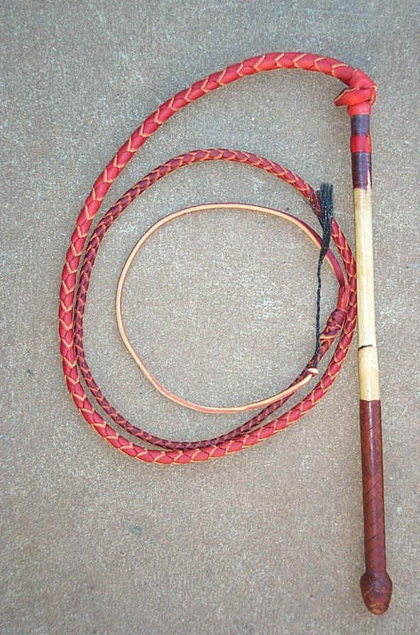

http://www.leffler.com.au/saddlery/red_greasy.htm http://www.murphywhips.com/images/PRE14-05-1.jpg redhide is alum tanned and has a greasy feel to it. It is similar to latigo
