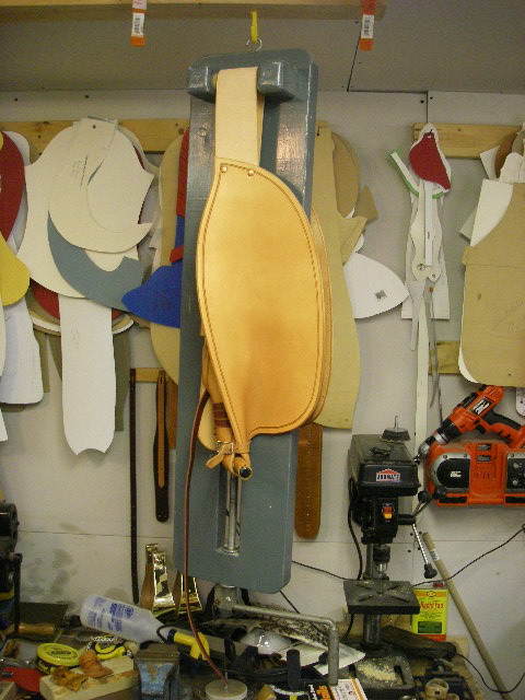

I have been using a wooden drawdown stand that I have modified and rebuilt a couple of times over the years, I guess you could say it is an old stand since it was my grandfathers, not sure, but it could have been used by my great grandfather also, I do use his stitching horse though. Anyways back on topic, I am finally getting up with the times, I just got a barber chair yesterday, has anyone made their own stand from a barber chair, if so I sure would appreciate some photos of what you did. I have seen some barber chair stands over the years but I don't recall how they should be made. So if anyone could help with my quest and give the pros and cons they have seen on homemade stands that would be great.
