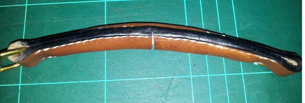

Hi, I am in the process of making a briefcase and need to make a handle. I have found a type that I would like to make but I’m not quite sure how to construct it. This is the type of handle I would like to make: What I can’t figure out is how to make it seamlessly end. Before I found good pictures of the handle I made this handle just to see if it worked at all. As you can see there is a rather large gap where the two ends meet. My handle is made with a single layer whereas the other handle is made with two layers. I cant see if it is one long piece of leather that is wrapped around two times or it is two pieces wrapped around one time each. Even with this figured out I'm still not completely sure how to make a seamless joint. You could off course skive the ends so that they overlap each other and the make sure that this joint is not in the middle of the handle but off to the end. If you look at this handle it looks as if it is two pieces of leather. The inner is thick and the outer is thin making it easier to skive the ending to be almost seamless. Have any of you tried to make a similar handle our do you have an idea how to do it? The pictures I found on this page: http://bentleyslondon.com/shop/vintage-luggage/
Read my reply in this thread. It should answer your questions. http://leatherworker.net/forum/index.php?showtopic=49470
