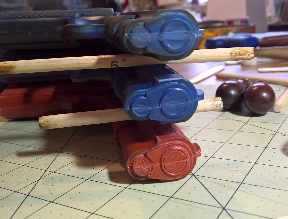

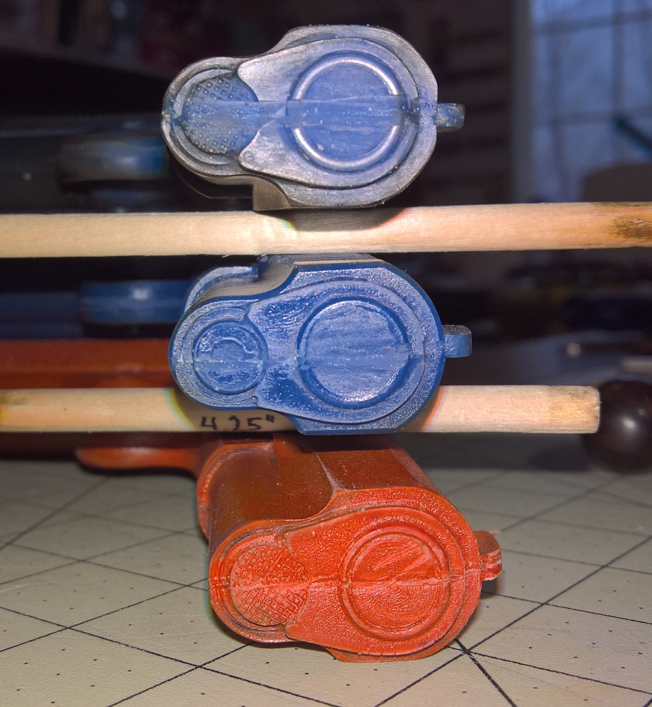

Another Blue Gun Question 1911
BHPshooter replied to Boriqua's topic in Gun Holsters, Rifle Slings and Knife Sheathes
Here are some pics that might help. The molds shown are (from top to bottom): Colt Commander blue gun Springfield 1911 blue gun 5" 1911 ASP red gun For what it's worth (in case it isn't evident from the pictures) the shape of the slide is virtually identical on all three molds. -
