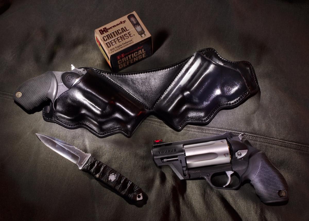

Hey all, thought i would share one i finished up a few weeks ago... the customer wanted a double rig for a taurus raging judge...he also has shoulder obility issues so the cant had to be extreme..after six patterns and one pattern holster we finally agreed on this...the customer sent me a pic of the rig all dressed up...this was quite a challenge but really fun and the customer loves it...
