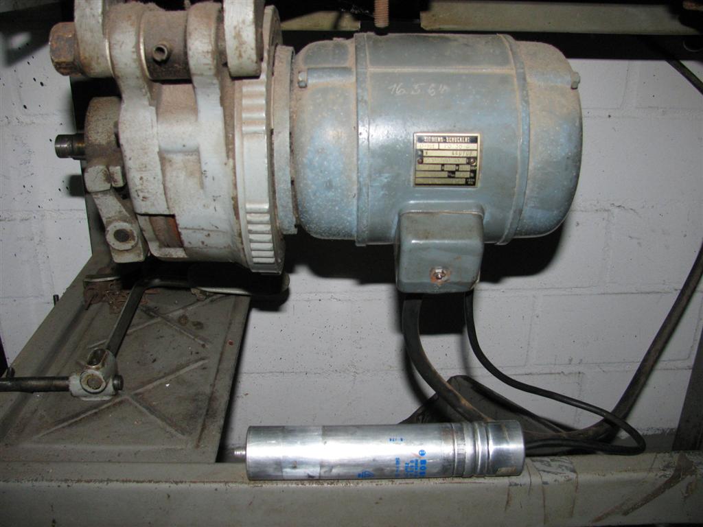

Wiring A Clutch Motor To In Reverse
Constabulary replied to Happy Hooligan's topic in Leather Sewing Machines

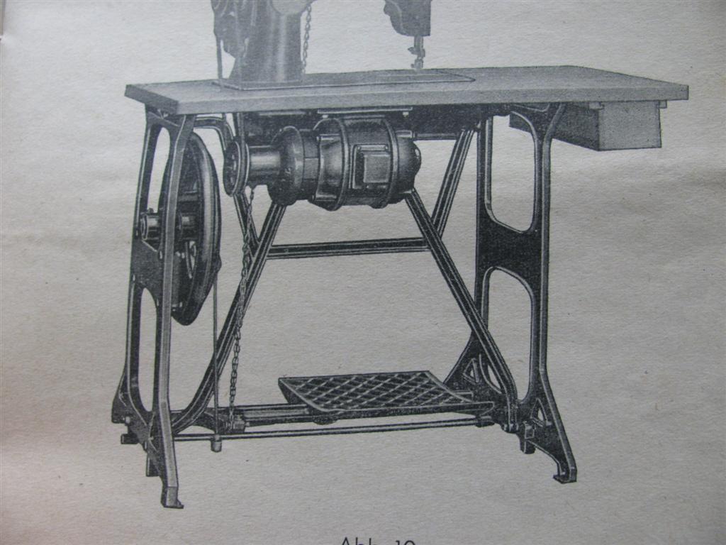

This is how it works on the above mentioned clutch motor when run on 220V single phase with delta connection and capacitor - not sure if it looks the same on yours. otherwise this Video should give you an idea: -
As far as I remember on an AC motor you have to switch the 2 wires of the starting coil. Don´t know how your motor is wired and if it has a capacitor nor not but when I work on our German Pfaff, WEG, or Kobold brand clutch motors (all set up with capacitors for 220V singe phase) you just have to switch one cable in the junction box. But don´t ask me how this works on your certain motor, I´m not an electrician. -
