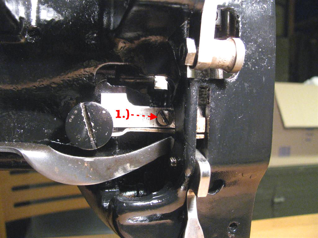

  16. Most likely it is just the needle bar that has to be adjusted a tiny bit. Thats not a big issue. An other member had such an issue recently. http://leatherworker.net/forum/index.php?showtopic=56107 Yours could probably be the same problem. The screw should be the same as at the Singer 111. The screw is a bit hidden behind the frame but it is there just turn the hand wheel until you can see the screw head in the gap - see picture. Loosen it and adjust the needle bar the way that the hook meet the needle withing the scarf about 1.6mm above the eye. Most likely this solves the problem.
