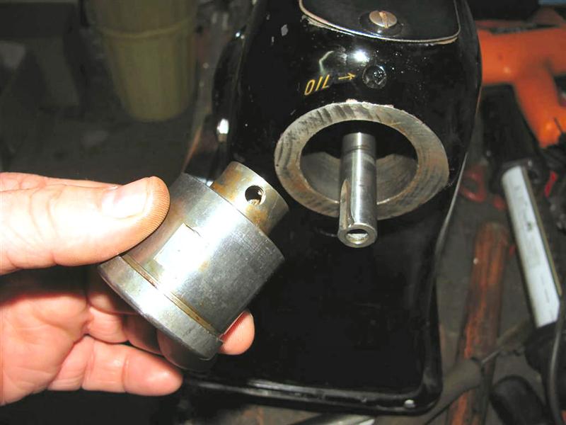

  11. Yes that is the bushing. It may sit very tight in there. Only tap on the outside and not on the part that was secured on the upper shaft. I have attached a picture from my restoration

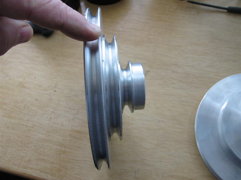

  12. A servo motor + speed reducer is for sure the better idea - much more torque than just a treadle!!! Sure, you just need some bolts and tools + 1 or 2 new V-belts. Depends on where you install the reducer + motor.
